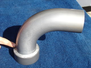

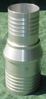

Here is a GG 2.5" Reducer:

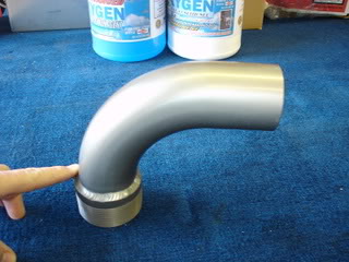

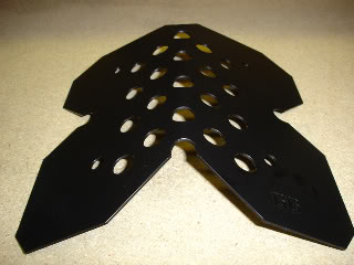

And a few other Butler parts to help with airflow:

Your looking for something like this right?
I haven't seen one made for 2.5" to 2"
Here is what most are using since most people use cool cuffs
Reducer
Then put a Male On that
The you can hook up your 2" hose like normal (running female to male)

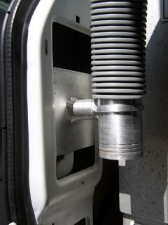

One final note for Dale, you don't actually "need" any cuffs, the machined reducer I posted above can be inserted directly into the raw vacuum hose, this applies to both hose diameters, it would be a semi-permanent connection and very secure, it would also be very compact and hardly even visible.

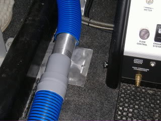

I was at Greenglides shop last week, and I assure you....THEY have reducers, connectors.....anything you need for a 2.5 hose. I was like a kid in a candy store I could have filled a shopping cart!! Tonight, I had a setup on the second floor, and left the 2.5 to 2" reducer in the van. I simply slipped the 2" cuff into the 2.5 cuff, and it sealed right up. It was a temp connect until I ran to the van and got the right reducer, but it worked.

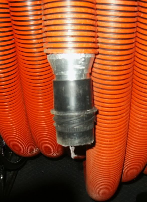

A simple reducer for 2.5 to 2, as per Greenie's instructions.
take Greenies aluminum reducer and jam it into the 2.5 hose
take the 2" coolcuff adaptor and jam it onto the reducer
It ain't coming off!!
Oh, when I say jam, I mean hammer! It took a fair bit of effort to fit it together. But it works great.
Art Kelley
May 19, 2007
4,200
Clawson,mi
Or you can soak the hose end in a bowl of boiling water for a couple of minutes and simply slide the reducer into the plastic hose with little effort. Like the way we would put hose connectors into cuffs when it's 3 degrees outside. Praise Allah for coolcuffs.
