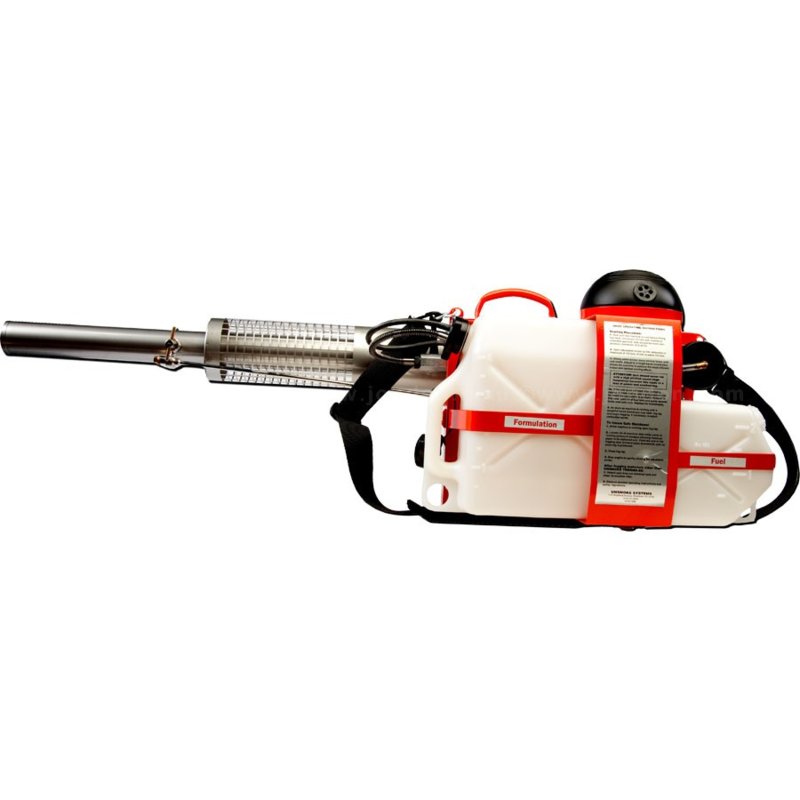

Had several of the Dynafoggers, the last units we owned were the Unsmoke VF models. They were more dependable as far as starting.

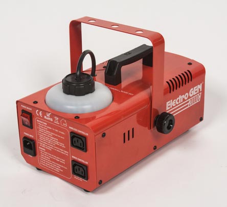

These seem more controllable...easier to use. Easy to clean up. Should be available at all the Carpet Cleaning Supply Businesses.

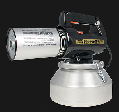

View attachment 19167 These seem more controllable...easier to use. Easy to clean up. Should be available at all the Carpet Cleaning Supply Businesses.
I never had good luck with this type. I had a couple nearly catch fire. Nothing like fogging a fire and nearly starting one. :icon_neutral:
The big ones can shoot a flame too if you shut them down without letting all the solution clear through the system.
Never actually caused a fire but we learned to always have an extinguisher handy. :biggrin:

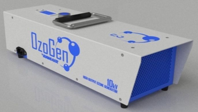

The solvent compounds are used for serious smoke damage. Richard knows more about them that I do. Ozone works wonders in that situation. I have some old apartments where we have a lot of seniors that have smoked for 25 years or more in the same suite. Before we ozonate, that place has to be cleaned, top to bottom, carpets and drapes cleaned and then we leave the ozonator overnight. Yes, the solvents can leave an oily substance.

We have mainly used ozone in the last 10-15 years. It still needs to be aired out and you have concerns with control of the gas. You don't want it going into adjacent apartments or condos.
We use theses, we have a dozen of the 2000's and we have a few of their larger wheeled models as well.
http://ozonegeneratordirect.com/rainbowair-activator-2000-series-ii.html
It doesn't have to be this model though, we have owned Sonozaire, we have a couple of the US Products on maintence models and one of the CTI units.
They are all simple units, you just want to look at output, easy of cleaning and longevity.
