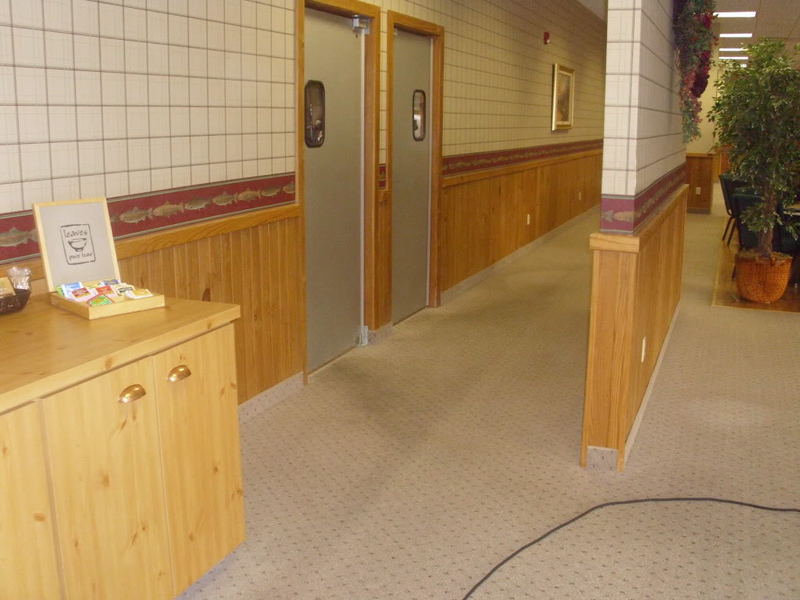

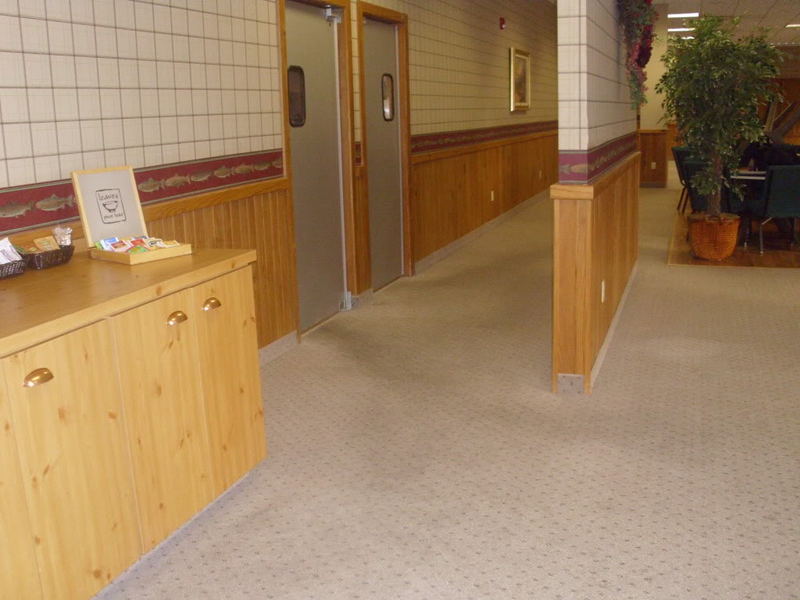

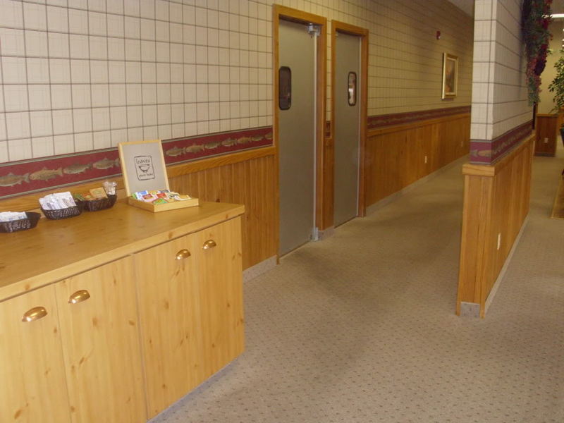

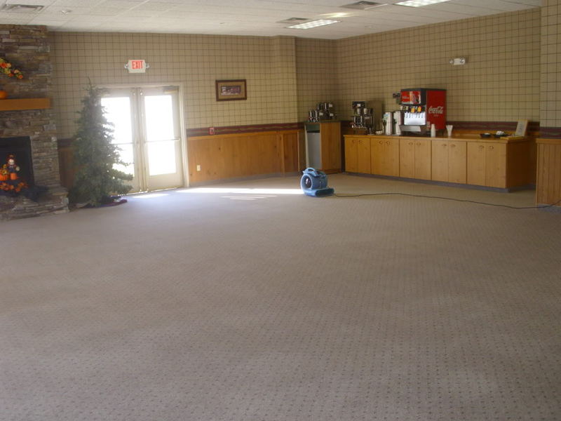

Here are few pics of a job I did a week or 2 ago... Its a conference center with olephin CGD and this is right outside their busy kitchen. This area is alway hammered. See for yourself...
Here's another area in the same 5000 sq ft dining room:
This was all done at 2 oz per gallon. It looked even better once it weas dry...
