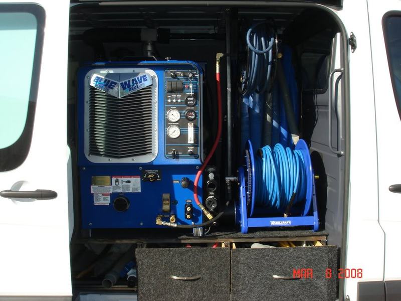

I have a customer with two sprinters with Blueline Bluewaves running gasoline.
He bought aluminum fuel cells from Summit Racing and installed a vented filler neck run to the outside wall of the van. He doesn't have a filler door just a cap. Looks a little funny but it's DOT approved since it's vented to the outside.

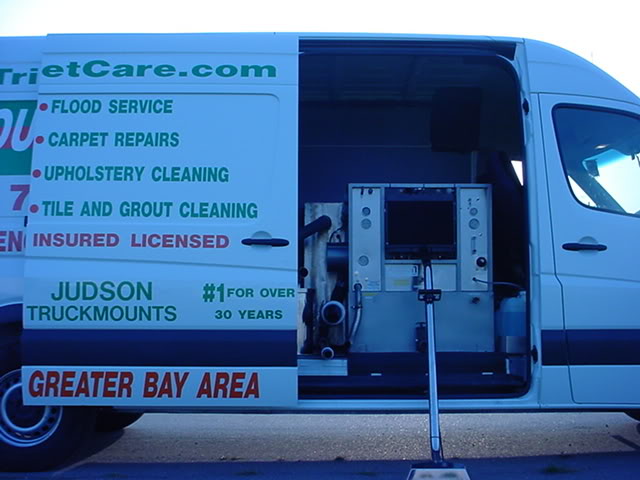

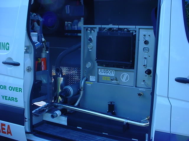

The 04, has has a Genesis 59SS in it from new, before they brought out the diesel. Awesome machine and mid mounted does not compromise the handling/safety aspect of the vehicle.
I removed the spare tyre and it's carriage from under the rear and had a fuel tank manufacturer custom make a unit for me. It has it's own guage in the front cab too.
The spare tyre thing doesn't worry me as most of it's work area is within 20-30 minutes of our shop, if we go further, we just put it in the back on the van for the trip.
