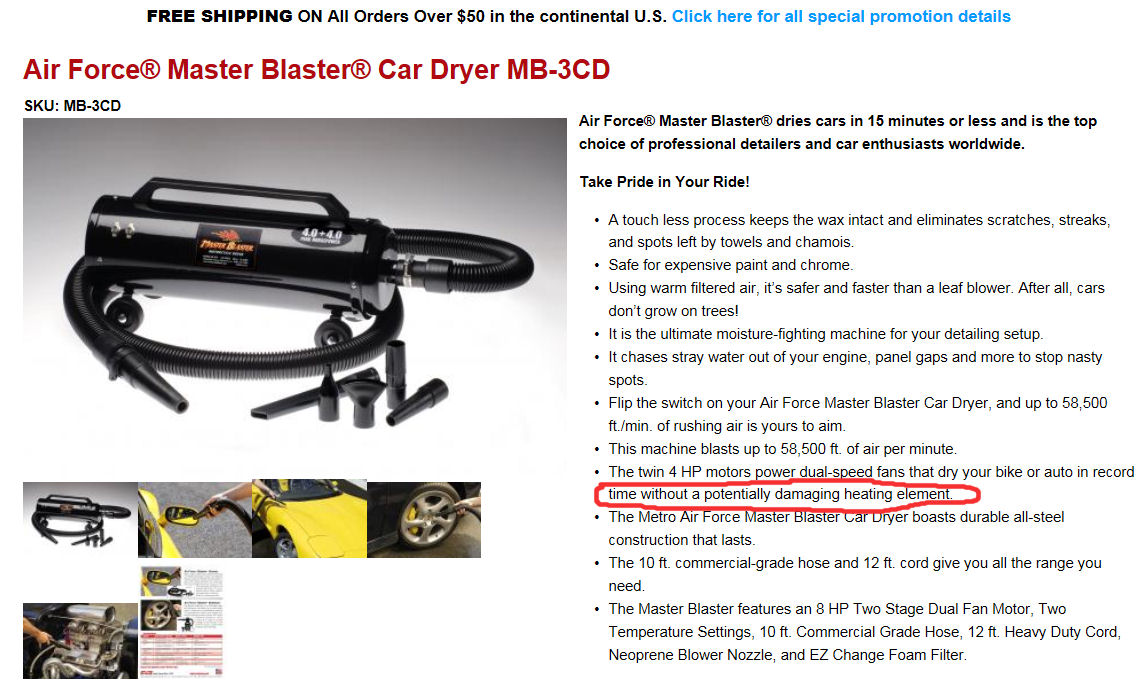

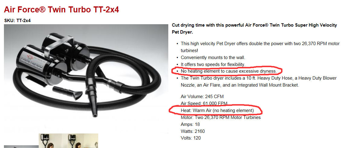

That makes sense. But I don't think the dog dryer has heat - just warm air from the fans:

6,982
San Francisco, CA.
Reactions: Mark Saiger

That one doesn't have a heater either - the two "temperatures" are just whether you have one or two fans running:
