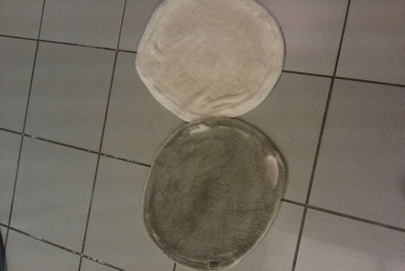

Most of the job was just spray and suck, a good portion was suck and post pad with some encap, and this part got scrubbed, RX, dry strokes, and post encap buff. Some dirty carpet and no amount of rinsing is getting this stuff out.
0]http://www.youtube.com/watch?v=Pm3Gnx3NJYs0]
I used two pads both sides and they both looked like this. Just think how much dirt is being left behind with your best effort put forward. I just can't fathom anyone strictly running a cimex etc on this carpet.

your cleaning looks great...your over laps were perfect.....
I'm just lost on why that bottom pad was so dirty...
I have cleaned worse then that and post padded...and mine all came out like the top one...
have you tried..going with out glides on a CGD..??

Yes I prefer without but I just like them on this carpet. I did a few other areas without and even went back over with the wand.
The carpet is NEVER vacuumed. I think it just this particular carpet. I have done it several ways and there is just a ton of dirt ground in with grease and oil.
I have scrubbed and did a real slow pass with the wand. The carpet is just nasty and all I can do is improve it.
The weird part is they really don't want the carpet clean. They just want the spots out. Even though the floor is clean if a spot comes back they feel it's not clean.
