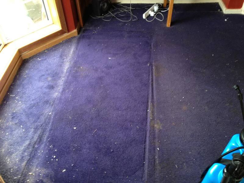

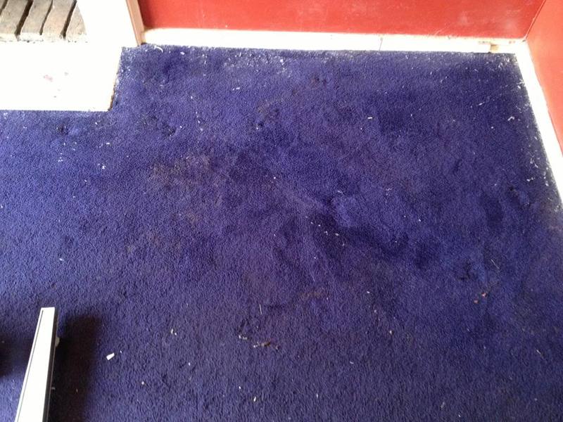

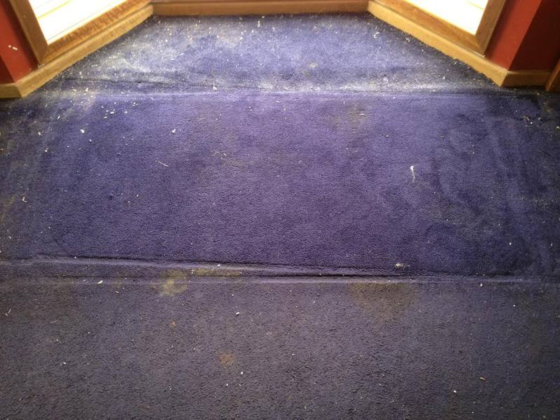

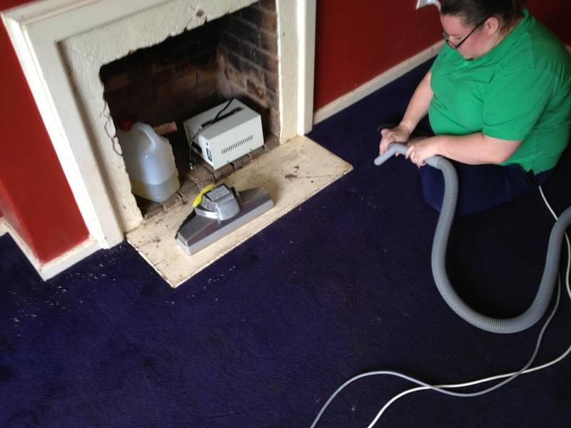

"Carly, this carpet is full of sand and dry soil, it will only clean up if we can remove it. Most of this job is vacuuming, let's not touch it with any water until we have removed all we feasibly can".
And so we vacuumed for 90 minutes and she changed the bag twice. Each time the bag is heaving with shit....... This image gives you an idea of the carpets appearance change with - JUST VACUUMING - we've completed the main floor area and are now chasing the heavy embedded soil out of the edges with a nylon brush and the Kirby in hose canister mode. No water has yet touched the carpet.

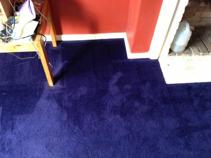

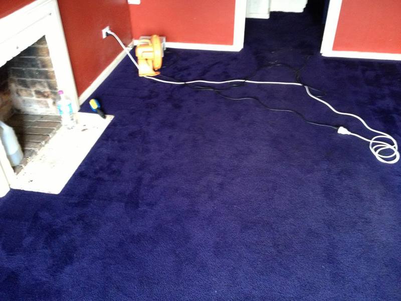

And it turned into this......
And here's my kid looking smug as shit becuas mum and dad have just pulled this living room out of their arse. I will - NEVER - forget what she said to me.
"Dad you smashed that out of the park I really think you're ace at this dad".
Cholked........
Customer came back his girlfriend comes in and she literally starts crying...... Was the oddest experience ever.....
So what is my point......?
i had zero resources and managed to turn this thing into great looking carpet. It took me 4.5 hours and accordingly just. Small room and a hallway cost my customer $450 which he paid in cash with a bonus on the spot. I'd respectfully - cautiously - and with my limited knowledge and experience declared in advance - venture the following based on my experience.
