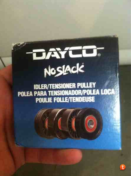

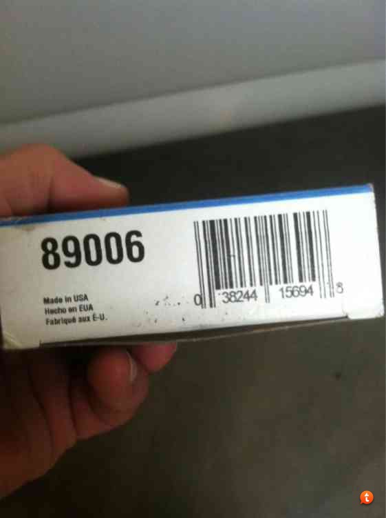

This is the one's I use for Idler's since the back of the belt runs on em. Go to Advance or one of the Box Chains, probably get what you need.
Maybe???
