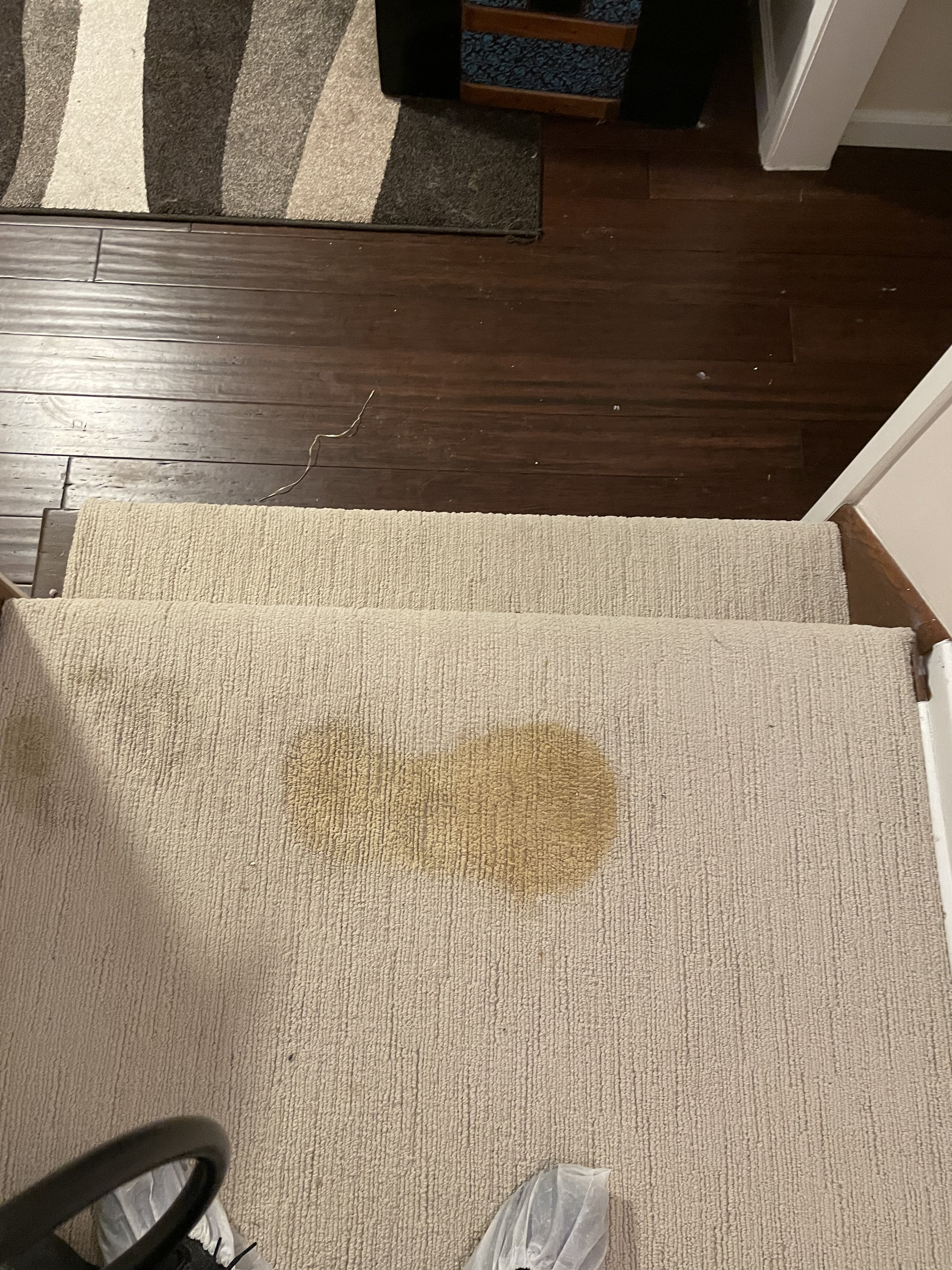

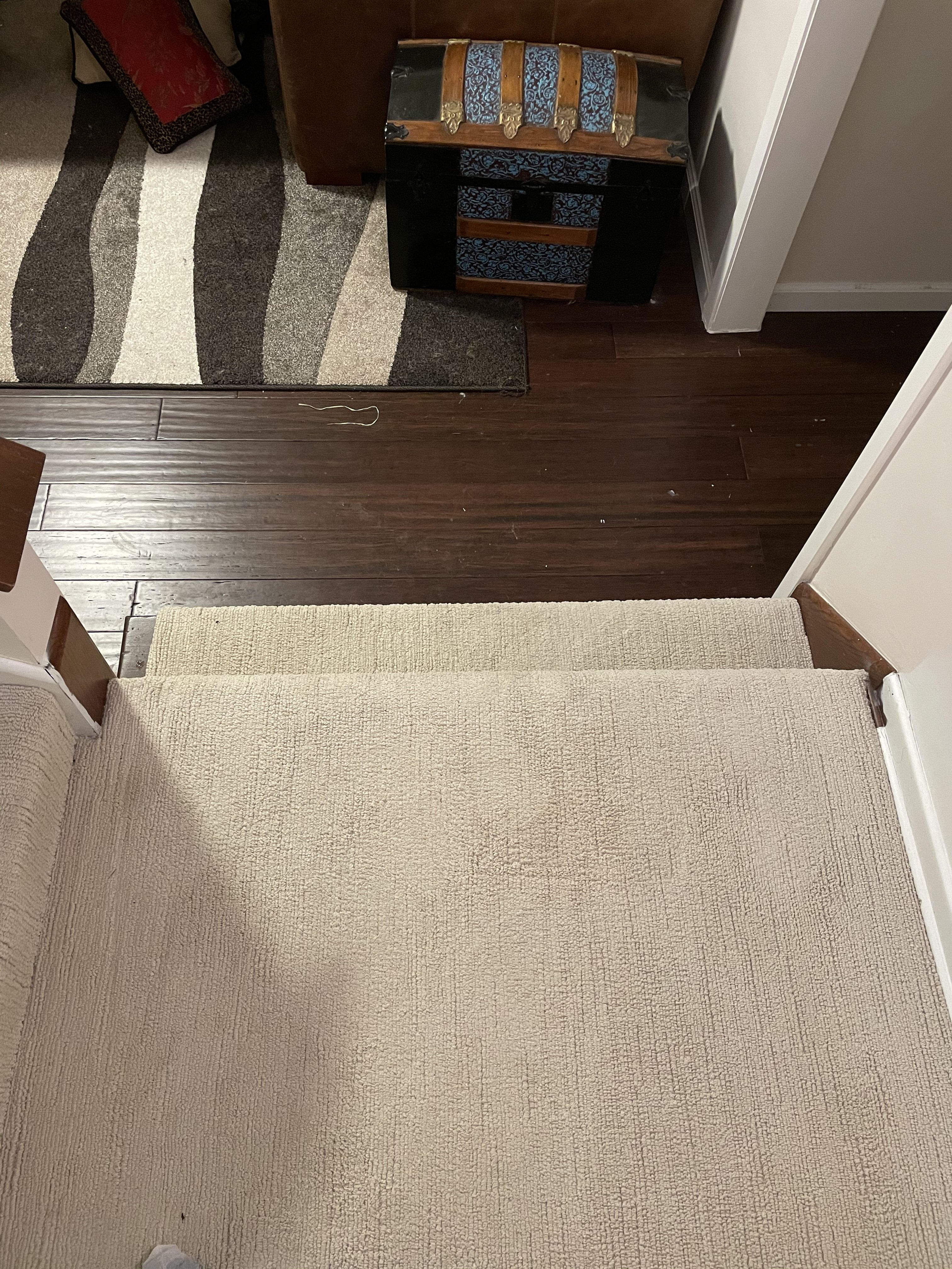

Cleaned this customers stair case a week ago. His dog vomited on the landing the night before the cleaning. I was able to fully remove the vomit from the landing as the pictures show. He called my office staff today claiming the spot came back 8 days after the cleaning. I told my office staff to ask for pictures so I can see if it’s the same area or not. My guess is it’s a new dog accident. He’s asking for a free cleaning. Thoughts?

Do you have a picture of what the reappearing spot looks like now?
What products did you use to remove the spot?
Did you use a subsurface extraction tool?
Oh....and what did THEY use on it before you got there?
Looks great!
You know it's not a fault of workmanship that caused it to come back. Was he told of the possibility?
If not, I would do it at no charge after explaining it probably got down into the pad, maybe even the wood subflooring. If he wants to be sure it's gone, the carpet could be disengaged from the installation, replace the pad, clean the back and surface and allow to dry before reinstalling.
If you pre-explained to him that you are paid for the effort not necessarily the results. Then of course return, reservice and bill him.

Waiting on customer to send a photo. He said they didn't use anything on the spot since I was coming the next day for his scheduled cleaning. All I used on the spot was my pre-spray.
Reactions: Living The Dream
24,126
Redding
If I’m understanding you. The first pic is supposed to be the spot after it came back? I call BS. The customer’s lying. That is a fresh spot. I know my piss and vomit.
That's not "your piss and vomit ". First picture is before he cleaned second picture is after. He, nor we know if the claimed spot is from the initial incident.
Let's wait till we all see the pic then.
I rarely believe that they don't at least deodorize puke, and I'm suspicious of the shape of the spot in relation to what dog vomit usually looks like when it happens.
I just don't trust people at all anymore.
Ask "Sweet Baby James" Chavez...I used to be a nice person.
if dog puke
Was watery , soaked down for who knows how long.
Possible (likely) it wasn't flushed properly or thoroughly enough
("properly" meaning up to and including Chevy's full monty if/when needed)
