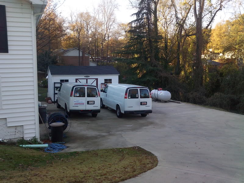

The reason that Judson is not going to EVER make a monster machine is that it is not practical or required. There is a point to where all your eggs are in one basket and that basket costs a lot to buy. If you guys really want true dual wand performance, then it will have to be with independent recovery tanks. This way there is no conflict of wands. When one guy lifts his it will not affect the other. With independent recovery tanks, you would have independent blowers and engines. The advantage of this is that you now have redundancy in case one fails. It’s kind of like flying an aircraft across the ocean. You want to be in a twin engine, not a single engine.
Another advantage of having independent systems is that when you are single wanding, your operating cost is cut in half. With an independent system I can produce more CFM with less horsepower. A TNT Super Duty would have a 25 hp engine and a blower producing 500 CFM. Times 2 is 50 hp and 1,000 CFM. To manufacture a monster machine that produces 1,000 CFM would require a very large and expensive engine that is not common at local small engine repair shops and consumes a tremendous amount of fuel. It would cost a lot not only to purchase this engine but also to replace it.
Two TNT Super Duty’s in a box truck will maintain 240 degrees with two high flow wands and will cost somewhere around $30,000 give or take a couple thousand depending on your choice of wands, hoses, and reels. The system will also have a combined recovery of 240 gallons. All Judson truckmounts pump cold water and our regulators operate under cold water. This is very important to have a trouble-free system. Another advantage of buying a Judson machine is that you have me to support you. I’ve never kicked anyone in the teeth when they’re down and out like some of my competitors have.
There is not another truckmount manufacturing company in this industry that has had its equipment abused any worse than Judson. Our service record speaks for itself. No other manufacturer can say what I am about to say. Call one of my customers that has been running one of my machines for over 25 years and get an honest opinion about our equipment from the actual user, instead of the opinion of someone who was paid to give an opinion.
Give Mike Ramsey a call. If you need more references, I have them. Mike has been running a company in Spartanburg, South Carolina for 30 plus years. He has all the major accounts in South Carolina like the BMW plant. He will be glad to tell you some of the other accounts he has. His list of clients is very impressive.
The heat exchange guys will say that it is such a pain buying propane, and I say that it is a blessing in disguise buying propane when you have your own fill bottle at your facility. That way you are able to buy it at a substantially lower price. The ultimate system would be a propane-heated truckmount with a propane engine and the vehicle running on propane. This will extend the life of all the engines and you would truly be a green company.
The bottom line for purchasing a Judson machine is the extreme simple design, which makes it easy to repair, and the use of a lot of common, local parts. Also, for the performance you are getting, the operating cost is extremely low.

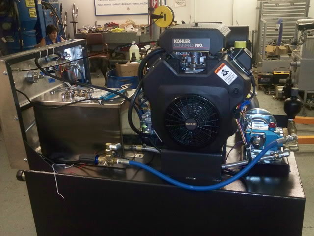

Layton,
I don’t know if you’ve seen my videos on the reengineering of a complicated heat exchanger or not. I will post them for you to look at. If it was me I would just do a total reengineering like you will see me do in the videos, eliminating anything that could possibly give any problems including all the heat exchangers. I would add a #4 Little Giant Heater. The reason I would not leave any heat exchangers on the system is that the Little Giant Heater operates better with cold water entering it. About 20 years ago, we reengineered the heaters and moved the thermostats to the top. With cold water entering the heater, it fires immediately.
By not relying on the engine to produce any heat, you can actually turn the rpms of the engine way down, and extend the life of the engine and save considerable amounts of fuel.
Jeff Woods who owns the machine in the video is actually cleaning carpets at the lowest rpm setting, but his heat is better than it ever has been (240 sustained high flow). Even though Jeff has the additional cost for LP for the heater, it is offset by the lower rpms and lower fuel consumption of the engine.

Layton,
o]http://www.youtube.com/watch?v=mkBzsBKM0Uso]
o]http://www.youtube.com/watch?v=pDu9ji19AK4o]
o]http://www.youtube.com/watch?v=7OKTxCIcKDMo]
I get all that and already have a screamer for propane burner......but i REALLY REALLY like that engine coolant heater you have on that reactor (is that right).....
because if i do furniture or the like, i dont want to worry about the heater cycling....which is partly why i wonder if i could make it run like a little giant, yet have the burner part stay the same....
and i always, unless LONG runs, or the hopeful dual wand, run it mid range....low setting is just to low for me
