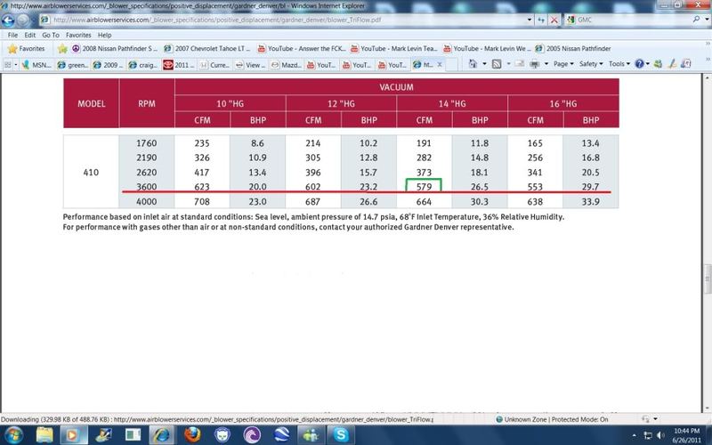

What are the specs of both blowers at the SAME rpm and the SAME inchs Hg?
for 14", 15" and 16"
What RPM will this engine be running at on high?

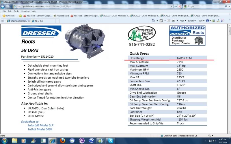

I'm not great at reading charts, so tell me if I'm looking at these results wrong, but it appears the 59 is far better cfm at lower rpm which would save on fuel and wear & tear of the engines, belts, etc. etc.
Bill mentioned that the heat exchangers on the SS 870 heated during the HP mode and that diffinately is a feature that I am very interested in, however I was real excited about the 59 blower for dual wanding, now that isn't happening. Harper (a man of experience with both blowers) says there is a substantial difference between the GD 410 and the 59 and I have to believe that he knows what he's talking about.
