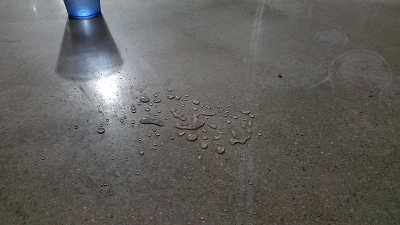

Sealing with what? You either use a guard after polishing, which gets burnished, or an impregnating sealer. Typically you would buff afterwards to remove any residue. I just did my garage this past weekend and sealed with an impregnator, no topical.
No finished pics yet because I had to move all my stuff back in with rain coming, but here is what the sealer does.
PROSOCO SLX 100

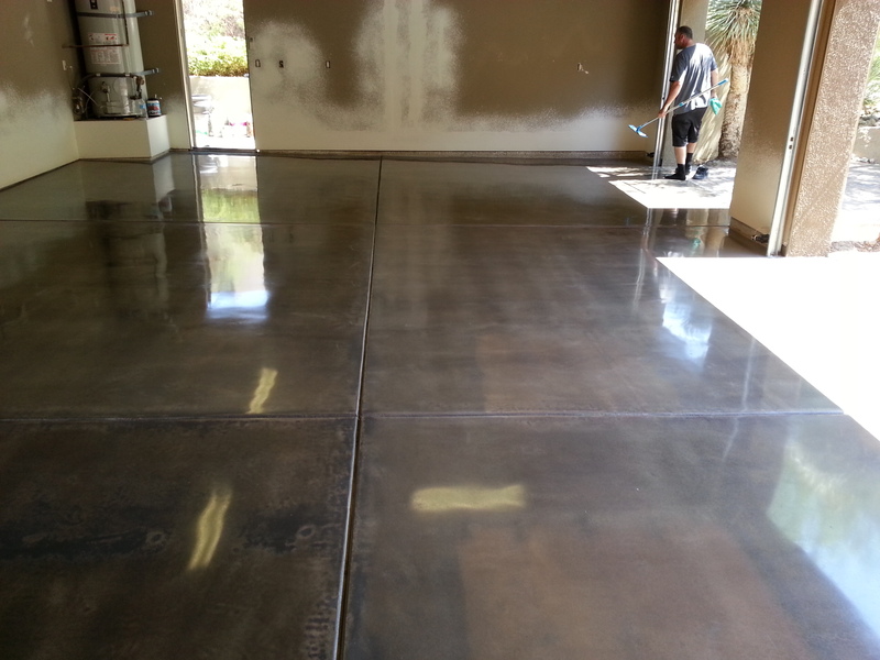

Here is one I did with a guard that got burnished.

they must be using a guard of some sort then. Burnishing sets, or cures the guard and makes it a lot more durable than if you were to just apply it and leave it alone.
Not something you want to do without a little practice
