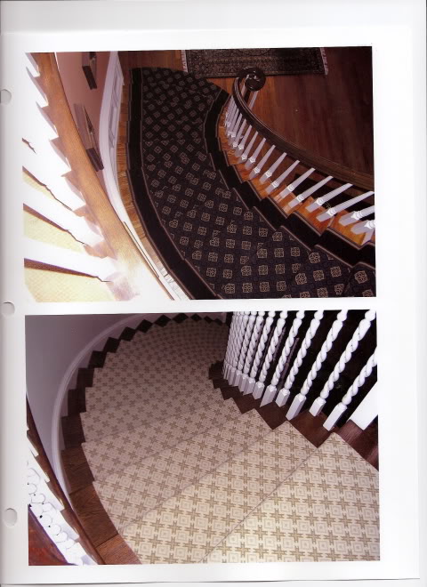

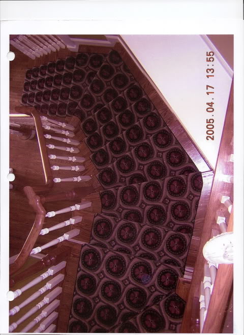

Thanks Ron let me post some more . Here is a axminster 3/4 yd carpet . This means that there is a hand sewed seam on every step. This is the old weavers way . First loom in production was 27" .
Top view looking down.
Harry Myers
Oct 13, 2007
1,268
Charlotte, NC
Harry Myers
Re: Staircase Installation

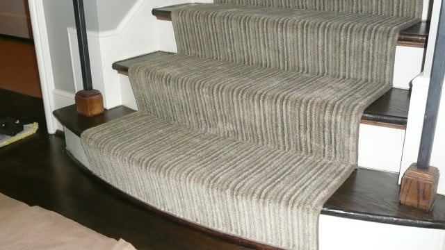

Now this one here is an Ingrain which means it can be reversable pattern on both sides.
Im sure you nascar fans are familiar with Jimmy Johnson.
Harry Myers
Oct 13, 2007
1,268
Charlotte, NC
Harry Myers

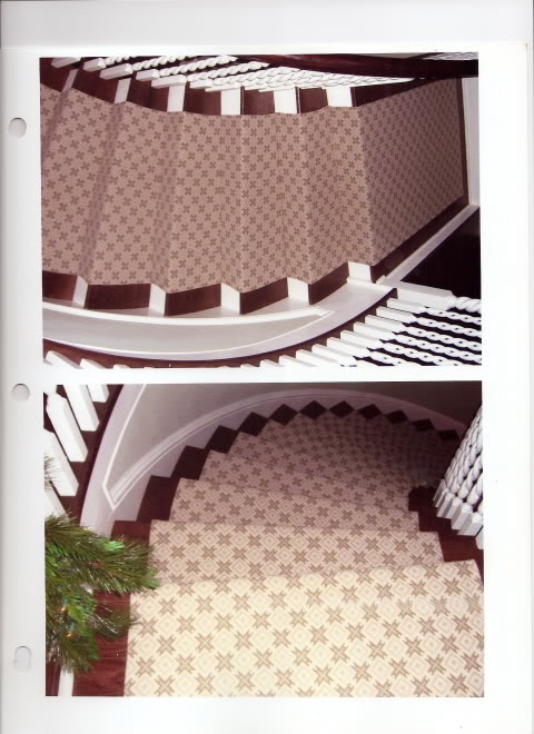

Here is that ingrain and we also have a hand sewed border rug. These 3 steps on the bottom are handsewed along the nose . This is where the art of handsewing comes in. It is alot more tedious than wrapping the nose.
Harry Myers
Oct 13, 2007
1,268
Charlotte, NC
Harry Myers

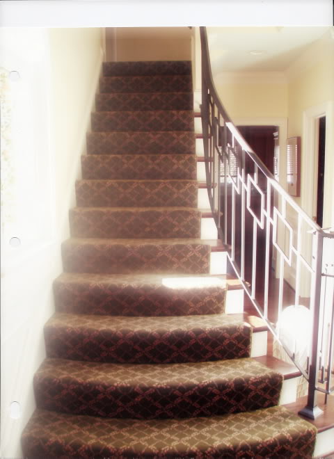

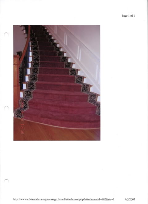

Here is a Axminster border . With a velvet strai field. There are 2 things against me they both don't stretch well in the width. The Ax don't bend that way at all. Personally beautiful step job. But a bad and tough decision on materials. Now the bottom 5 are handsewed along the nose . The bottom step was 9 ft wide.

Some really nice work there Harry.
Can I ask, when you do these custom installs, particularly those like on the bottom shaped treads, do you measure and then sew offsite, cut each piece and then sew onsite and then place on each tread, or sew insitu with hidden stitches?
I know for actual stair manufacture, we always cut out a single dimension template and then build it completely in the workshop, pull apart and re assemble onsite.
Just wondering how you go about that sort of thing with these.
Cheers, John
Harry Myers
Oct 13, 2007
1,268
Charlotte, NC
Harry Myers
Those bottom stairs are done onsight . We need to match our pattern than cut. Yes it is sewed along the nose approx:/2 under so when you step you are not stepping on the seam. John I can cut by a round bull step mathemeticaly. But I still have to sew on sight. Thanks John.

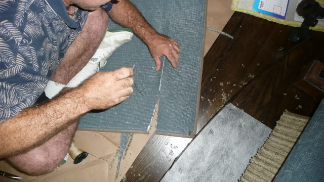

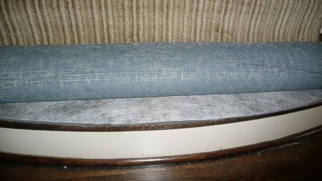

Here is a round step hand sewed . goods were tufted material . This is called a HP backing actually is is made for glue downs.
The step is marked.
Harry Myers
Oct 13, 2007
1,268
Charlotte, NC
Harry Myers

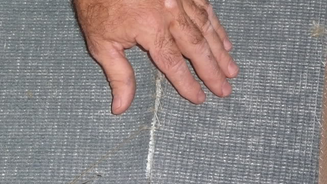

Now I cut along the nose where I marked the stair. I am putting a locking stitch on this. Why we do not want it to rip open when fitting it tight to take shape.

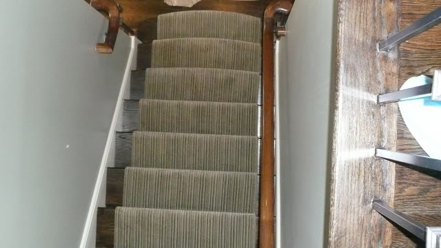

Harry Myers
This is the step when completed . The 2nd step almost needed to be sewed but we use a steamer for manipulation to fit.

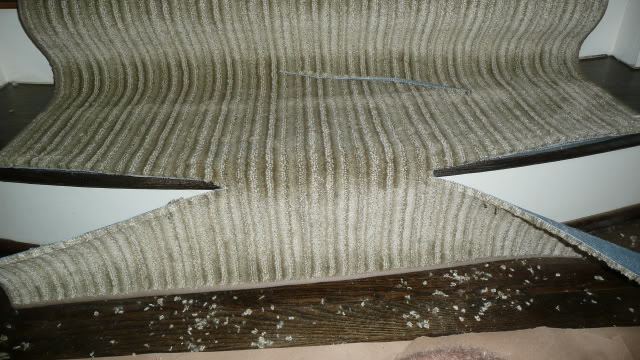

Harry Myers
Now for a better view of why you have to sew the round steps to fit. As you could even see the pertrusion on the 2nd step.
