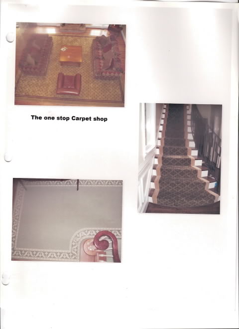

Tony . In the 1st photo and the 3rd. This is the interesting thing about these step. They are all done by scribing out. They could not be done by using a square . Why? the step is round and not square . When doing these steps as I do so much. The middle portion where the bend is extreme. They are actually bigger than some of the other step. Yet they still maintain consistency. Also there is another step that changes more or less for the straightness. This would be the 6th from the bottom although it looks the same . It sure is not. Also leading to the bottom. This was a job the woman has a friend with these steps. She hates them. This is my everyday day. Yet another customer that is extremely satisfied.

I have a phenominal selection of staircase piccies. You like that ? Middleton hah. Are you interested. Also I have a ton of Area rugs would you like to see the fabrication process of a woven velvet. hopefully there will be no problems wit hit but you never know.

This is a test for my new scanner. Any way the picture in the left is a nourisan area rug . I put together the borders and used seam tape on that one. The stairs in the middle . It is a hand sewed Axminster , bordered with a single frame wilton border. These steps on the botton 3 are hand sewed along the nose . Reason being the step is rounded and will not form without minipulation, In the form of sewing . The bottom left is a wilton bordered rug customized to take shape of the rounded step.
