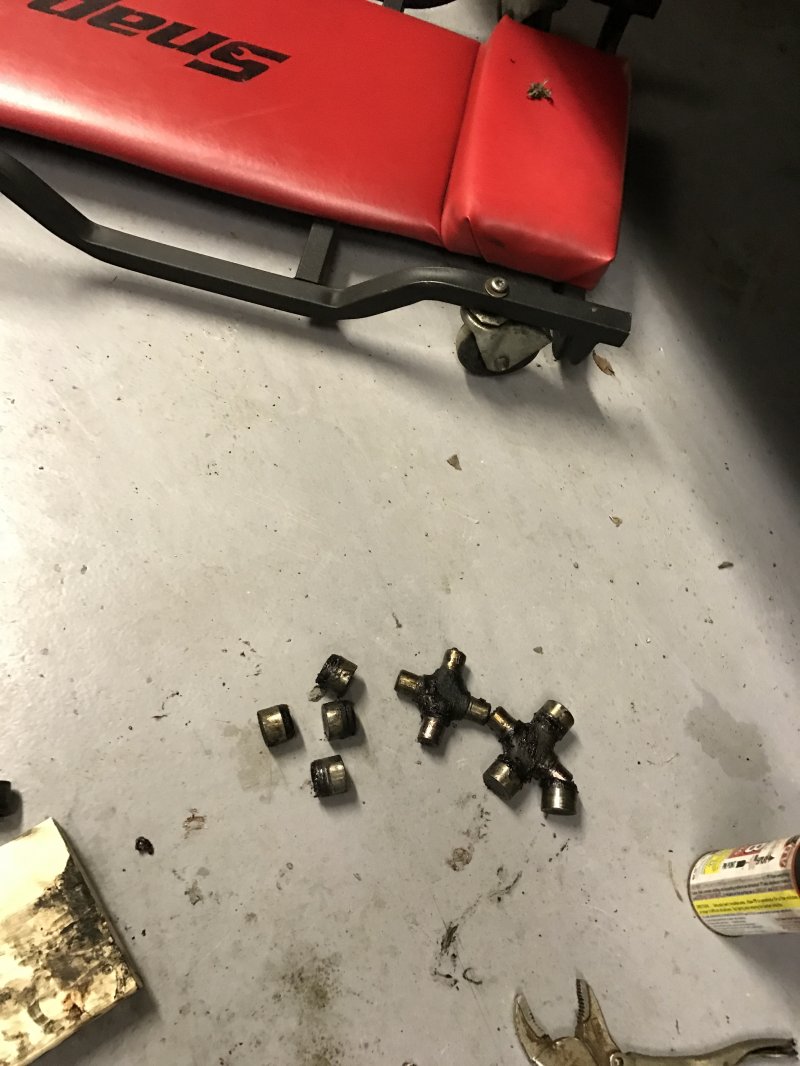

Yesterday I started going thru the Aerotech and started to replace wear items. I am starting under the truck with the universals then I will replace the belts, replace diaphragm in chemical pump and pump out.

Notice the grease fittings on the new universals (only a few minutes to add lube)

Ron can you access all the zerks on the AT pto shaft? We could not and had to install convex fittings on two.
Every 2-3 years we change our pillow blocks. Too cheap not to change.
Also I am sure ron cleaned that excess grease off the bearing as it will accumulate dirt and eventually fly into the belt and then to both pulleys.
