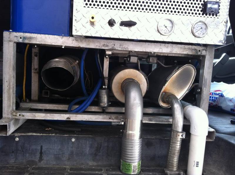

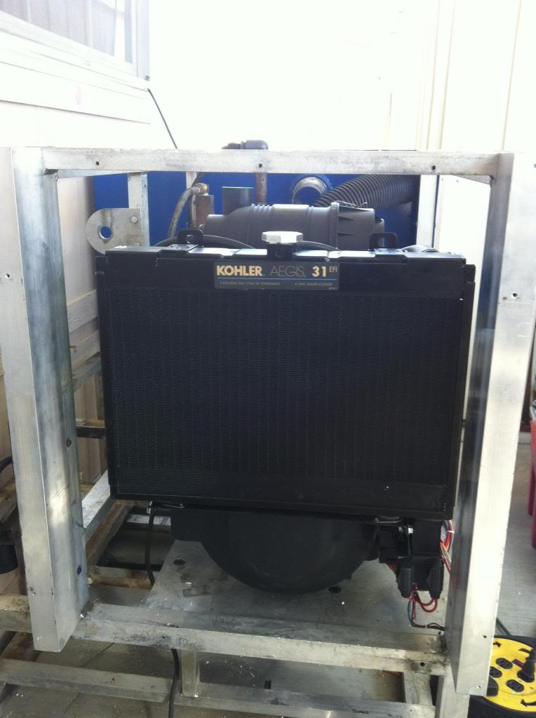

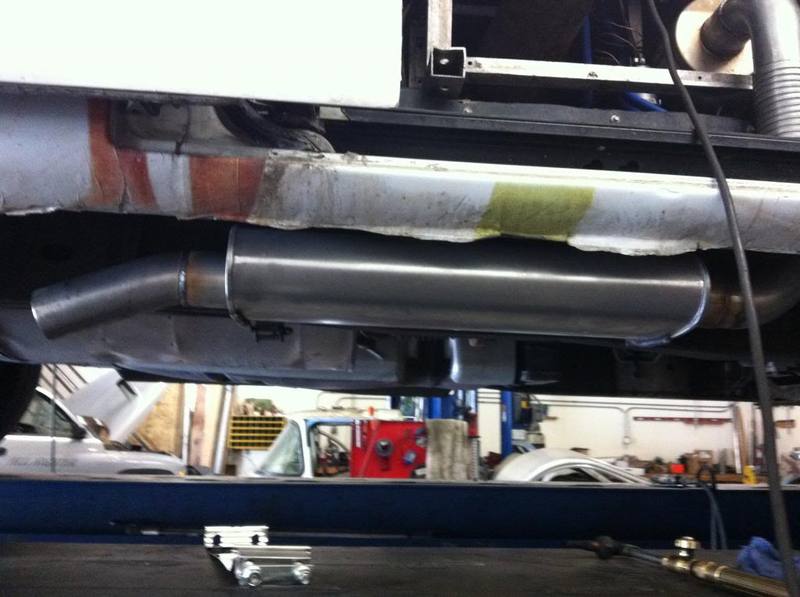

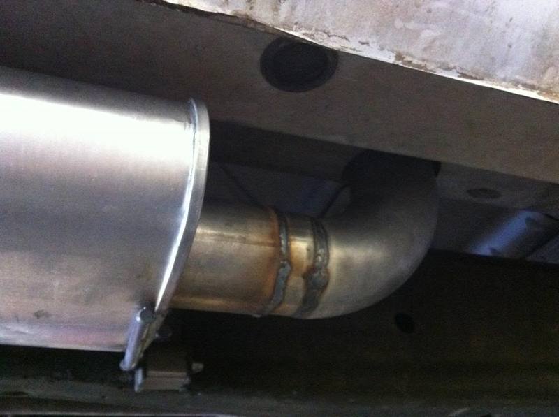

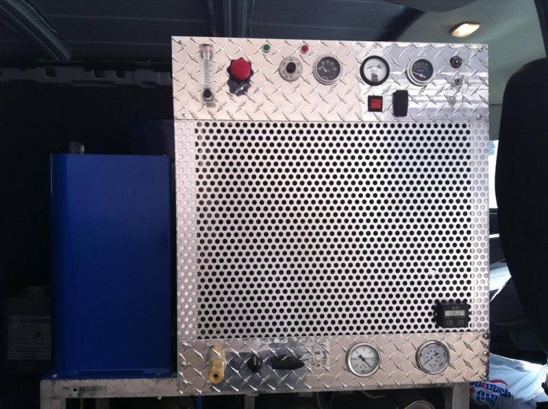

Very nice the unit just check the silencer making sure it does not have any rust o holes sound is about the same as any other the burner makes a blow off sound the heat is crazy
does it have the generator working .
this mode made mine so quiet and I'm using a 31hp engine and a 47 blower
