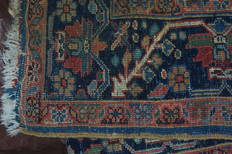

Oz, that kinda of looks like a Kashan... am I right? :shock:
If you can take a picture of the back corner, that would be great.

Here is the corner of the rug
The ph on the microabn is 12.2. I be scared to go that high with the ph on this old rug.

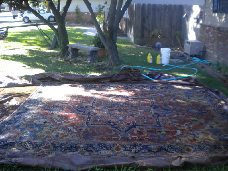

Harry Myers
Oct 13, 2007
1,268
Charlotte, NC
Harry Myers
This is my question . Where and how are you drying it. I know you said you used fans. What about hanging it in the sun to dry. Are you drying it directly on the floor or ar you drying it on the tarp I see outside on the ground.

I moved it into the sun with fans under it on a new tarp that was dry. I am thinking about putting it in the sun for a day and see what that does.
I did that with a futon mattress I got before I was a cleaner. It was from a smoker and 1 day in the sun the smell was gone.

If you are trying to dry that rug on the tarp it will never happen, that rug is sweating on top of the tarp put a fan under the rug to keep air moving or go to the store and buy a 12 foot pvc pole and hang that rug up .

Ron, that was why I asked that question. I have to say the rug is not drying quik enough . The Medallian gave the Heriz away.

Well a few hours in the sun helped a little.
We used air to dust the rug
I flushed the rug until it ran clear water. It took a lot of water for this. glad I'm not on a meter yet.
When I dried it I had the fans under it and took a vac hose and laid it around the edge of the rug so the air was forced through the rug. I also used a odor disc on the blower.
If clean it again I'm going to buy the stuff to hang it. Baby sitting a rug all Sunday long sucked. I have a set up to hang 6' wide rug but this thing is 9' wide, beast
