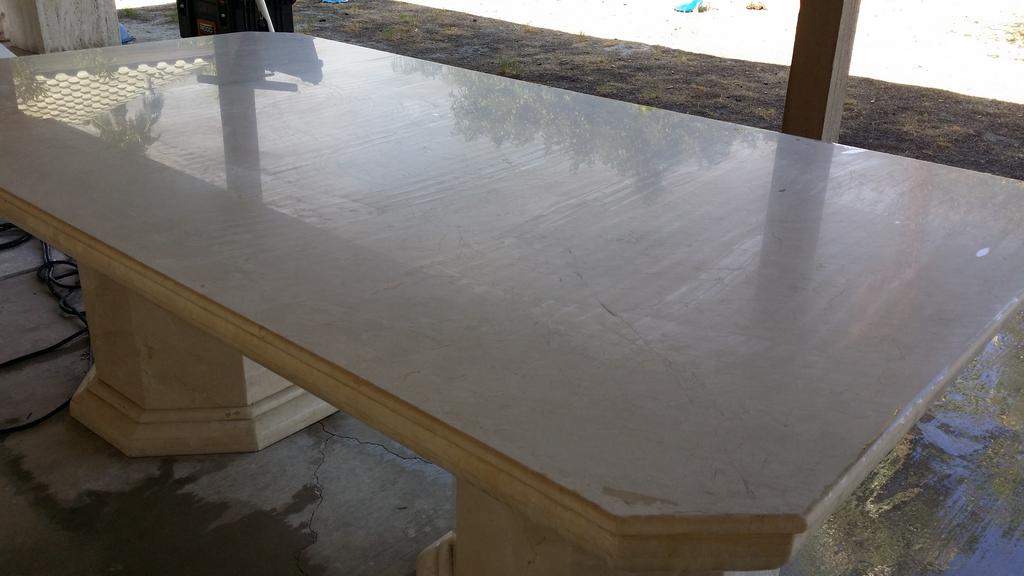

This is 800 Grit on Crema Marfil

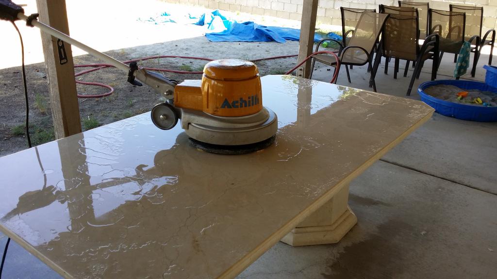

This is 1800 grit on Crema Marfil, no polish
This is my test table in my backyard

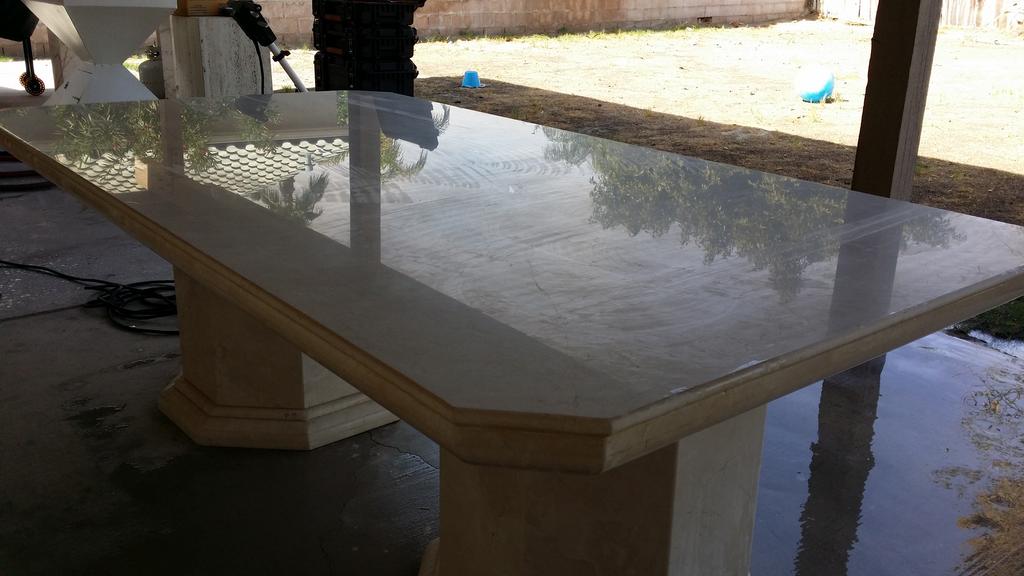

And here is the finished product after our Dynamite 5X
