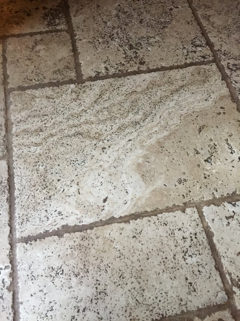

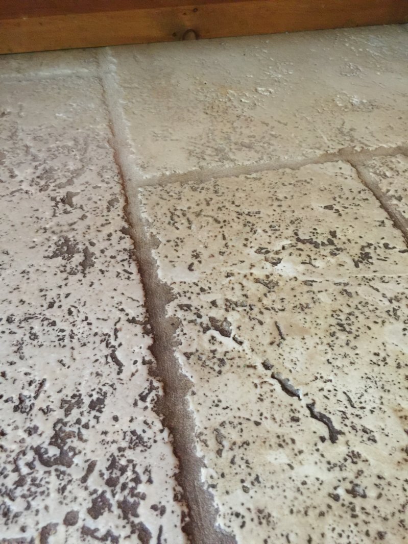

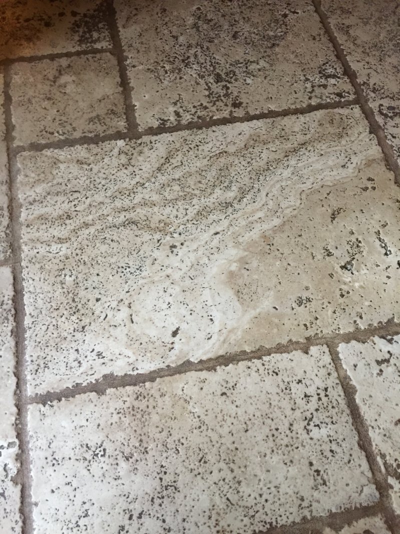

I did a quote today and came across this tile and grout. Looks like it's has been sealed with the soil in the grout. Maybe a colour seal attempt. Any thoughts

looks like normal grout to me. The stroke marks you are seeing is typical of these floors, they wait longer to clean up and the sponges can leave those marks. I don't see anything that indicates otherwise. a good alkaline, brush and extraction with a truckmount should make a big difference. The brush will help with all the crevices and textures of the stone.
I was going to say all that was already said above, just in a nicer and more proffessional manner.
Now if they need it filled, I can demonstrate why amateurs should never attempt to match color.
Unless soft lavender is what they want, I mean.
