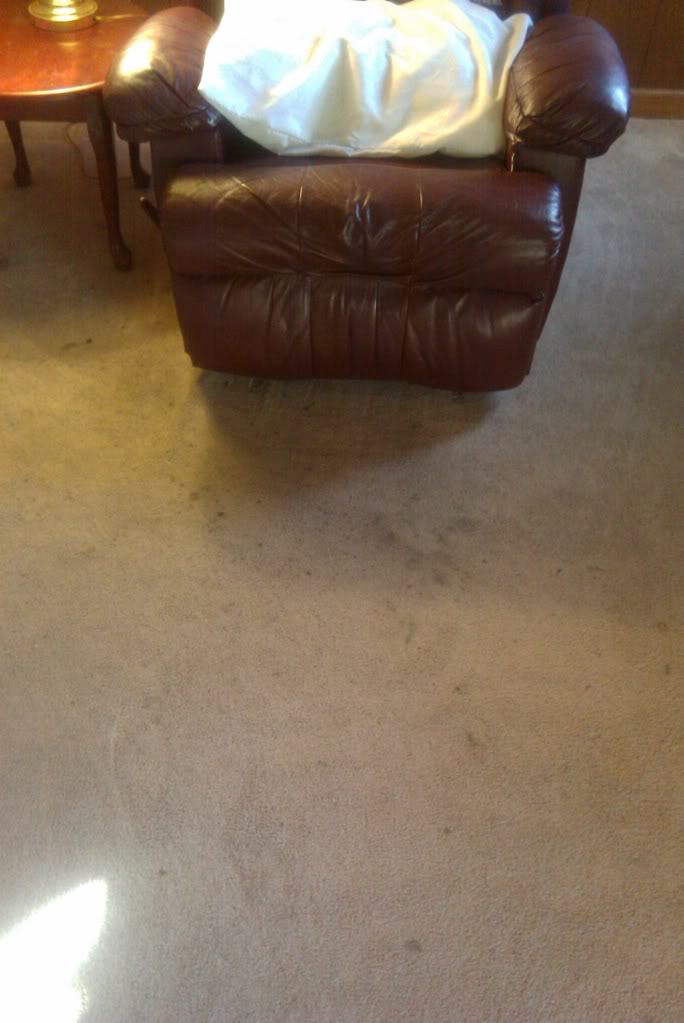

I used orangeforce today and must say I am very impressed. This carpet had not been cleaned in 9 years. I mixed at half recommended dilution. I vacuumed good, sprayed it on, let it dwell, and raked it in. The smell was very pleasant, mixed easy, and did the job just like every other prespray I have used. In fact I have not used a prespray that didn't work, but this combo is one of the best I have used. I plan to order some and use my powerburst for rentals and commercial and use this stuff for residential.

Anyway, I mixed mine by eyeball, put some #1, #2, and some of the booster in the mytee inline, and have at it. Gave it a good scrubbing with the 175 and red pad, dwell about 20 mins or so, then rinsed at 450 psi. My usual sauce of choice is the Pro's Choice Ultra TLC, but can't stand the way that stuff foams up. I didn't get that with the orangeforce. It cut through the crap just as easily, didn't foam no where near as badly, and leaves a much better fragrance in the house. Too bad I'm already stocked up on chems, cause I'd gladly switch to the orangeforce, and plan to when I need to restock.

I used a pump sprayer with 2oz per gallon of Of1, 1oz oer gallon Of2, and 1 oz per gallon or the booster. I mixed it hot and cleaned with my Legend with just warm water. So yes I am impressed. Also there was a place at the back door where the door stop had been dragging on the carpet and my experience told me it wouldn't come out or atleast I would need to break out something strong. I sprayed it and scrubbed it with my shoe and it came right out. The fragrace was stronger after I cleaned the carpet. Like I said earlier there are a lot of great products on the market and they all work. I like this because it removed everything with ease, mixed easy, didn't foam, and smells good. I have a little left and I am going to use it as a booster on a tough job this weekend.

that carpet looks to me like it has a classic case of dog oil, meaning they have a dog that has very oily hair and that transfers onto the carpet. my ultrapak traffic clean will "paint" carpet that has a dog oil situation. not impressed.

Yes you are right. There was also a lot of grease coming in from the garage. Why are you not impressed? I posted a month ago about a restaurant I had trouble cleaning. I plan on using the juice as a booster to my powerburst. I am doing one thing different as well. I increased the flow and went from three jets to five plus glides on my RX so I can flush this carpet like crazy. To be honest I moved the recliner to clean under it and had slurry running through the line and had to scrub on it to get the soil to release. Everything else came out with one pass. The other rooms were a different style of carpet and had quite a few mystery spots and they came right out. What juice are you using?

because when you use something that targets the oil in a dog oil carpet it cuts through it like a hot knife through butter, the results are dramatic. the citrus stuff was attacking the oil big time on that carpet. which also means other products will do the same thing. however most carpets don't have a dog oil issue or need something that attacks oil that violently, IMO its not a good thing to use on the carpet, I worry about it rinsing properly. with that said I recommend a well formulated standard prespray, hint ultra-pak is a great one, that will do just as good a job and is proven to rinse well.
some carpets getting the gunk out is more important than rinsing the carpet really really well, that carpet may have been one.
