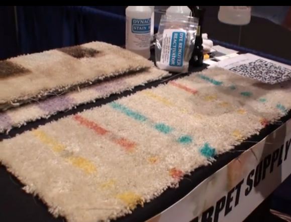

Larry Cobb
5,795
Larry Cobb
Reactions: Welshmalc
