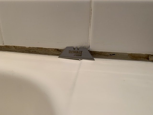

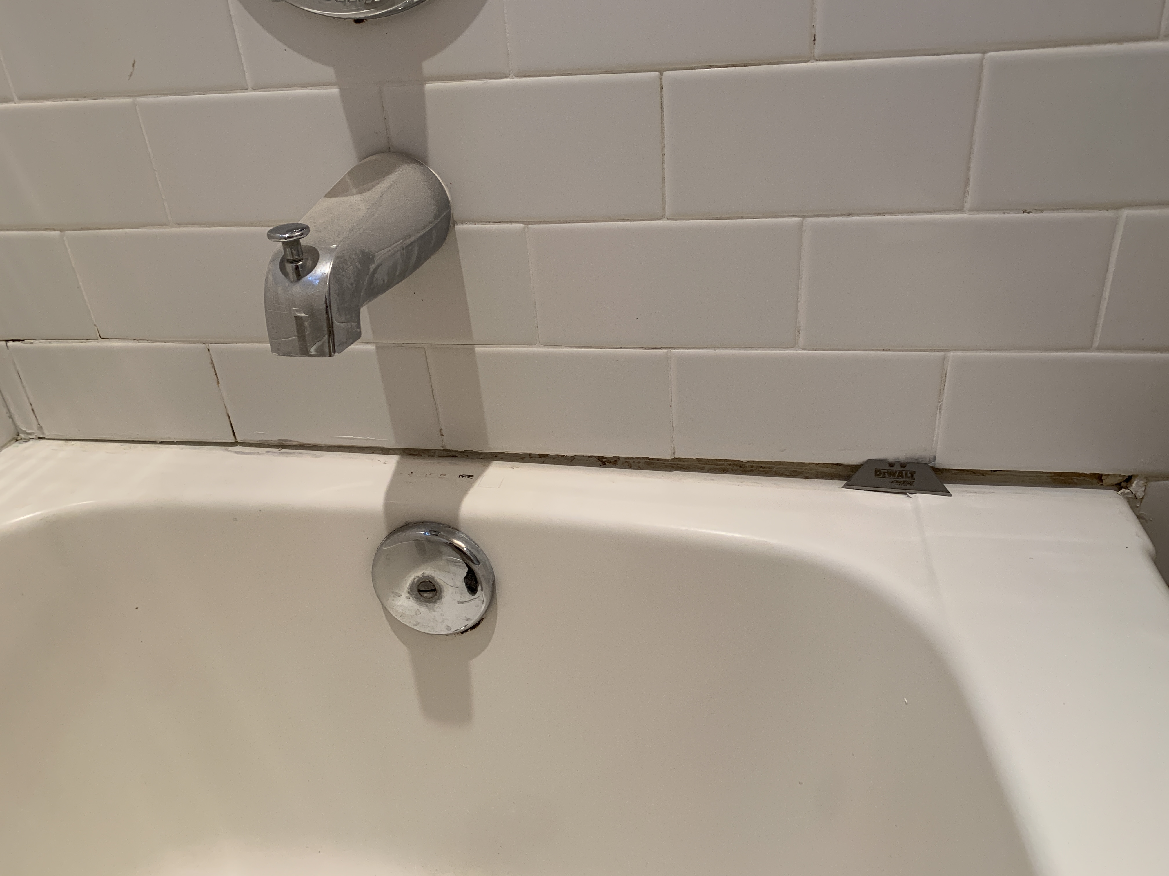

What do you suggest to fill in a void around a tub.
1/4-3/8" about a foot tapered length. Don't have tile to fill.
Is there an epoxy product that can be used. Also may need to put some sort of backer because of a void.
Thanks in advance.

you can use backer rod if you really need to but thats not that big of a gap. Any epoxy grout will work or SGA or 100% RTV siliconized grout which I what I prefer for just repairs as its super fast and will last many years. Regular caulking sucks
117,378
Has mentioned make sure that tub isn't falling and it's not just a shity tile installer that created that Gap but yes colorrite RTV silicone would be the easiest for a rookie to fill that ...personally I would use SGA but a gap that why it's going to be a pain in the ass to learn on

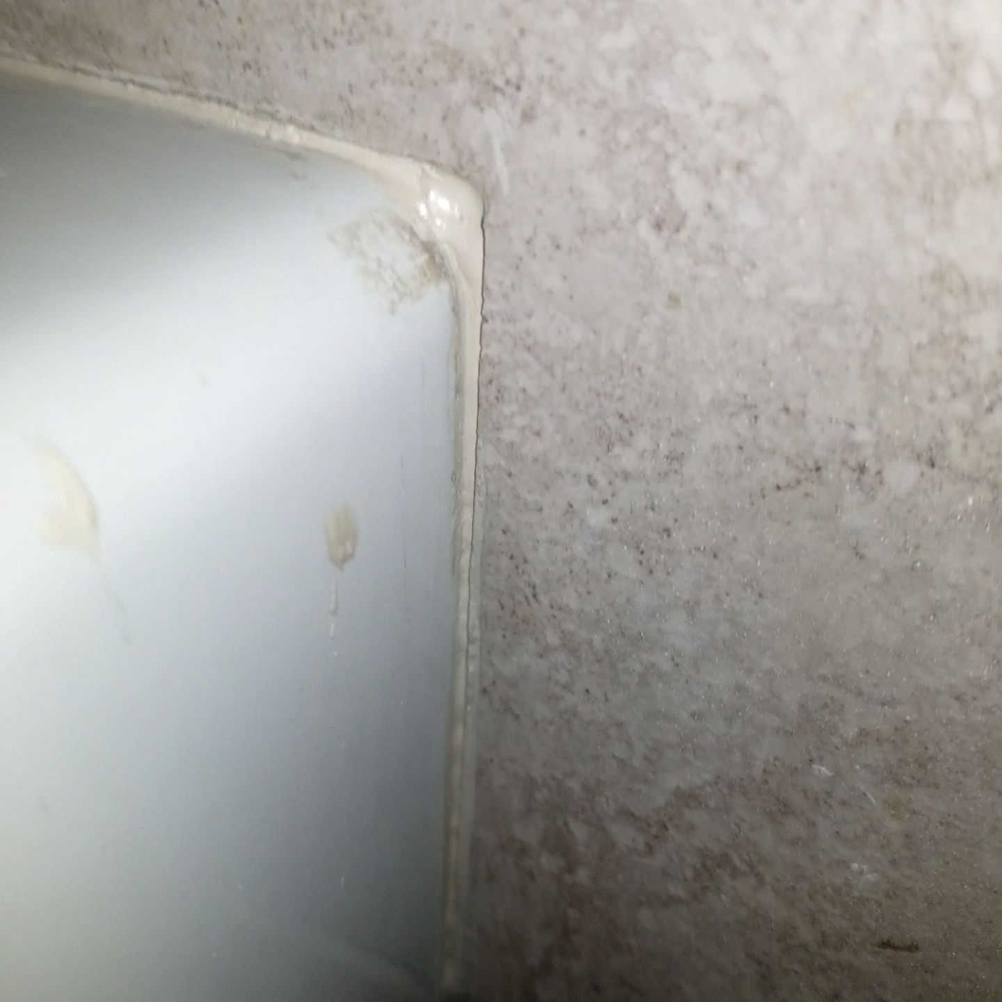

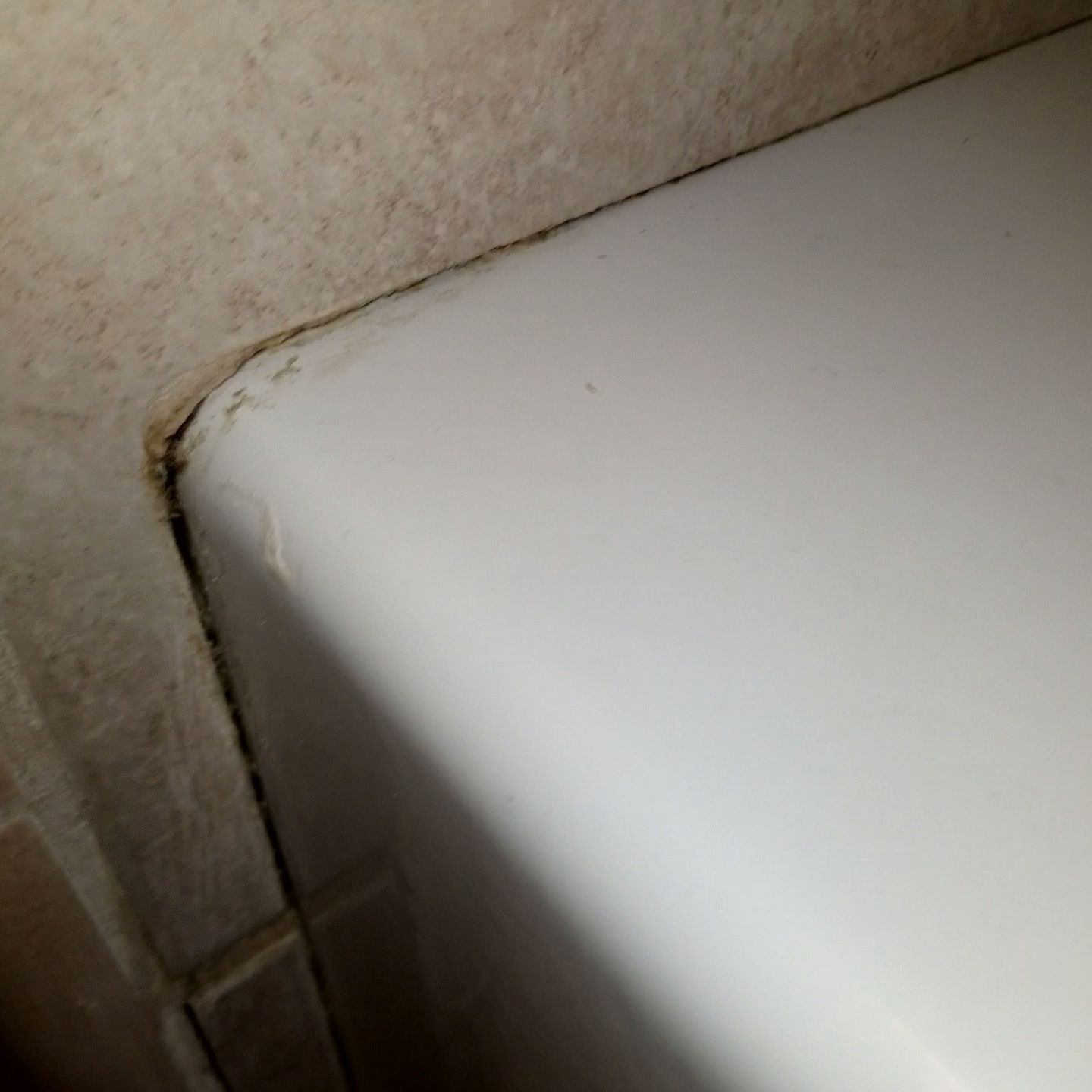

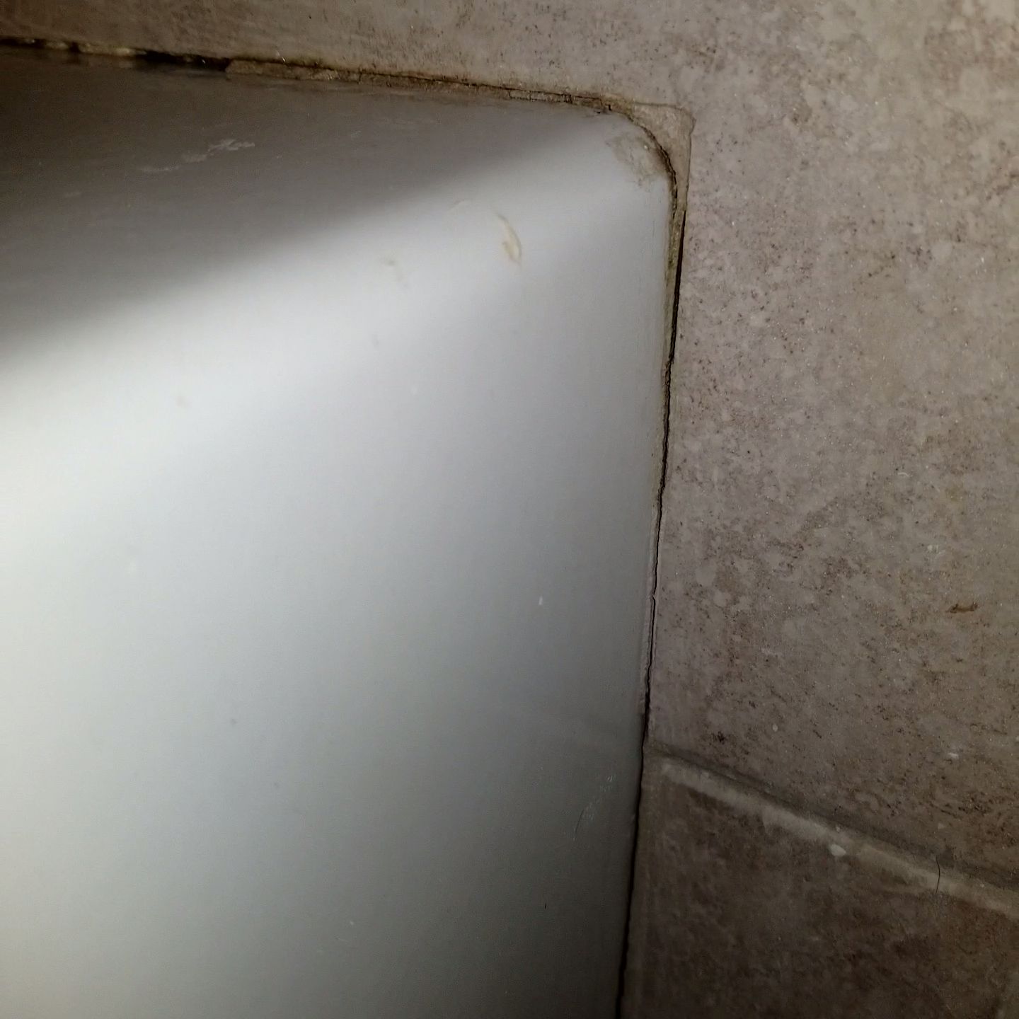

Did one yesterday. I did alright. I did it at cost for a rental being sold.

I only charge for cost of product $35 so i can practice. I need lots of practice.
In a nice home, yes i would say it worth pushing it. Gotta put fear in the soft sale. Id imagine charging about %20 the cost installation. Ill take it.

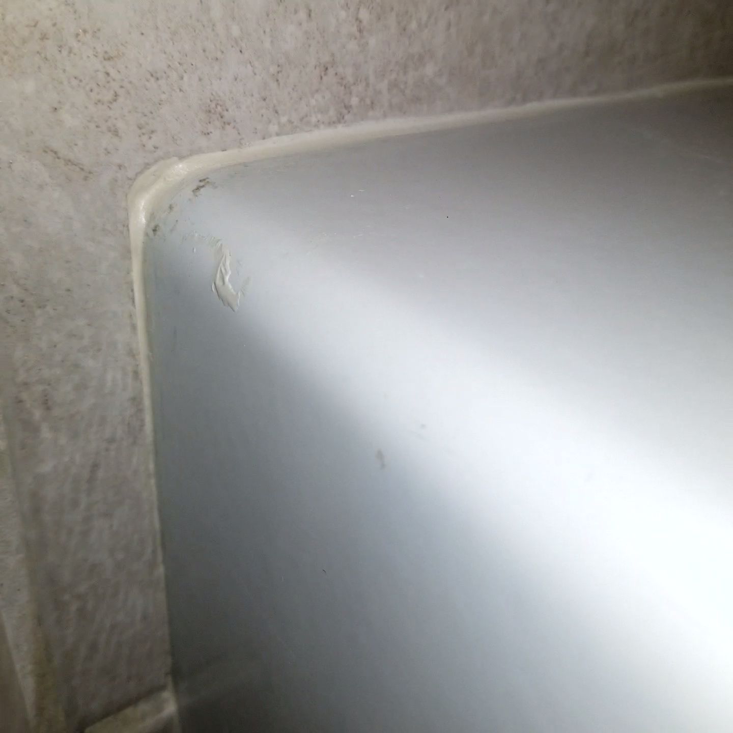

The sga is much straighter. I cleaned it up more. I just dont have the final pics as i needed to get home for sy kindergarten graduation.
VideoCapture_20200603-103304.jpg VideoCapture_20200603-103327.jpg VideoCapture_20200603-093652.jpg VideoCapture_20200603-093610.jpg
