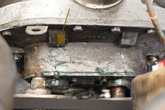

I was greasing my blower as usual and grease came out in a new place. Any idea if it is normal or if there is a problem. You can see the spot it came out below the arrow. Thanks

Nothing ever weeped out before. Just in front of the arrow is where it normally comes out. This is the first time that grease ever came out that hole. I shot an email off to Tampa Armature Works. They are the closet place to get a repair for this type of problem. It still works fine, it just worries me a little. I prefer to be proactive and get it fixed at my convenience if it is a problem.

If those are the WEEP HOLES for your blower.....That is a GOOD thing !!!!!!
That is designed to WEEP ...the old grease out of the blower as the NEW is forced IN :!:
Is the grease real thin in consistency :?: And SMELL really bad 0r burnt :?:

Not that anybody cares since it's not on a vortex but I spoke to the mechanic today at Tampa Armature Works. The grease coming out that hole means the seal broke . It costs almost as much to fix as to replace with a new one plus 3 weeks turn around time. Both mechanics I spoke to told me that basically 5 and below in blowers are considered disposable. The cost to repair makes it impracticable. He did say that it could last another 2 years as long as the bearing has enough grease. Their is no real way of knowing. I ordered the new 5m without the grease fittings. It should come in before there is a problem. It currently has 7200 hrs so I guess it doesn't owe me anything. I would like to see how long it will go before it dies but it's just to big a part to have to replace at it's whim.

They are disposable.....It cost almost as much to Re-build as to Replace new.....

RW, The mechanic I spoke to told me the specs. call for rebuilding them at 5000 hrs. However I have a friend that works at the mill and he told me as long as they have lube and are aligned properly they should last damn near forever. I just got unluck and have a seal fail. Maybe I lubed it too much. If that's possible.

your over greasing the blower. Just like your cars suspension, you will break the seals. That blower will last for ever. run it till it needs replaced.

I'm sure you are right but I'm the kind of person who replaces his hot water heater at 10 yrs. regardless of condition. Besides, I bought the new Q version that is supposed to be 5 db quieter. Your right about the over greasing. I caused my own problem without knowing any better.
