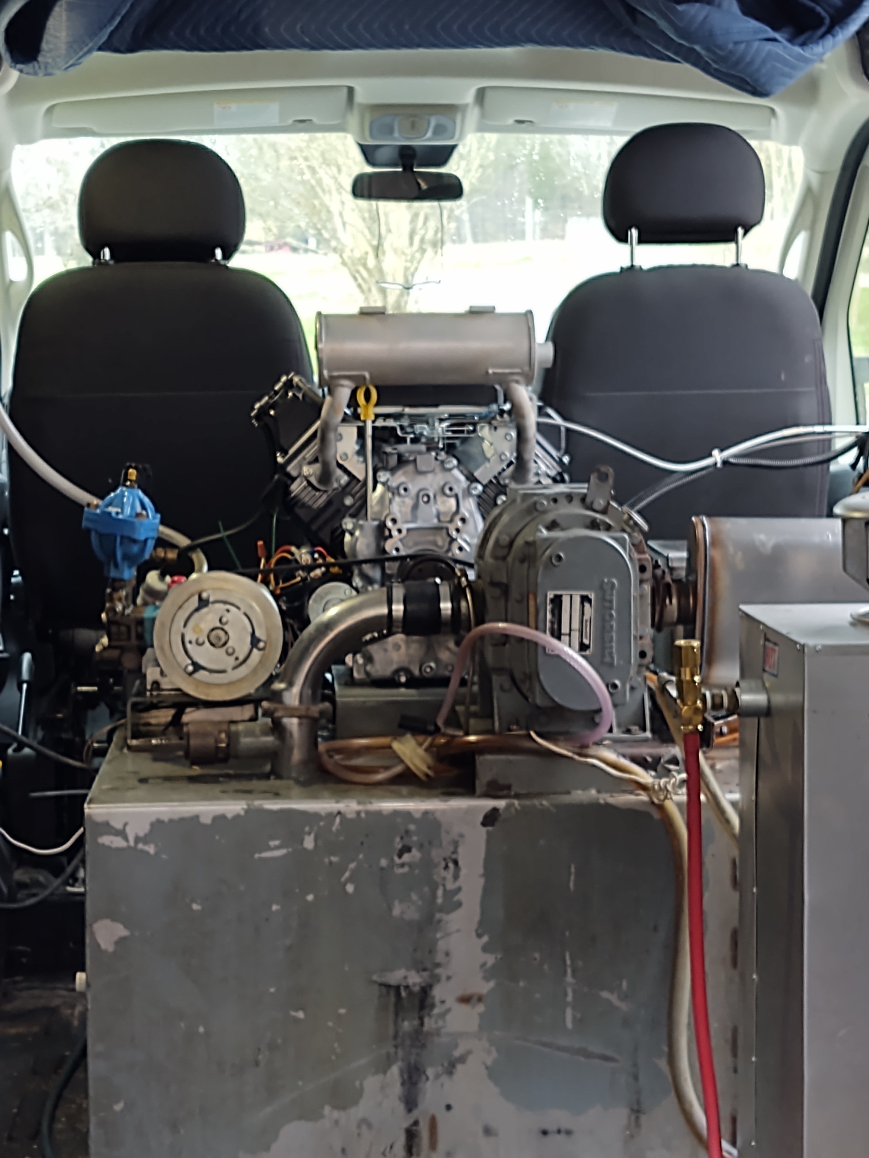

So my Judson TNT is about ready for a new engine.
I have been through 2 Briggs and both a rebuild also.
Currently stock is a 18 hp Vanguard.
Looking at the 22.5 Kohler Command Pro.
Anybody now if the Kohler is significantly larger than the Briggs?

If it's a coupler connection, you need to check the shaft size as well as the physical size of the engine to see if it matches up.

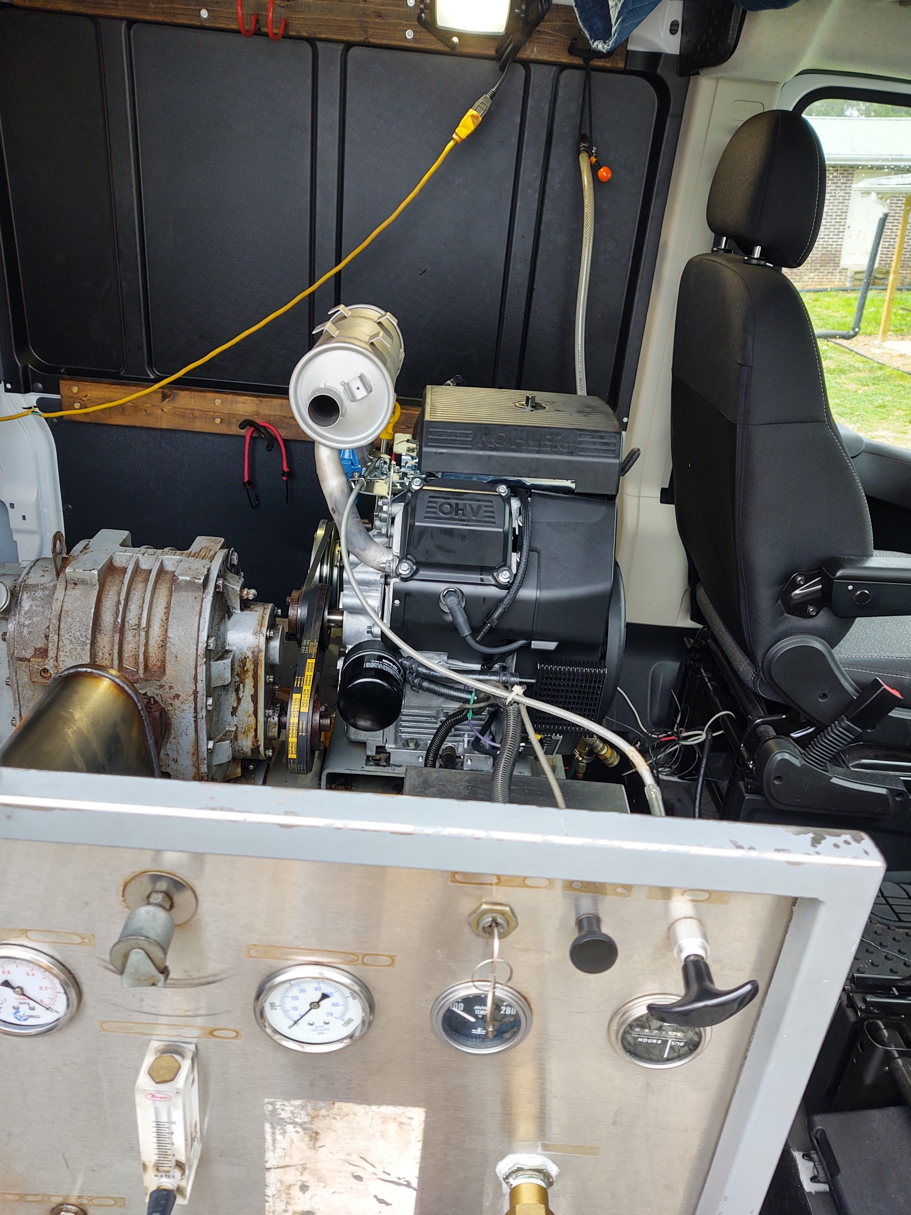

Swap went good. Needed new mounting holes so engine would sit back for pulley alignment.
Made a mistake on template placement so did 4 practice holes.
Need to source some 1 3/8 in flex pipe so exhaust doesn't mess up me hair.

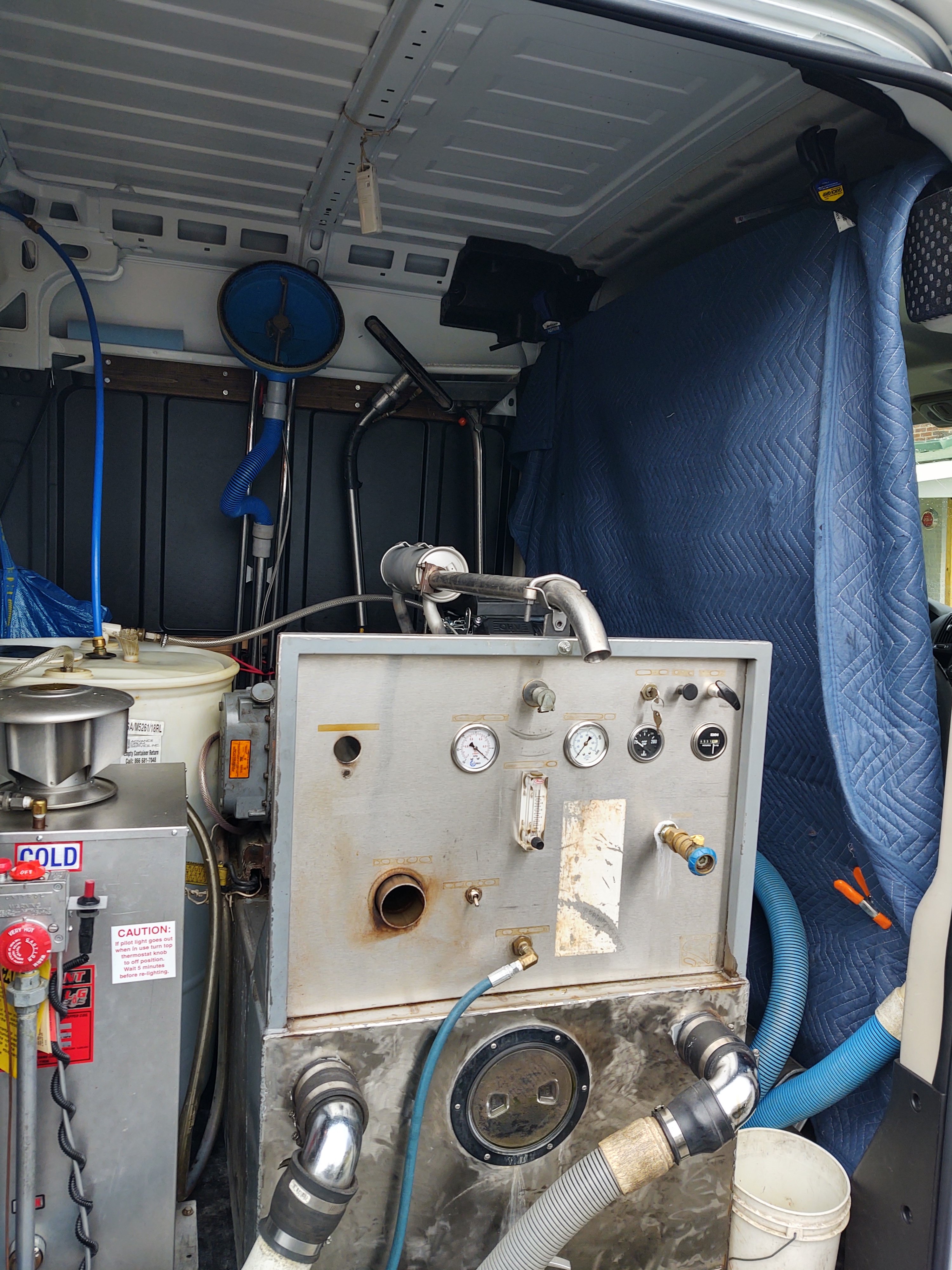

I’m glad that’s not blower exhaust blowing crap air on you. Maybe turn it pointing to the left
13,732
Georgia
Oh, I see the separate blower exhaust IS blowing crap air on you. Get another pipe for that also

You are going to smell like exhaust fumes every house you go in, in just the time it takes you to start it up and adjust your chem feed and such. I would look for a different route.
