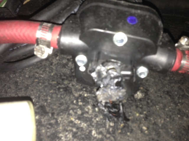

Well 100 hours on new FloJet transfer pump and at around 10 hours had to replace the switch, then last night I go out to a rank smell at the end of job to find the switch on the FloJet pump on fire! What a piece of crap! So requested they replace with a Mytee C361 this go around.

ARt I'm sure it could be done. I'm not a mechanicle engineer but I suppose the reason for pumping to the water box is to have a place for bypass hot water to go. I do have an outlet for warm/hot water depending on the day to mix chemicals in the hydroforce. If switching pump brands doesn't fix the problem I will switch it over after the warranty period runs out. The pump is about 1 inch higher than the fresh tank outlet but thats about the same with the V so I'm sure it would work.

So Art I think what I get from what your saying is that as long as the pump is primed it will even pump "uphill" however for start up it would need to at least have the pressure of the fresh water tank pushing the water to the pump to get it primed. It is really not a big inconvenience except at some places in the winter they will turn their outside spickets off to prevent freezing, so if I were to run into this with the supply pump down I wouldn't be able to perform the cleaning. I might just figure out a way to have a back up hose rigged to where I could hook the fresh tank line straigt to the pump and not even have to run from the spicket. Your giving me some good ideas for down the road.
Lee, this is a general pump also, so maybe that is the reason..
Art, I just realized another reason they are using a transfer pump. When I have it in the pressure washing mode at 3,000 psi using natural pressure probably would not even begin to supply enough water. One thing I like about this mytee pump is it pumps 5.2 gal per minute where the Flojet is 2.5. When pressure washing I always hook straight to the water sourse as to not have to stop occassionaly and let the Flojet "catch up" the waterbox.

This has been mentioned before but a cleaner who i cant remember has a video on youtube running the pump without the switch.
You just run a tube from the entrance side to the exit side of the pump with a shutoff valve in the middle set to half closed.
So i tried it instead of buying a new switch. Works great.
