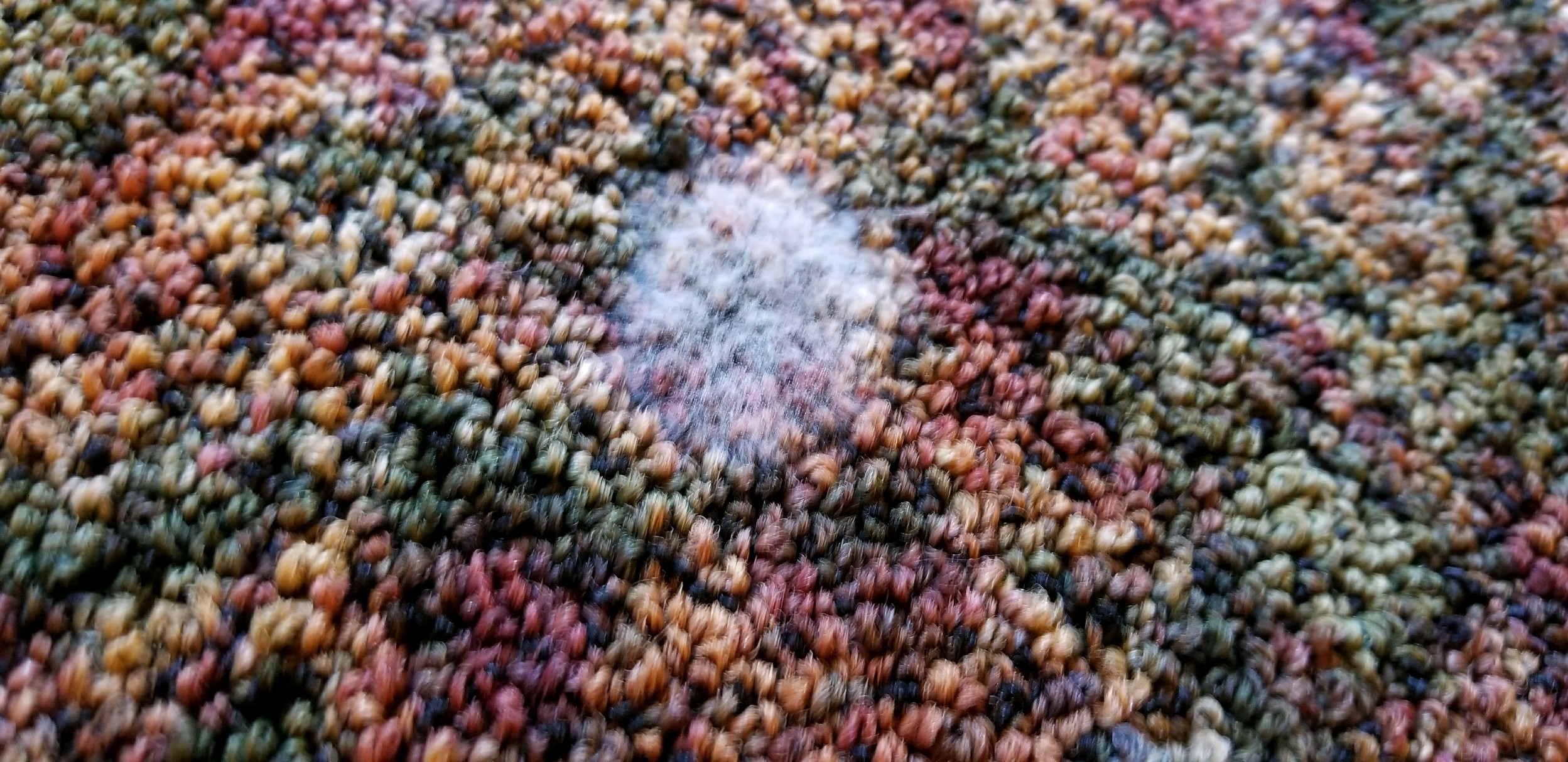

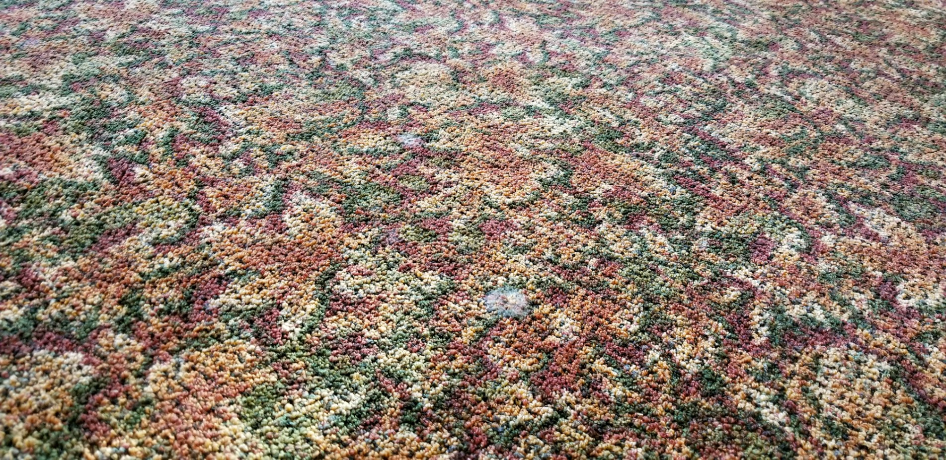

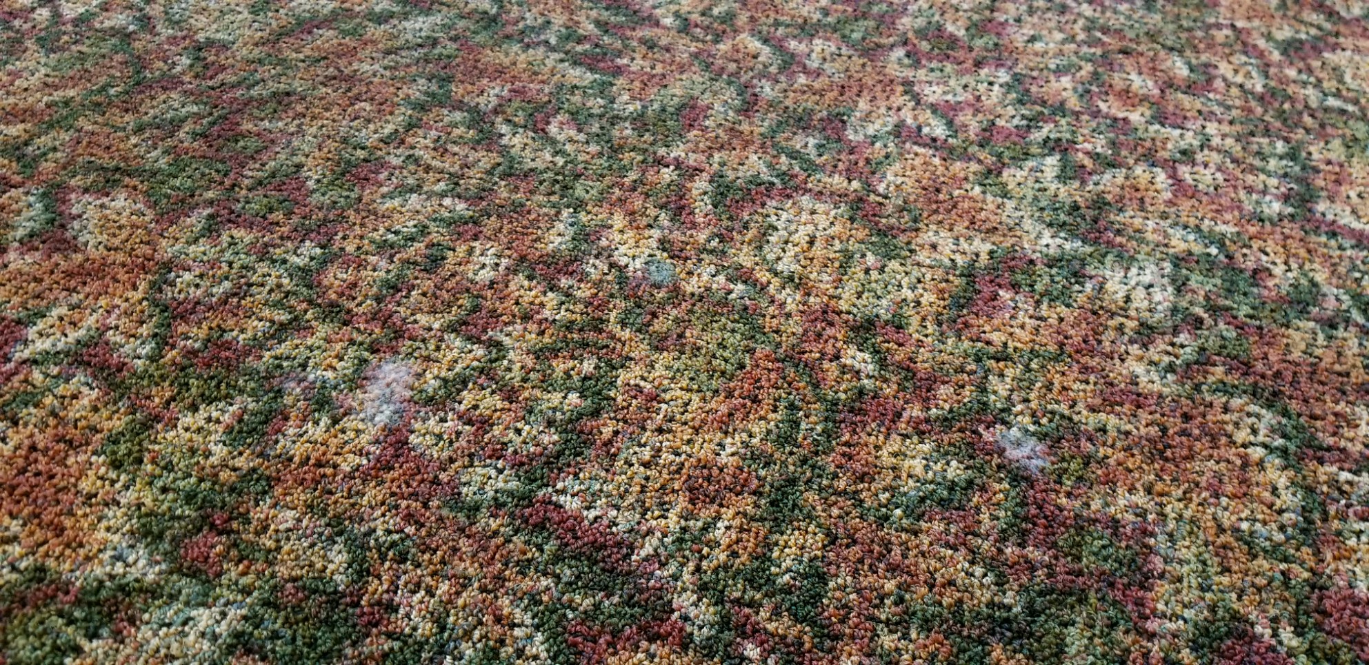

Carpet was Cimex'd with Releasit ds2
These white things showed up over the weekend
Mold
crystal (likely not)
Drop some water on it and see if it dissolves
S
Steve CGD guy
Foam from the tank that ran down the side and was not scrubbed into the carpet.
looks like fuzzy mold to me
was the 'mex parked there for any length of time to pee dribbles?
Zee
Nov 2, 2007
6,196
I've seen leftover foam clumps dry in that fashion.
Probably of something there that the mold used as a food source. Syrup???
Zee
Nov 2, 2007
6,196
I find myself doubting the idea of that much mold growth in what sounds like one to two days.
117,375
Yes, Mold.
It's a Science Camp deep out in the Scruz Mountains.
We've Cimex'd it 8 times and never seen this before..
My first thought when they sent the pics were Gummy Gel residue but there were far more white spots than my guys said there were gum wads.
Upon further interrogation it turns out the Jr High Schoolers do something call Garbology in that room now, so what ever festering mess was spilled, stayed alive...
We suggested they either put down tarps are be prepared to pay for HWE..

If memory serves me right, Host for a while (long time ago) had this issue.
11,013
Just wanted all the innocent newcomers to know that life some time can be, well........ruff. :winky:
And it goes with the avatar.
I think it had to do with the corn husk base and the amount of water. Organic matter, water, not a very good flushing.....

Yes, Mold.
Pump up with straight vol. 40, and a few oz’s of ‘cide for good measure, dwell 45-hr, HWE with Clean Free, or Procyon Extreme, scrub the shyte out of it with CRB, maybe a little defoamer for good measure?....
Never.
It's an isolated incident. Very odd!
Seen it many times in basements that get wet and are allowed to dry naturally. Never from encap cleaning.

Never.
I cleaned an apt. Halls and stairs. It was 14 months ago. Used CRB, and DS2. Manager called, wanted to book, says the halls ‘stink’. NEVER had a complaint when I’ve HWE’ed..... scampoo? Who knows.... humid environment? Maybe.....
