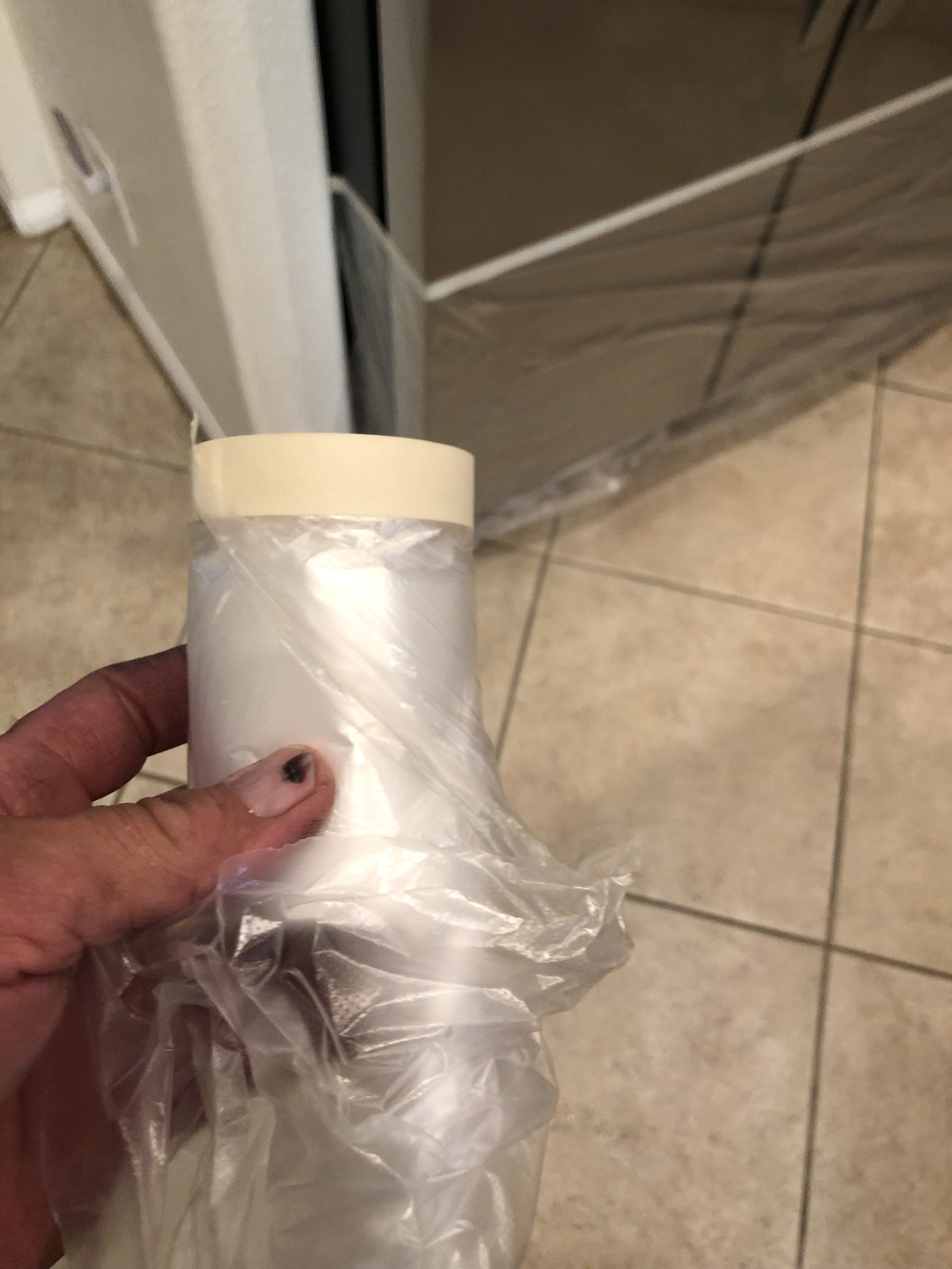

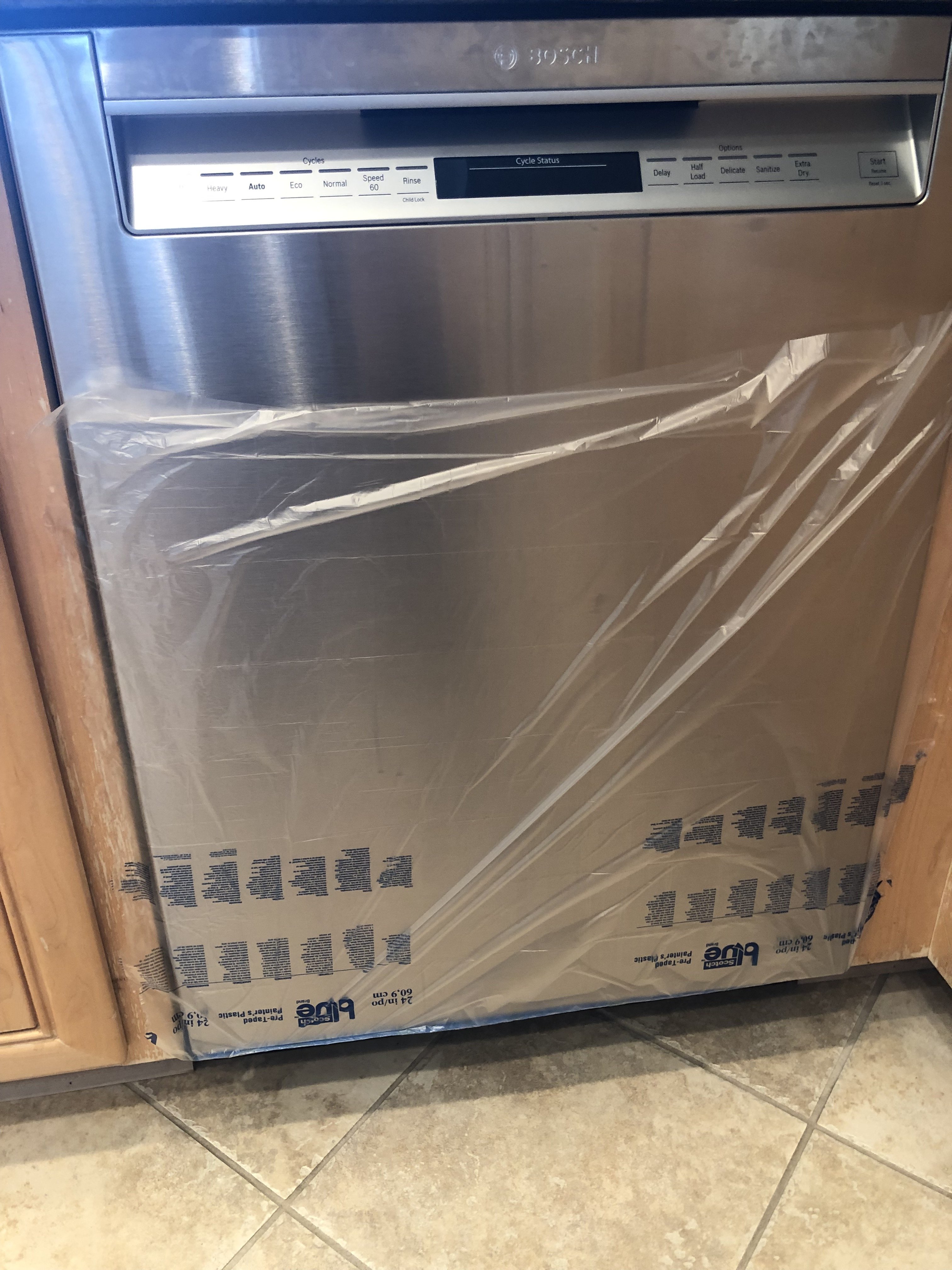

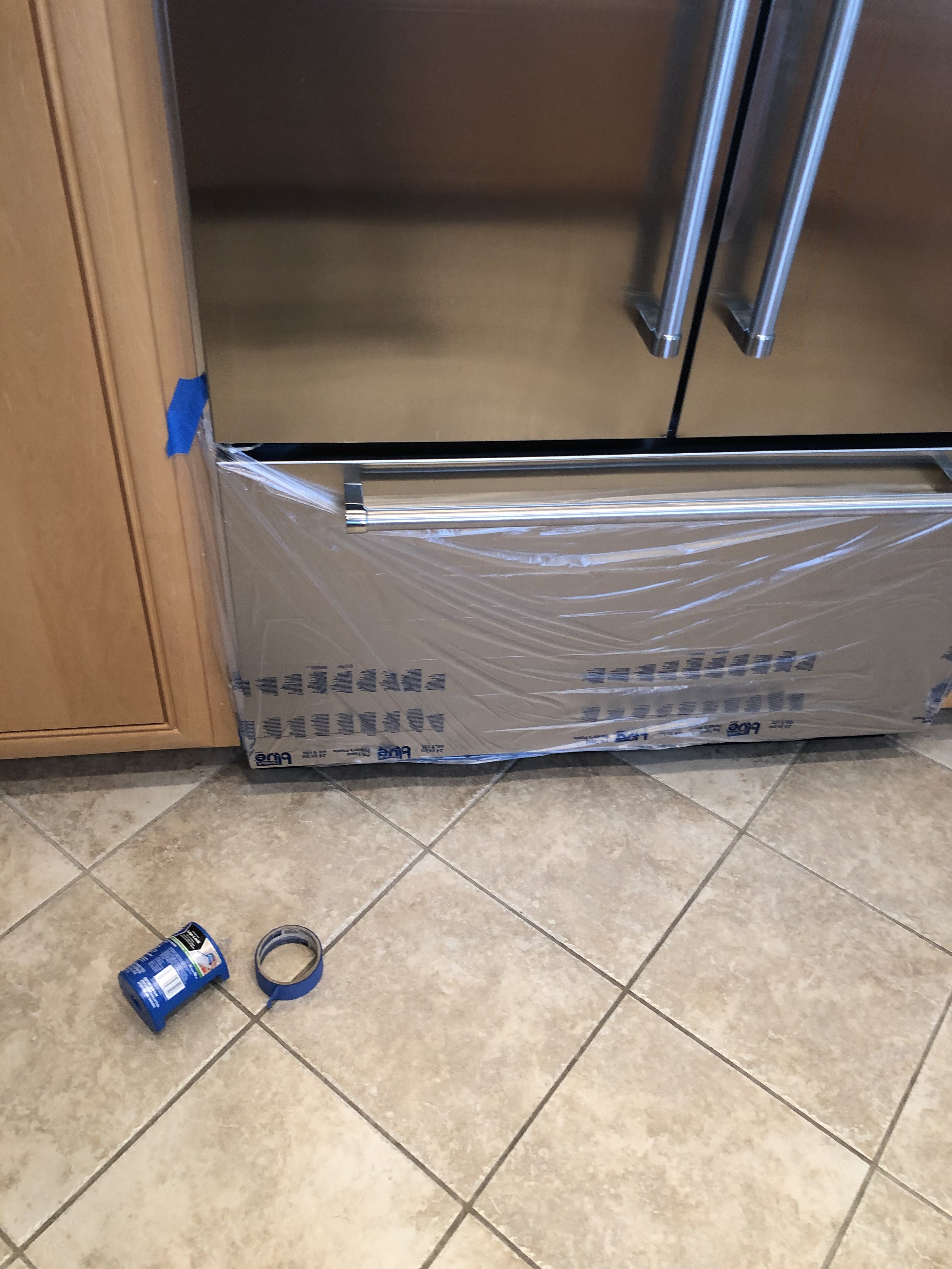

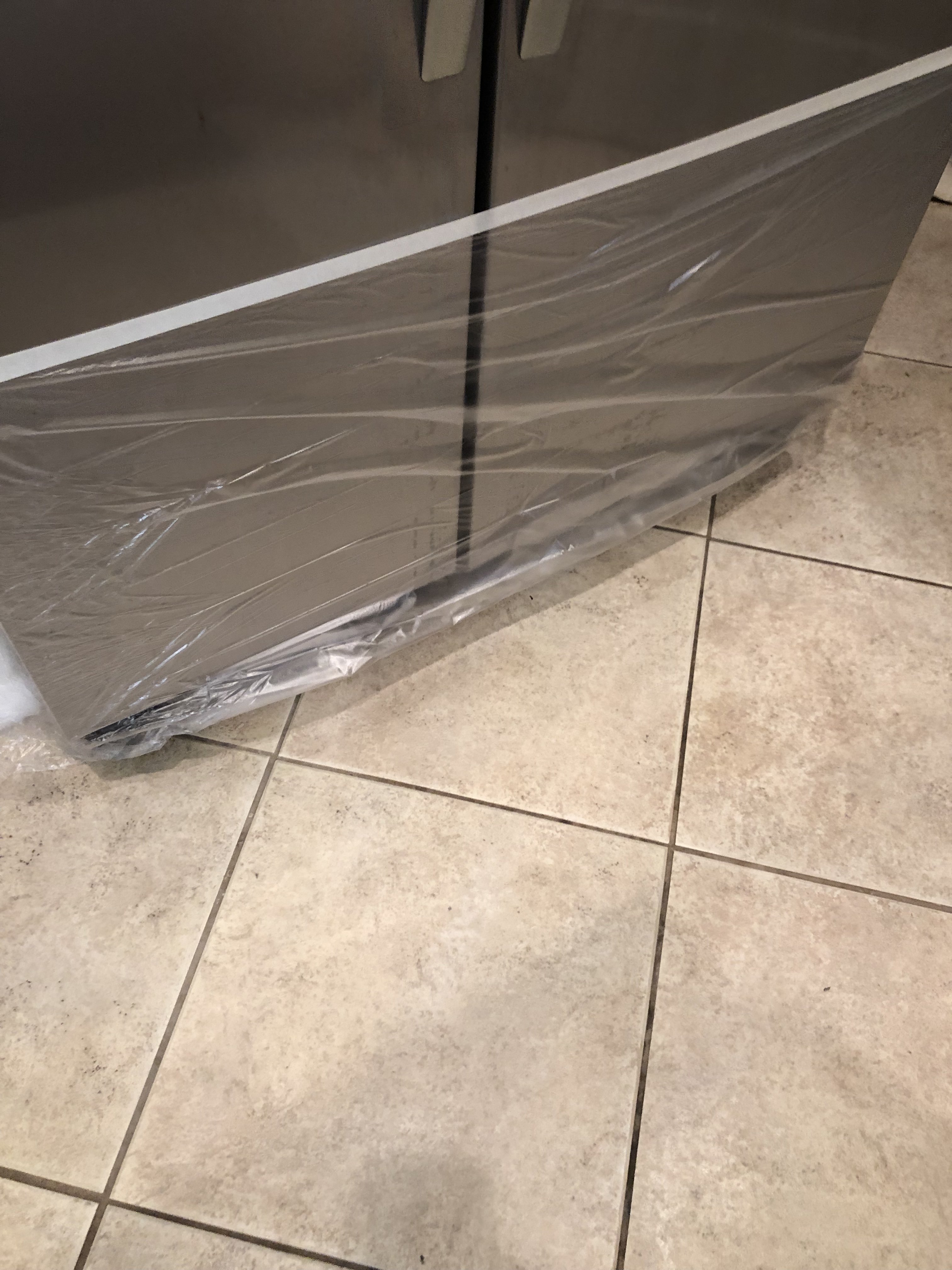

Turn it upside down, tape on bottom underneath the lip. The plastic will cling to the fridge. Add a piece of tape on each upper corner on the sides of the Fridge to make sure the plastic stays in the event your tool wants to suck the plastic. This way there is no chance of the tape leaving a slight film on the stainless.
thats the way i tape also
