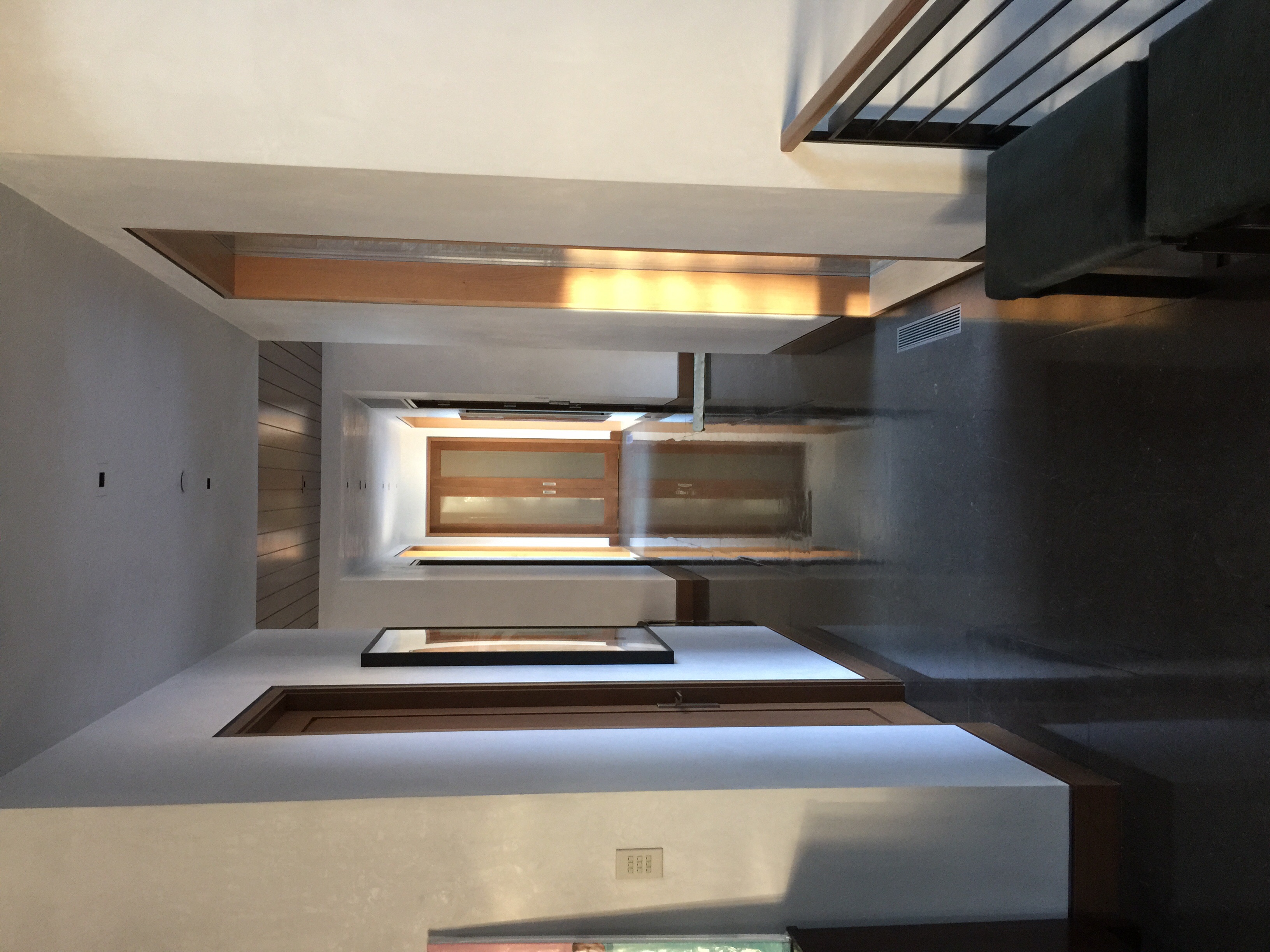

Terrazzo floor with several years of mopping glow
D
dwellpro
I can get the mop and glow off without a problem. I'd love a little help with getting this terrazzo to shine. Any suggestions?

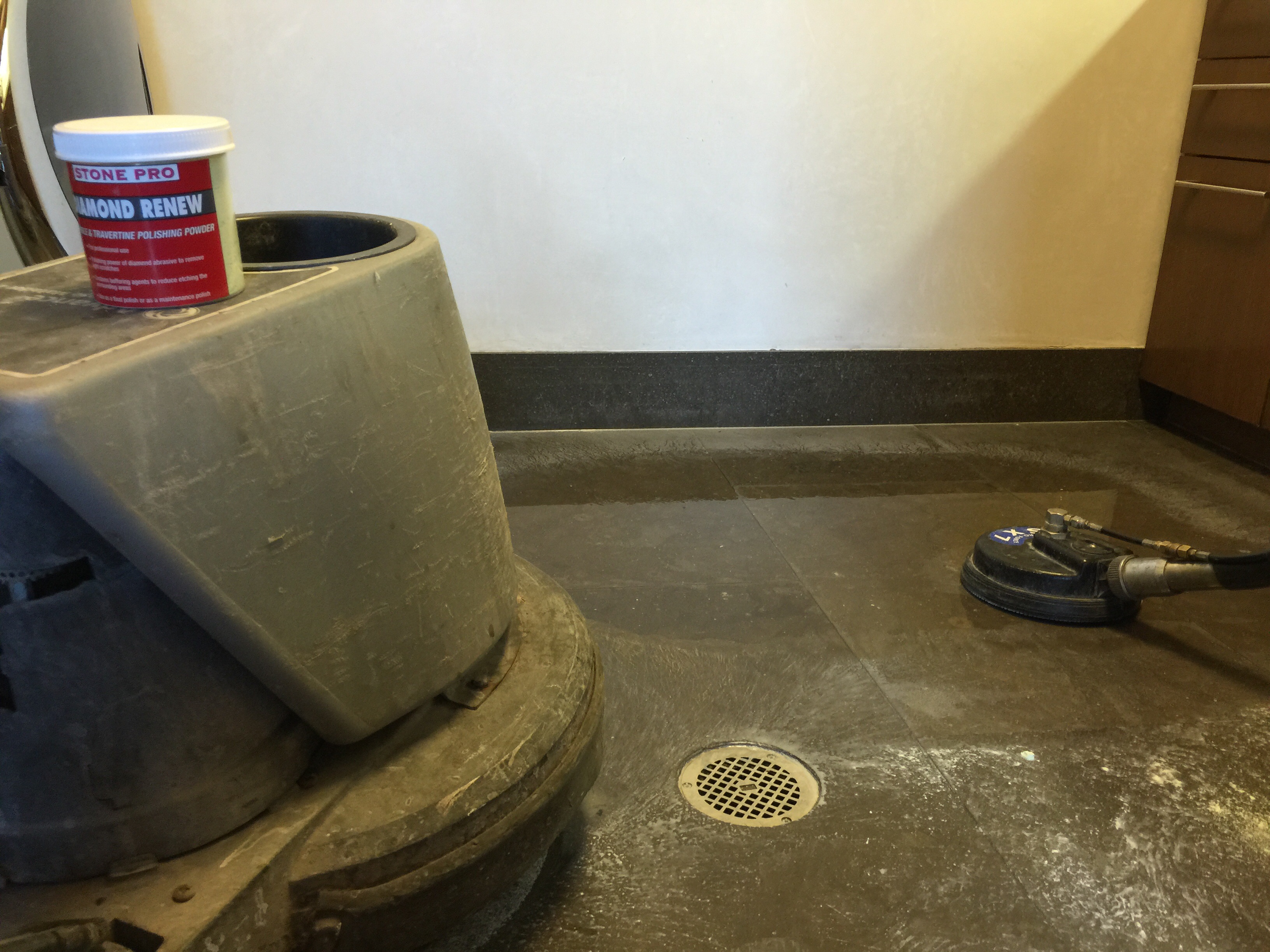

Tried Diamond renew with a hogs hair extreme pad. Looks better but not where I want it. My buffer is not that heavy. Do I need a lot of weight?
I'd think you'd have the need for speed too. Wouldn't a burnisher do better or is your buffer high speed?

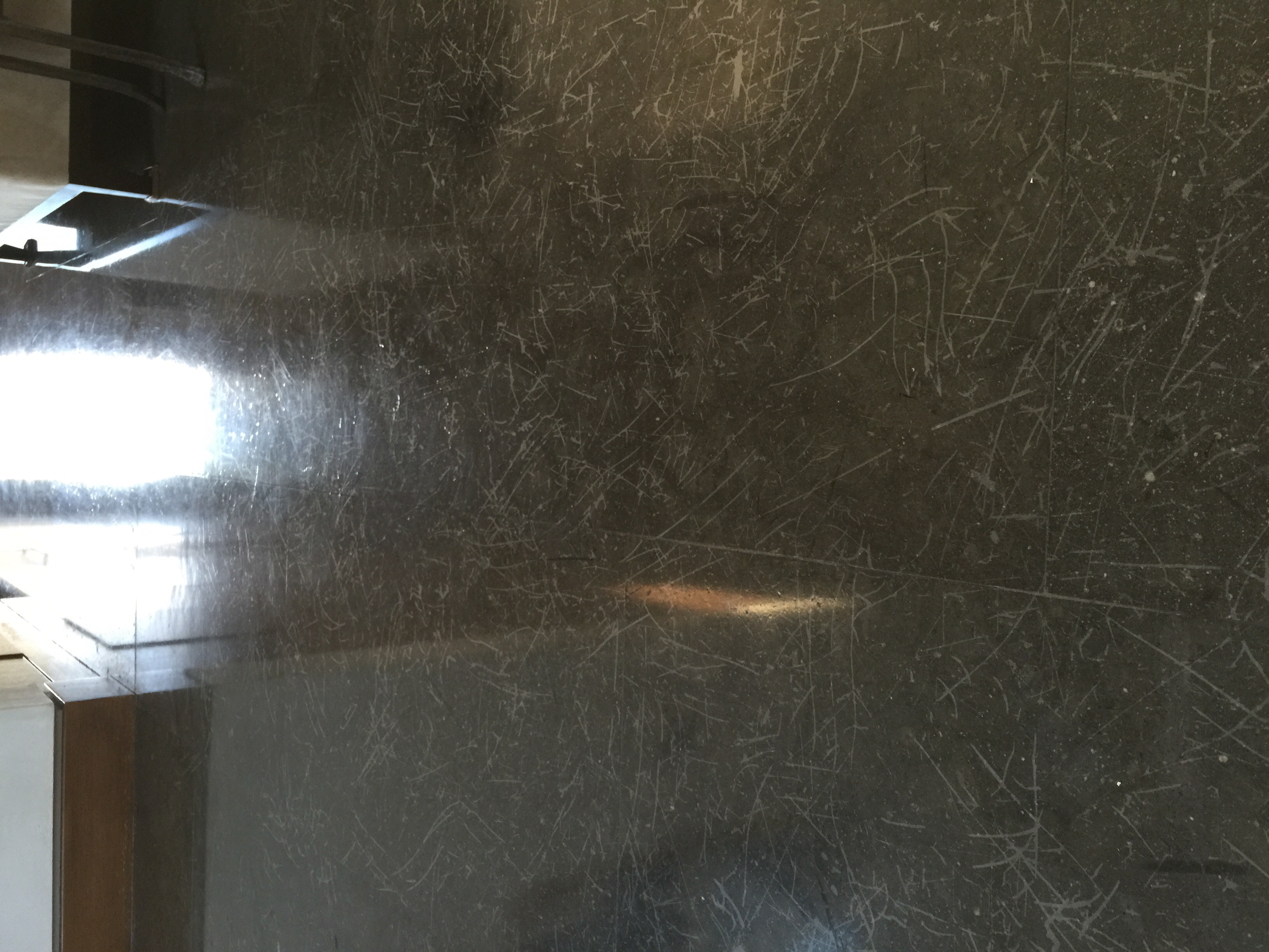

You need diamonds. I would strongly recommend mb-22 over diamond renew for terrazzo.
Regardless, it's going to look like dogshit either way unless you diamond refinish it first

With the Mop 'n' Glo removed, it should polish up well with diamond pads - Monkey pads / Spinergy pads. If the surface has been protected with the finish, a 5000 or 8000 grit would be a good place to start. If there are more abrasions, you would need to drop to a lower grit pad.
Not a difficult job with the right tools. You would want total weight of 120 to 140 pounds for your buffer and any weight added (Assuming 17" to 20" size buffer).

Mb-22 works great! Actually an M3 pad on a burnisher is the easiest. Running it dry. The surface is virtually scratch free due to the topical I removed.

Client wants no chemical on it whatsoever no sealer. Solution with wonderful results has been MB – 22 with Hage's hair pad. Followed by an M-3 pad dry under a burnisher.

If customer doesn't want anymore coatings put on your would have to use diamond pads to properly refinish the floor to physically prepare to accept a polish...since just polishing didn't do anything:(
