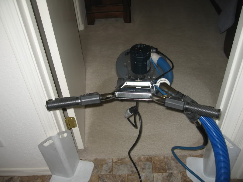

Finally ran into a job that was questionable as to if I wanted to pull the 700 off the truck because of a few bad seams and one of the worst bond inserts I have seen in awhile...but this carpet really needed a good flushing out..and it was a good chance to see just how it would handle the issues...so I told the owners that I was going to flush it out and if there was any problems...I have a guy that does all my repairs for me and I would have him come and fix anything that it pulled up...she was happy with that so I went for broke on this one....
this bond insert was not really done right...and you can see down at the bottom where the knife must of slipped and they cut to far both directions....
I did 4 passes over this to see what it would do..( trust me I had my eyes closed all 4 of them ) I was really expecting this to rip...It did not even try to give and it never grabbed it...
the seam was loose and sticking up...
I did 2 passes and it did not grab it or pull it apart....
I ran it over the edge of the carpet..Probably a little more then I should of...but it gave me no problems..
after the pre-vacuuming the filter was about the size of a soft ball with sand and hair....and this was all that was stuck to the bottom of the machine...nothing was clogged...
Edges nice and gets under things with no problems...
and it has no problems flushing the crap out of the carpets...
the only problems I see is that the hose connection need to be more at a down ward angle to help getting into door ways...
and I think the nozzles need some way to flush them out when they get clogged....
I am done testing this thing and I will be shipping it back in a day or two...
I.M.O they did a good job on this...it will have a long life...it is easy to run..great recovery..you get the flush and the penetration all in one shot...and it is easy to balance with your machine...I never lost a bit of heat...and the steam is contained in the head...
