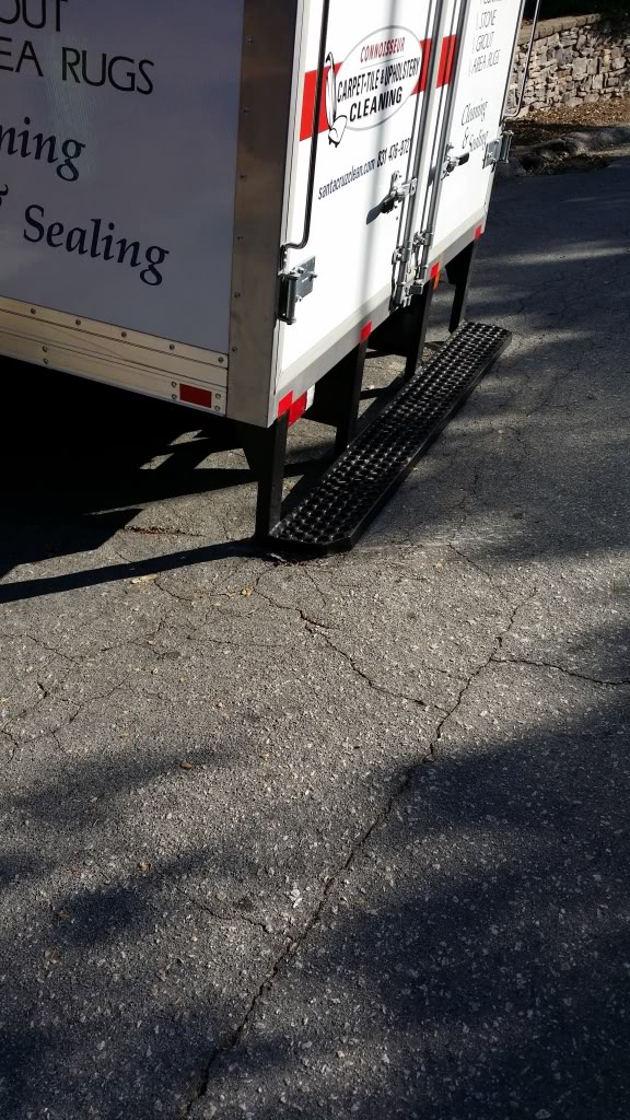

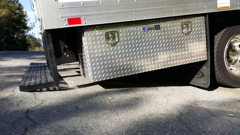

Mike how is that box behind the rear wheel working out? does it rub on some steep drive ways? how about putting one between the front and rear wheel?
funny you should ask...

Mike I had a few bad driveways with my V. Grabbed some leveling 2x12's from the camper. Laid them out front of rear wheel to raise it up just a inch or two.
Cut the ends at 45's so it rolls up easier.

The dude I purchased my V from lived up in Sacramento. He had the rear step cut and raised up a bit because he said he couldn't get into a lot of the driveways in his area.
