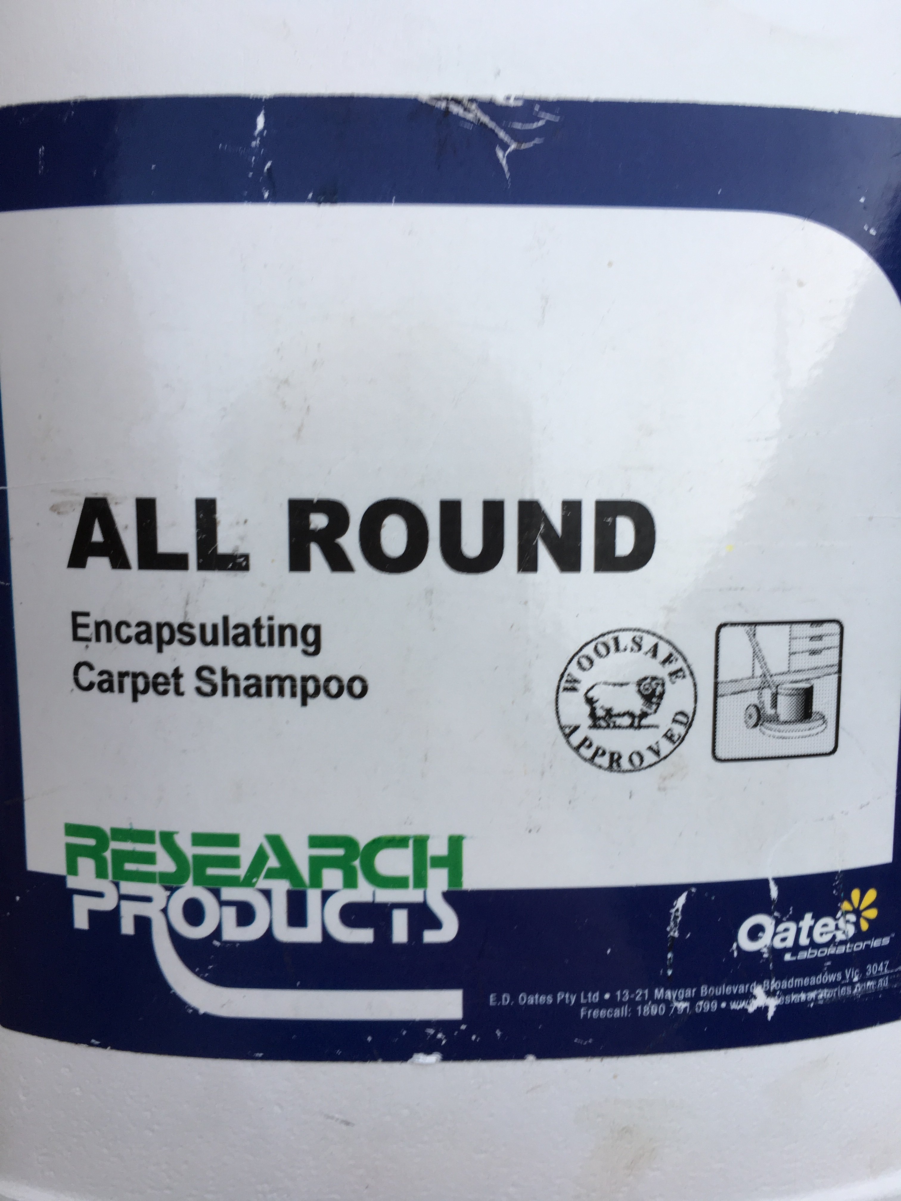

What encap juice is that Grant?
Australian made product called All Round.
