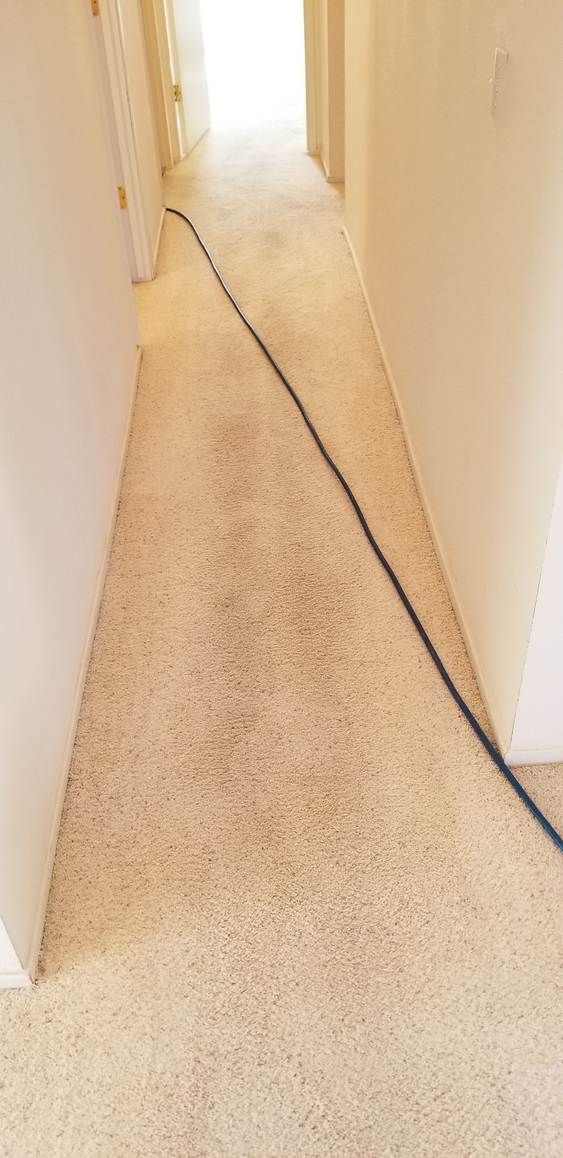

The last idiot left this wet for 3 days...
117,366
I just did one with dark edges that I took to be filtration.
Now I think that the tack strips were left wet by whoever was there before.
117,366
Ask @Derrick T. What one would haveto do to createv that long of a dry time..

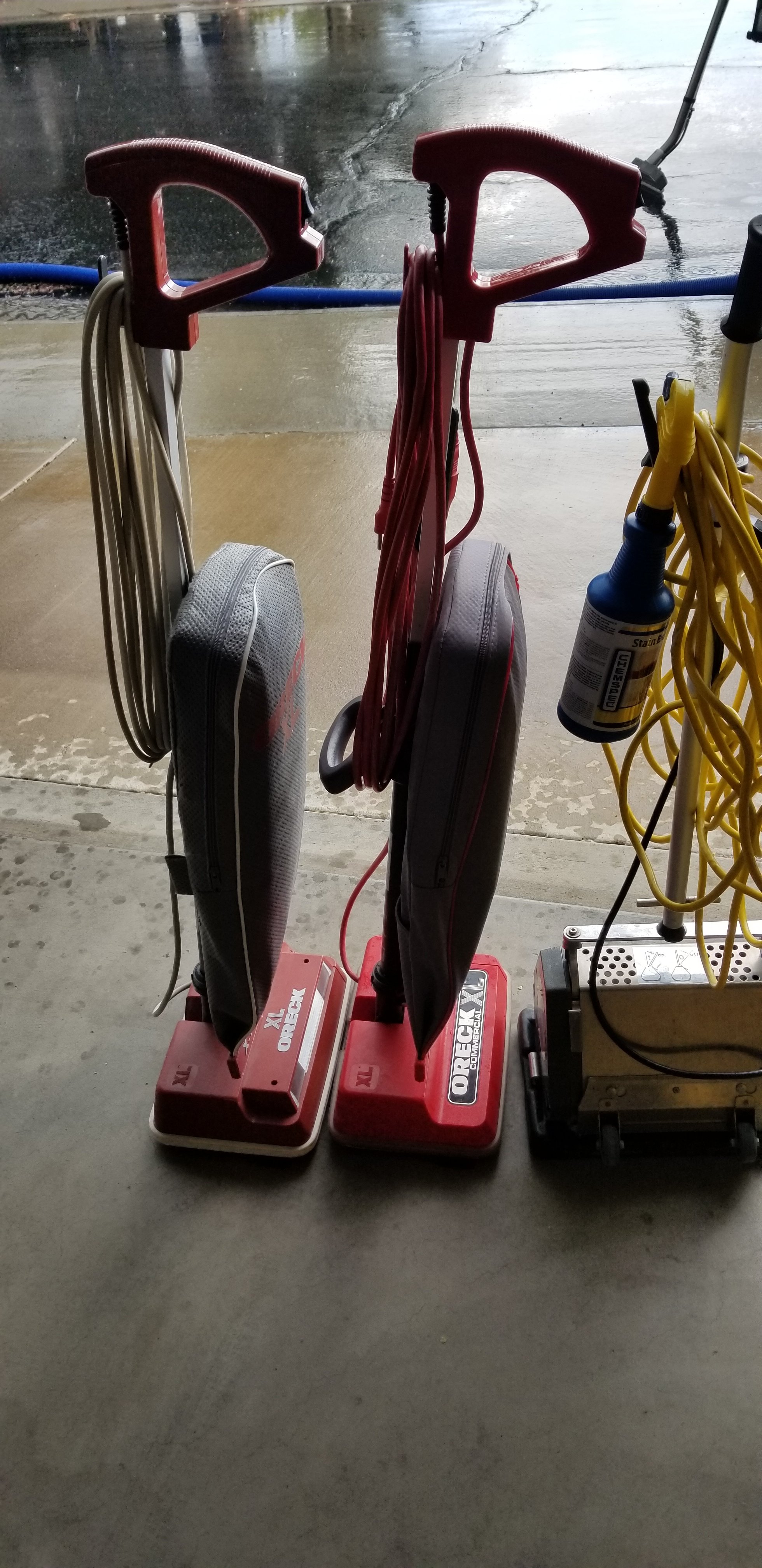

I got a free Oreck for doing such a nice job...

you do wonder how some manage to do that, I dropped off keys to property manager few weeks back (I'm not there preferred supplier) she made the comment I'd get my carpet cleaned more often but I hate having to move out for few days till it drys.. :hopeless:

Bill Cheryl
Plugged filters
Vac relief setting way off
Damaged lid gasket
Way too much prespray
Way too much emulsifier
Crappy wand
Too much pressure and or flow
No dry stroke
No wand skills
Yeah thats what i was gonna say. So many variables..
14,644
Nah even worse, was halfway through last job of day dead on my feet didn't even notice till looked out window at van and puddle accumalating under it..
full retard moment :redface:
Did you have earbuds plugging your ears with music so you couldn't tell the sound difference of your suction?

nah had real crappy wand back then with 1.5" whip didnt sound any different that I noticed, dump valve wasn't fully open either
28,280
I had a call like that once. Lady calls me on a Sunday, had the carpets cleaned on Thursday. She asks me should the carpets still be wet? I tell her no and since I am in the area, I would like to stop by and have a look. I bring in my moisture tester thinking I will find a little dampness. Not necessary, the carpet was still wet to the touch. They also cleaned a pink velour sofa. I lifted the cushions up and they were moldy on the bottom. The companies name was Dynamite carpet cleaning. They blew that one up good.
11,567
Plugged filters
Damaged lid gasket
Crappy wand
No dry stroke
No wand skills
Closed house no ventilation wouldn’t help either
That would be my concern, how much water would you have to use to achieve that goal?
Especially in the desert?
