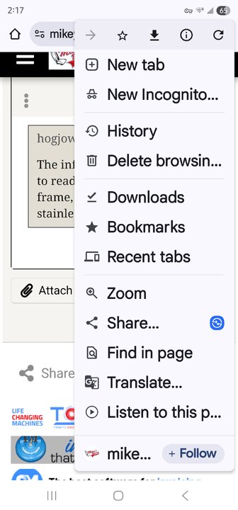

The information is too small to read on my phone. Are the frame, tanks AND REELS stainless?
Try the zoom feature.

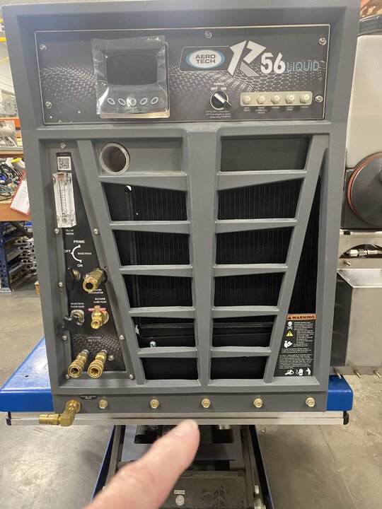

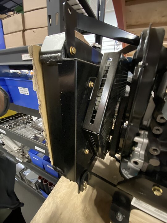

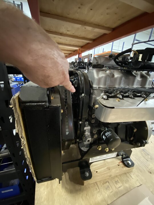

Does that PSI engine have a timing belt or timing chain?
To remove the panel there are bolts that hold the along the bottom and sides. Notice that the plumbing section of the panel will stay in place. Then you remove the bolts that hold the radiator in place then the radiator will swing out and away. Now you remove the bolts holding the cover of the timing belt. Wayne has tested the time it takes for this process and said it’s a two to three hour job. All accessible from the front.
The thing with PSI is that they are not the engine manufacturers. They take the engine blocks and build out the engines from there. This particular engine is a GM engine. The way Wayne explained it to me is that if the belts do fail it will not damage the valves the way this is designed.
14,611
2-3hr job is normal for a replacement. I like that they used a GM engine and the heat shield over the manifold has improved since my psi GM model engine was made.
I like that it's all accessible to the front since the basket filter and tank are on the right side. I was wondering how easy it was to remove that if it was needed access from that side.
Thanks for showing us up close access to it.
Is there any future talk about shifting over into Kubota with a timing chain for less of a need to open up that area of the engine once the first run of these machines is sold?
View attachment 130836 View attachment 130837 View attachment 130838
I believe that would be called a non-interference engine.. Which would be an awesome thing..
