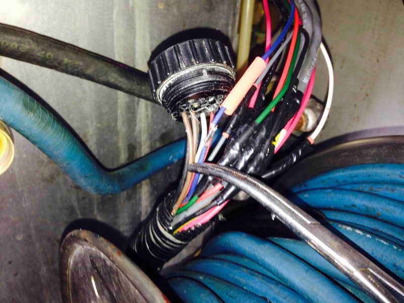

Mikey, I finally got around to by passing my 24 pin connector yesterday. It quit mid job on my son the other day and all the wiggling in the world and I couldn't get her to power up. So I knew it was time for the surgery.

I replaced that idiotic thing years ago.
By doing that and putting the exhuast diverter solenoid in a sealed box I got rid of a lot of headaches.
