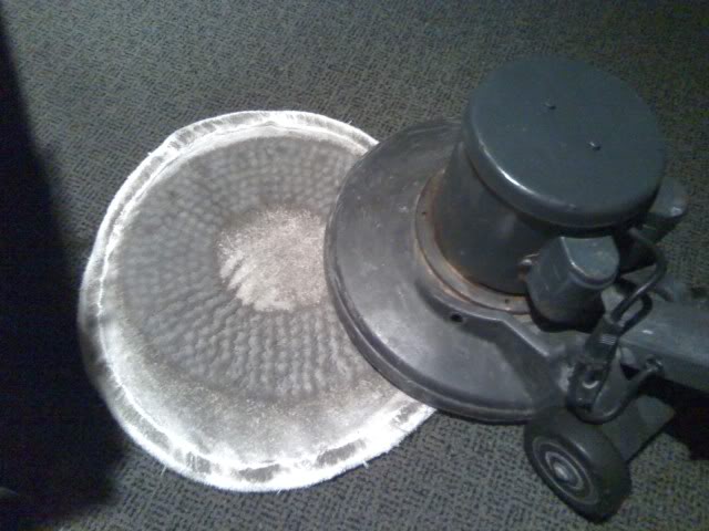

Dirty and Abused Olefin and Nylon Glue downs.
Cleaning Step One.
Pre vac the hell out of all areas. Pay attention to entry areas, pivot points and around plastic chair runners.
and get up the cob webs paper clips and dingle berry from under the computer cords and cables.
Two.
Pre spray with a well formulated juice that contains a degreaser and some peroxide. Don't soak the carpet two light passes with a HF will do. and scrub it in with a broken in REd Fiber pad and your 175.
Three.
Use a pimped out TM with as much 2.5 hose as possible. Ditch the 1.5 pussy whip.A 2" wand with four to 6 jets and a glide is the most effective way to wow them. Those RDMs and Rx 20 do clean up against walls and under desks for squat.
Four.
Dry stroke till you puke.
Five.
Most important step. Use that same 175 and some cotton or cotton blend PADS to go over and over the heavy traffic areas until you once again puke. No matter what pre spray you used or what toxic rinse you purged it with you'll be amazed at what is still hiding down there.
By post padding heavily used CGD you'll pull up soil that no single method alone can get up. You'll run into some areas that will never come clean. Use at least six sides in those areas.
Creating Michelins is the insiders name for this step. use both sides of the pad.
Hurby, Vac A Way and Guerkink have these pads for sale
