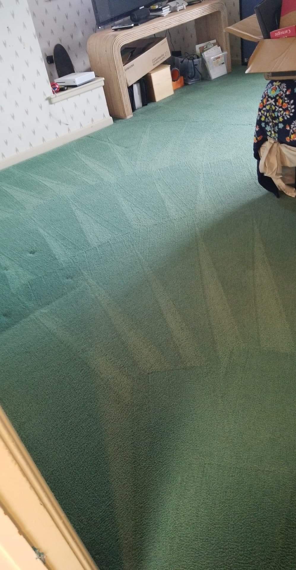

The swirls
It's the metal boots. Temp around 230-240.
Guess we need to back off a bit.
Thanks!
You're welcome. You may need to reduce temp more than just a bit as the metal can get quite hot. Just experiment with different temps and also with how long you hover in the same area.
I find some carpet can take a set just using household hot water. Mike nailed it: 360i in, wand out. Groom immediately if the swirls still show.

I agree with the comments above. A CRB can be used (while the carpet's still damp) to remove the swirls.
