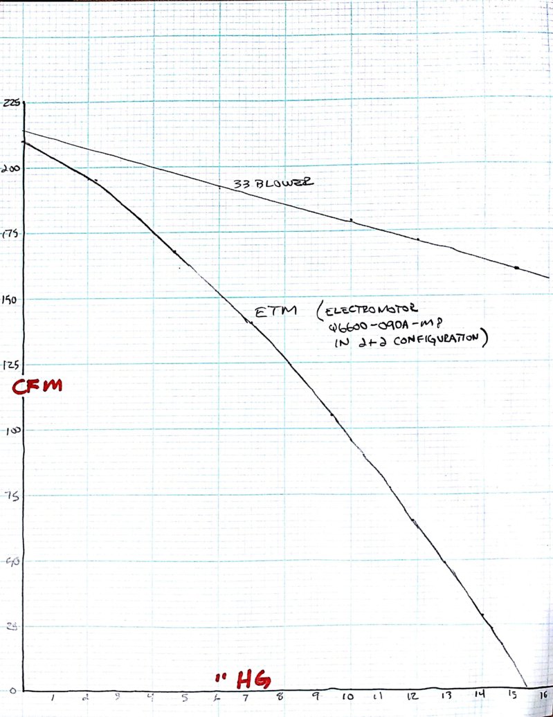

As a builder of some Electric TM's, I would like some clarification on how the X-drive is 100 times the power of the Mytee ETM, which has equivalent vacuum to a #33 blower, General pump @ 900 PSI, 35 GPM Pump-Out and HX from the Van cooling system.
That would mean it FAR outperforms the AeroTech, Mikey.
I don't think so !!
This continues to astound me - just because the electric vac has similar open flow and sealed vac numbers we try to say they are equivalent. It doesn't work that way. Here's a graph comparing the two. They are indeed similar - that is until you hook up hoses, wand, plumbing and such... then the curves diverge pretty quickly.
Yeah....it sucks for them when facing actual numbers..
