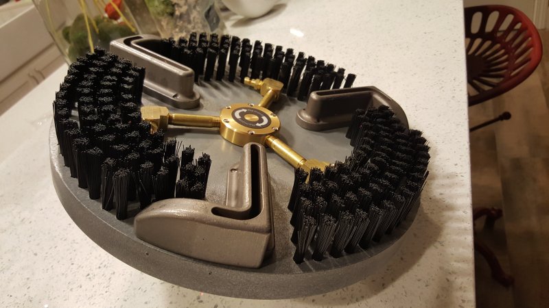

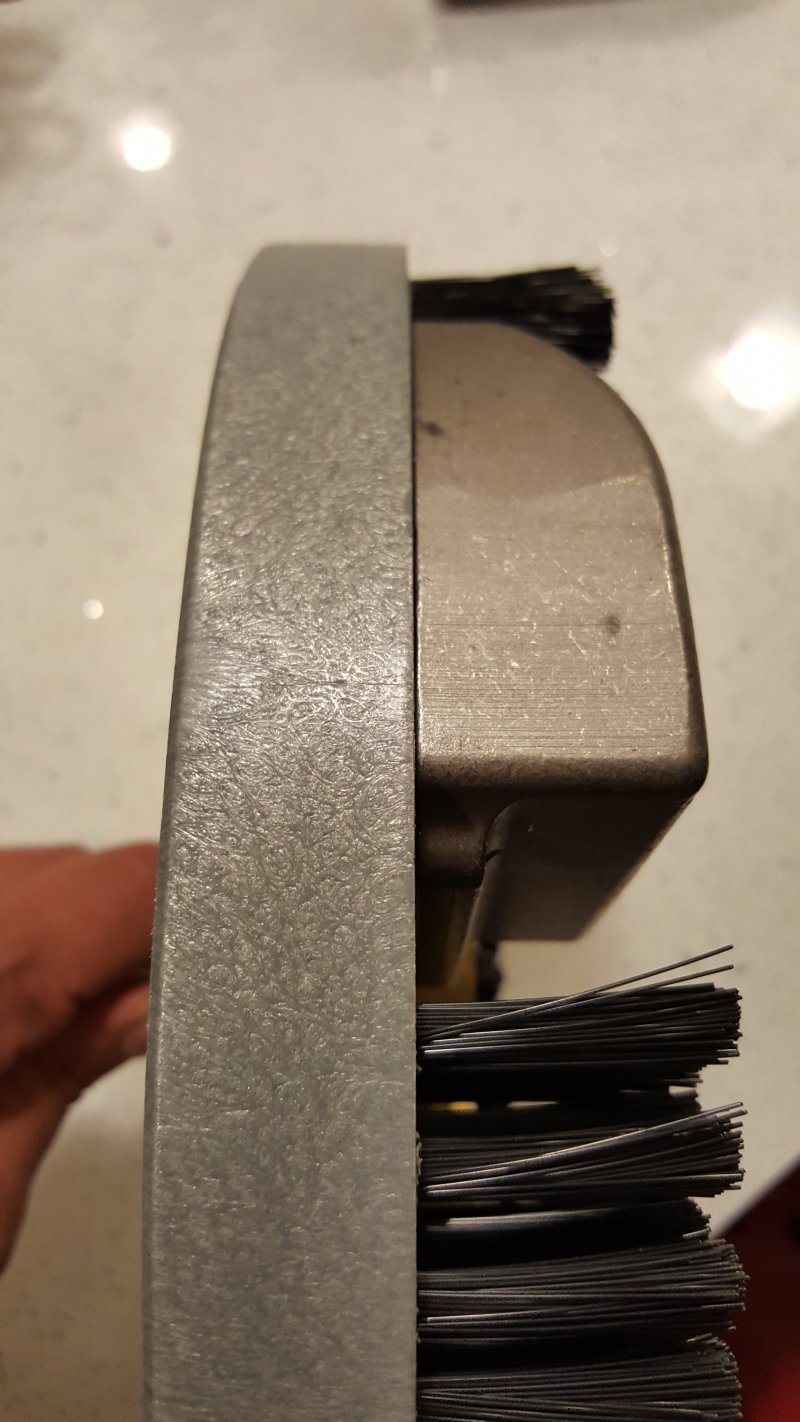

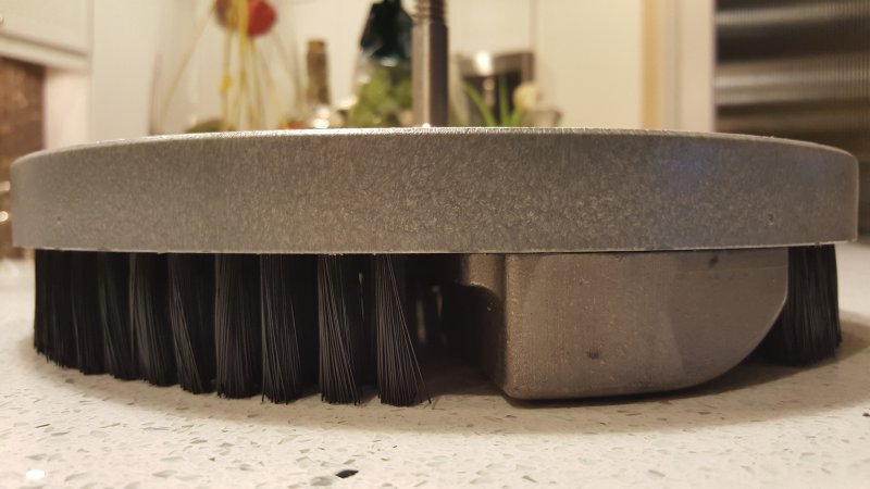

Notice all the room between the three shoes for the bristles to get jiggy with the carpet.
Also notice that the bristles are longer than the shoes..
And pay attention to the quality, consistancy and "denier" of the brush..
My guys used the XL today for the first time. The next revolution has begun.

What is the "diameter" and material of the XL bristles ?
T-Rex brushes are Nylon, 20 thousandths in diameter . . .
Since they are replaceable, they can be installed at any height.
Adjust-A- Glide Shampoo are 22
The nylon shampoo brushes we sell are all 28 thousandths.

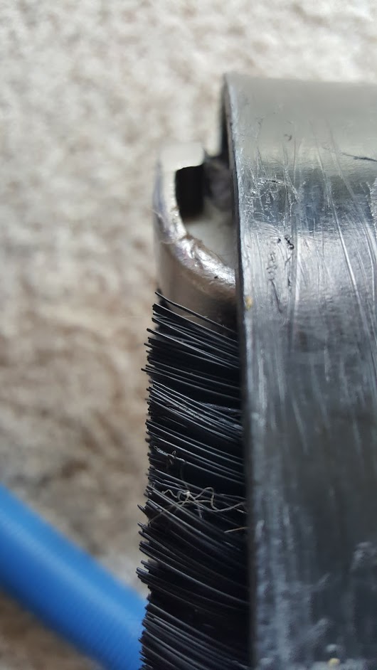

I think we will still get a fair amount of agitation even after the brush has worn to or even a little below the vacuum heads.
The (yes, light) weight of the 360i should cause the head to sink down and continue to agitate.
I believe this will be especially true on thick, plush carpet.
I do think the agitation on CGD will be adversely effected when the brushes wear, just because the head doesn't sink a whole lot on CGD.
I don't use my RotoVacs very much on CGD anyway. Not that it can't do it, it's just SLOW if dealing with larger open spaces.

Interesting how the brush length is shorter next to the shoe.
And longer back away from the shoe.
Maybe due to more flexing of the bristles.
