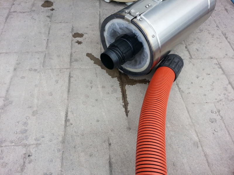

In all fairness Joes rc99 only leaks when You turn of the vacuum.
I like Toms design where the connection is lower it helps to remove more standing water that way
I usually leave my rc99 in driveway pick it up level and shake it in the dirt to remove excess water.
Mike You need a cfm tester, I used a Y and a rc99 and You dont lose but maybe 3 to 5 cfm out of 300 cfm on a 75 ft run. Im sure the devastator is about the same very little loss if any.
114,148
I know it only leaks when you turn off the vacuum Sam..
But that happens at least one time per job, right?
Just one more head ache I don't need from a hundred dollar gadget.

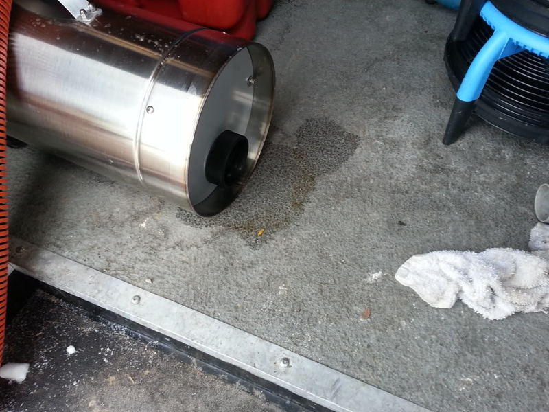

uhhh except the ones that have a trough, like the pool filter or the mytee one, where the water can pool...
THEY ALL LEAK....when the machine is off....
Every farving tool, gadget and what ever else is used has issues....just like cell phone providers, tv, cars etc....
it just depends on what you want to put up with...
Right after a job...i think i only tipped it a second or 2...to "clear" it
after sitting in the trailer...either going to the next job....or the next day...

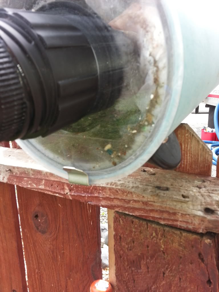

I have talked to a few people, and some of them told me I shouldnt post the pics????
Told them Mike even said give it a whirl against the RC99....
I will post some vid (dunno how good it will be, cuz something ALWAYS goes wrong when you try to do testing hahaha)
and a review on the 2 of them.....1st off....they are super close in 50% of ways, not so close in the other 50%...
in the end..its what you feel like you want to deal with....

Out of the back it is going to drain if you have a lot of debris from last job it is like a sponge, so if you don't stand it up and let it drain while you role up hoses and put you stuff away it will leak out PAST THE CUFF on the back.
Thats why I tell guys let it sit and make the Dev be the last thing you put away for sure if you have several jobs of debris in it.
As far as front leak looks like maybe adjust clip to put a little more pressure on gasket, You can just give it a little bend with your hand to push the clip down a tiny bit.
The smaller DEV has o oring and as long as the oring is clean when putting lid back on it may be even a BETTER seal than the BIG DEV.
I am perfectly fine with the pictures you posted. And I'm not going to blow a gasket, cut you off, tell you to go screw yourself, call you at 3:00 am in the morning over and over, or fix your filter if you need it to be done down the road, and you don't have to join a so called club to have it either.
I honestly think you can fix the leak in the front very easily with what I described above, as the gaskets get older they compress so the clips can be adjusted for this reason, and when they do wear down all you have to do is call and I will send you a new gasket.

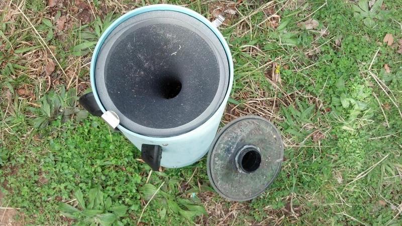

When I'm done with each job I generally disconnect the filter first and then let the filter sit up while I put hose away and clean things up. I have never had the filter leak in my truck.
114,148
Since this filter is 2.5 on each end I'll be moving it to eight feet from the truck mount so if it ever did start to leak, it won't be such an issue, until I get a new .37 vent gasket..
What I like best about it compares to the stainless RC99 I have is the fact it ain't...
Stainless.
The pvc abs p out what ever out its will out look and out last the RC for years.
Im thinking this black bag may be the answer to my screen tubes falling apart every six months as well.time will tell.

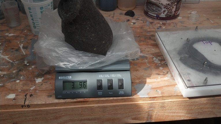

This is for Jim I know he likes his pantyhose you can run them but you really have to work at getting it over the ring.
