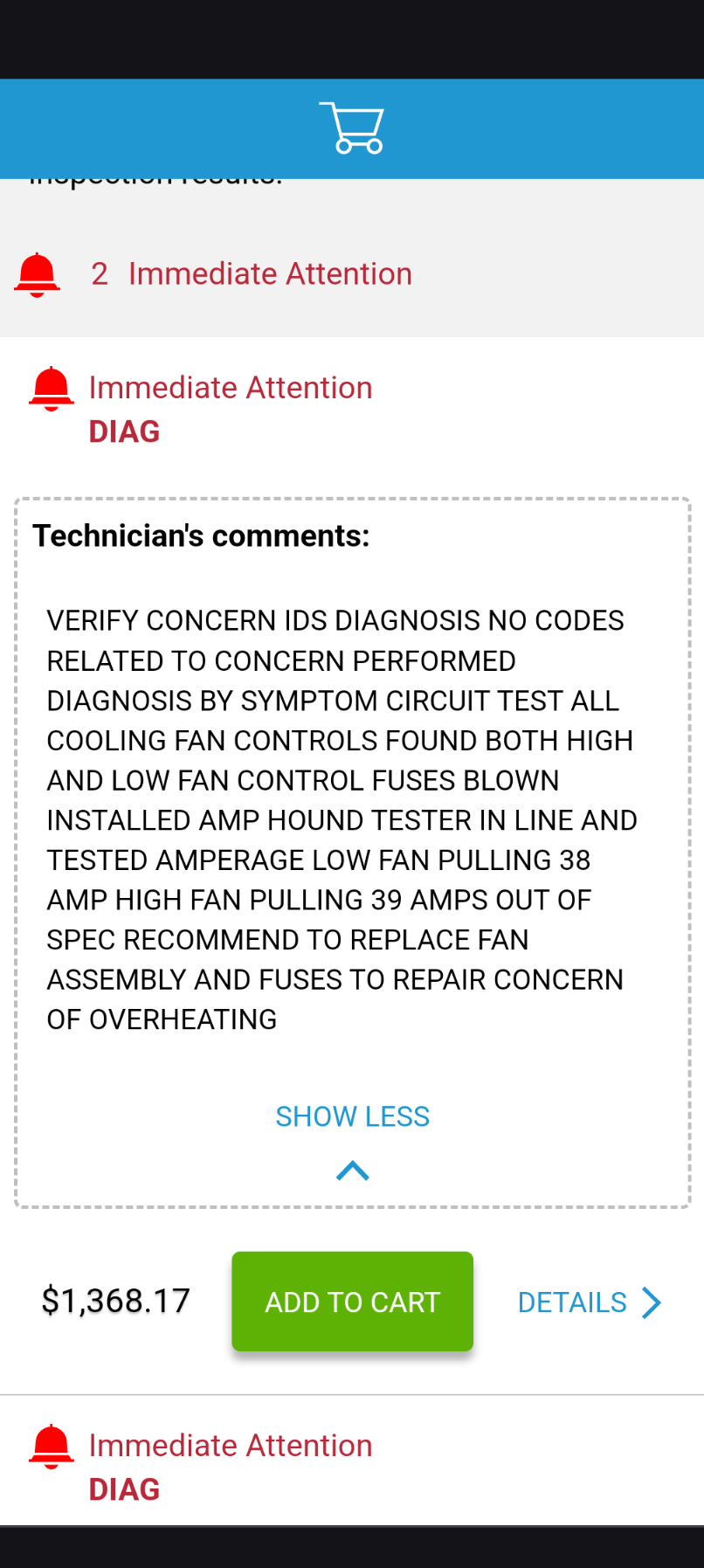

So the dealership is saying the fan doesn't work ...wouldn't it be overheating constantly if that were the case? Screenshot_20240725-145220.png
So th ...wouldn't it be overheating constantly if that were the case?
not necessarily. IDK exactly how it works on the transit but there are two fans. Not sure if both always run or if one comes on as "high". Both may also be low and high. High in either drawing the excessive amps and blowing fuses.
but once the fuses are blown it would seem like it would overheat all the time without constant air/coolant flow
again just a guess because i don't know anything about these
no
told you in post #25
I'll try it this way this time,
depending on load, conditions and movement, it can run cool enough to not the need the fan.
They don't run continuous like belt driven
