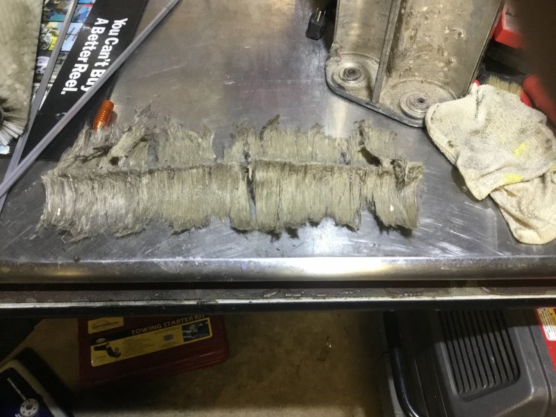

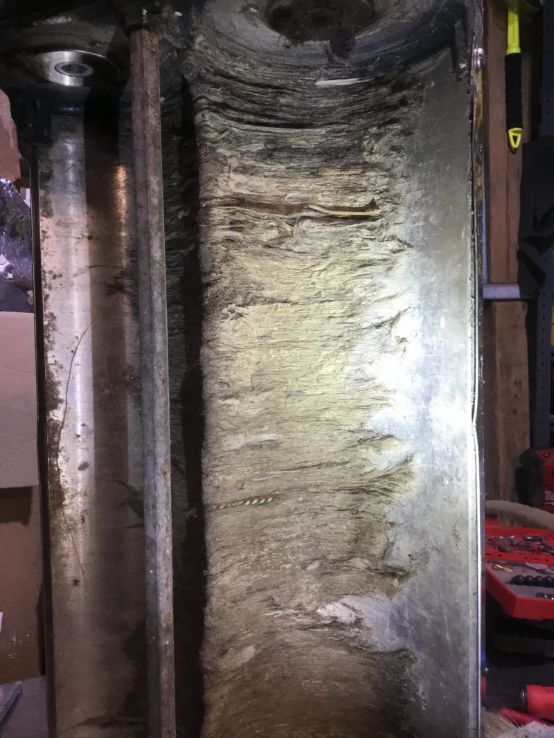

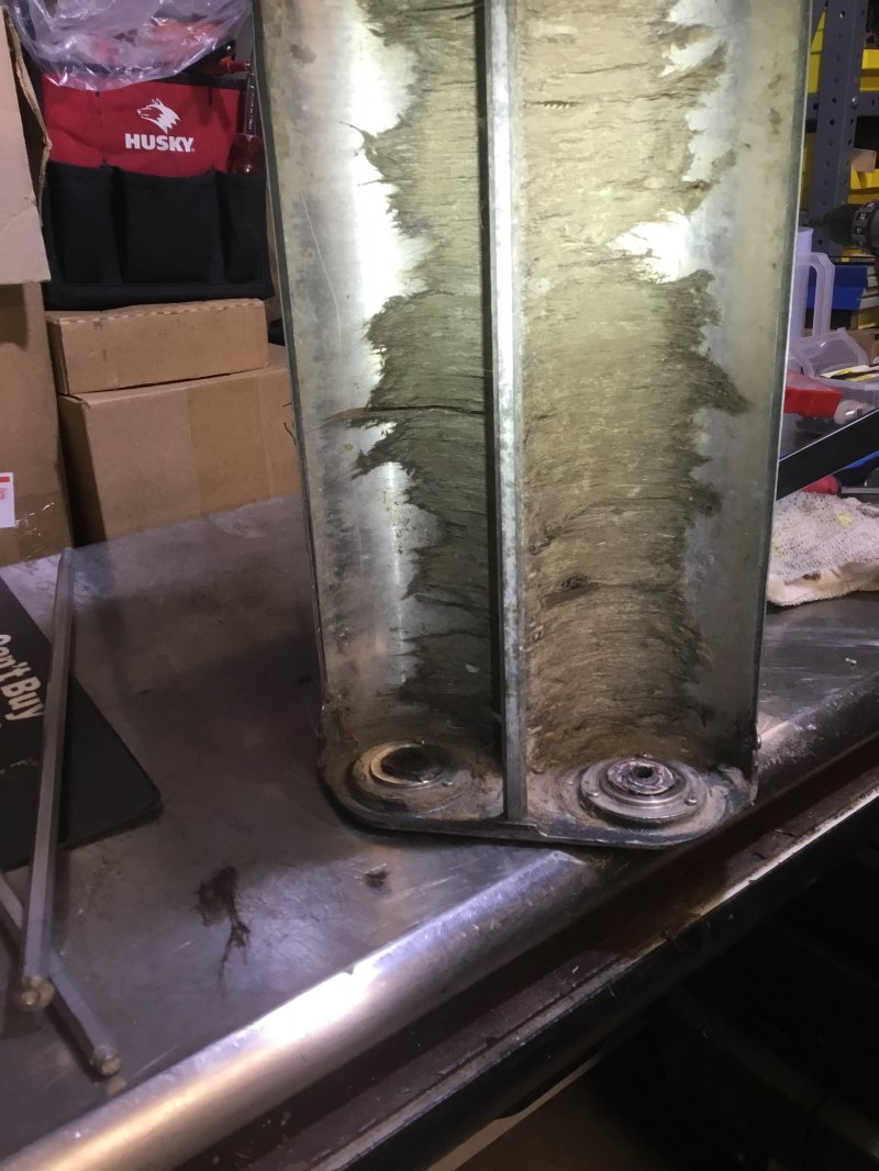

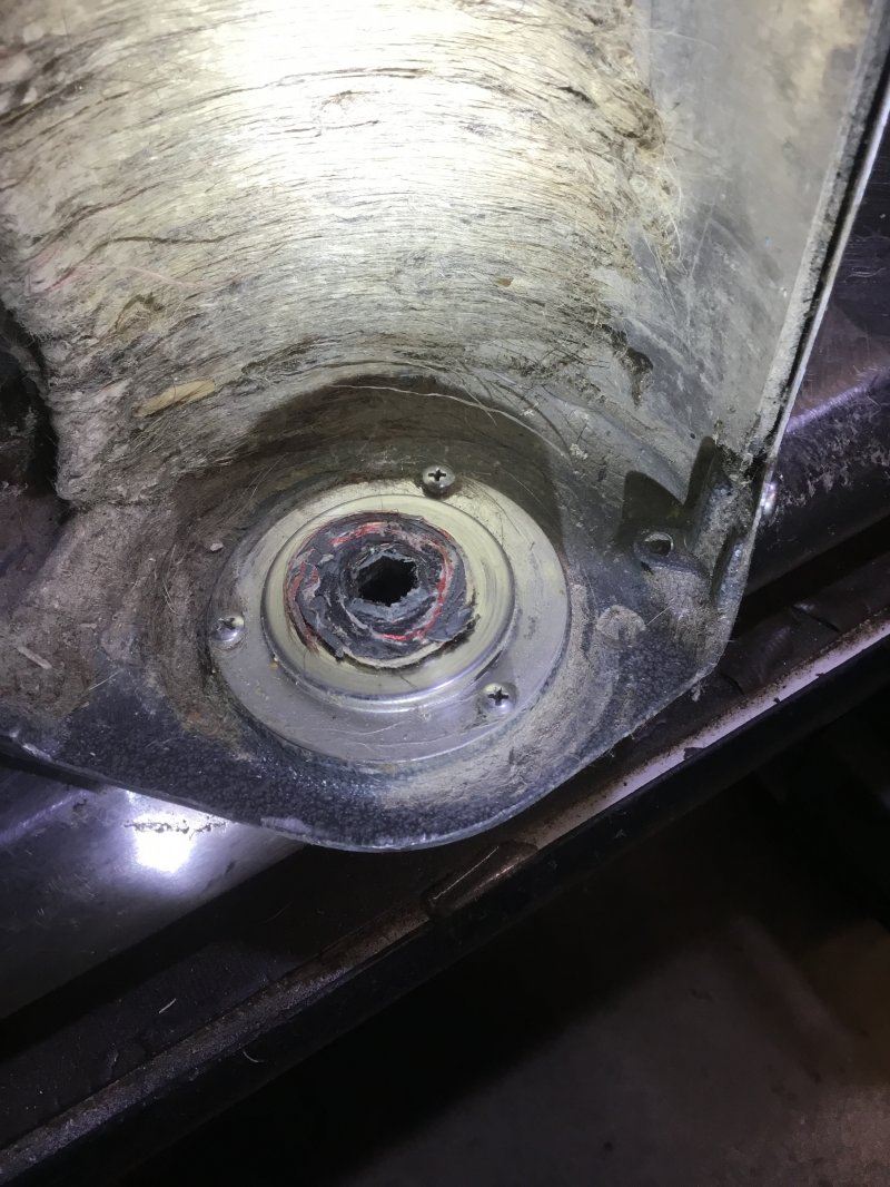

Strong industry sells the CRB that are made in China...strongdry sell what CCA distributed to them.. which is what I bought. Made in Austria. I see it lasting me for a long time to come..as you maintain it..
this is a cca unit just like a whittaker all metal old design is.
the breaker was popping because of the many pets that this machine had pulled out of the carpet and the user let dry in the machine as shown in the pics.
the thickest point in the sheath of hair was about half an inch and was there for a long time causing some pitting in the metal.
