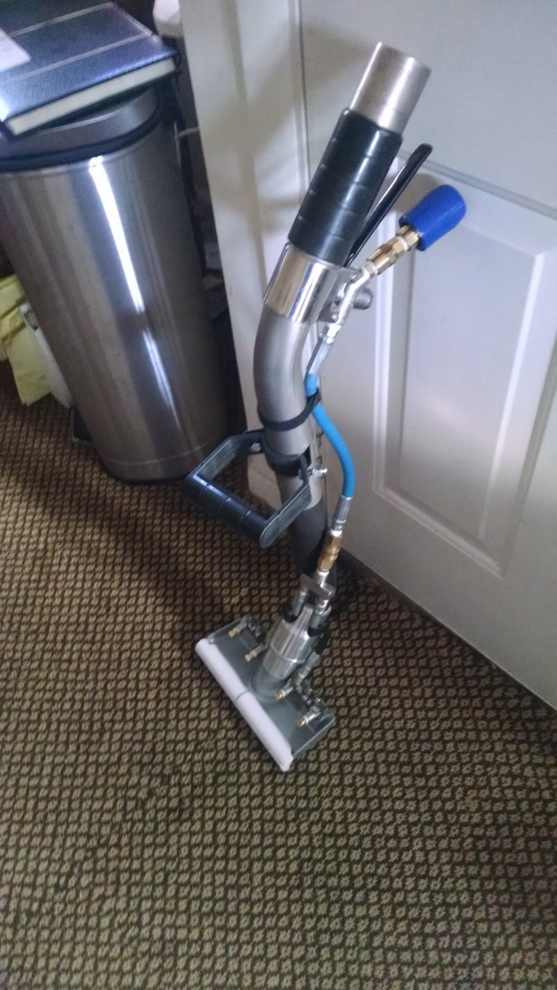

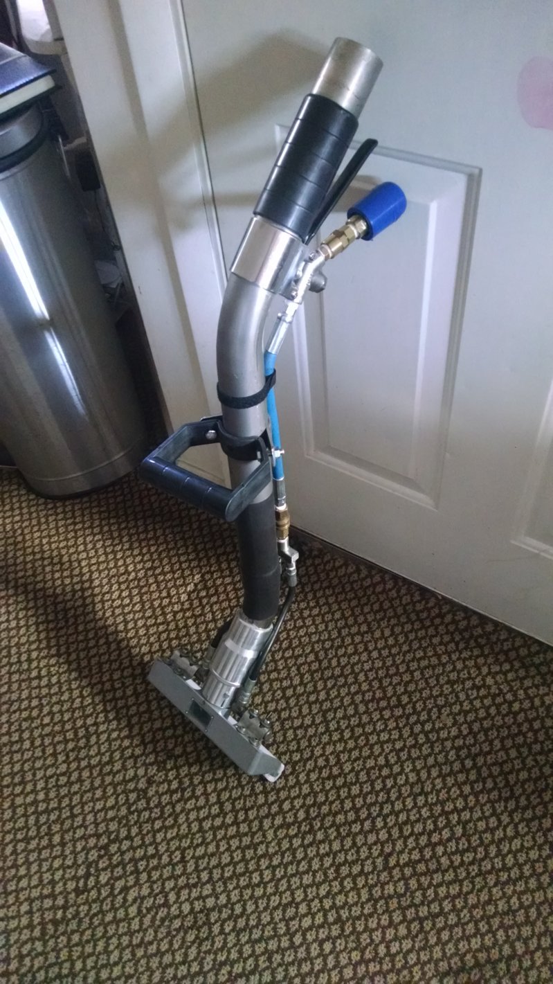

The new stair tool showed up for some testing. Tony got this to me to test it out. 10 inch aluminum head, swivel, 4 jets, s bend ti tube at 30 inches. I really like the 10 inch head and 4 jets. The swivel on a stair tool is nice but needs some tweeking. The length is comfortable. The glide needs some break in or to be modified. Seems to bite in hard(that could be my powerful butler-scott joke). Next week I will put it to the test for a better evaluation.

2 inch ti tube. Is it okay to post pics. I don't want to step on any toes again.
new stair tool

Nate you were right, too much suck. I like it with no handle but that will be a personal preference. I just need to machine down the glide and a little more testing. I will get ahold of tony when I think it is good with final recomendations. I will also have a different cleaner try it.

I talked with tony today and have some question for forum members.
1st-2 jets or 4 jets
2nd- 2 inch tube or 1 1/5- the tool seems heavy, I don't mind the weight because it is only in my hands a short time per day.
2 jets would cut down on some weight I agree with Steve, 2-inch barrel. Looks like there is un-necessary weight near the head. What's the point of the (3) cuff like fittings?

That thing MIGHT actually make cleaning stairs somewhat less crappy!:rockon:
I agree, stick with the 2" tube. If I had the option, I'd pick two jets. Very nice looking tool, It's gotta hurt my shoulder less than using the wand!:hopeless:
I'd ditch that but I don't care for swivels. Where is else is there weight? The hose manifold looks really funky, is there weight there that could be cut?

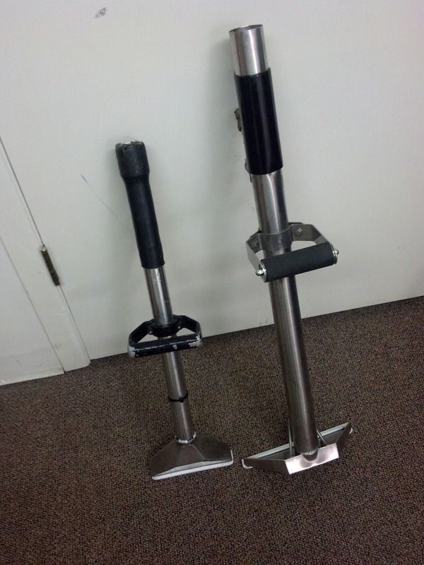

Still want to see PMF build a 2 inch tube swivel stair tool just like the 1 1/2 inch tube version.
No need to get all fancy with doo dads , sight glass etc.
Around the $200 price range.
Jimmy this is a pretty nice one from PMF. No swivel though.
2-inch barrel and 2-jet, lighter in weight than the PC tool.
