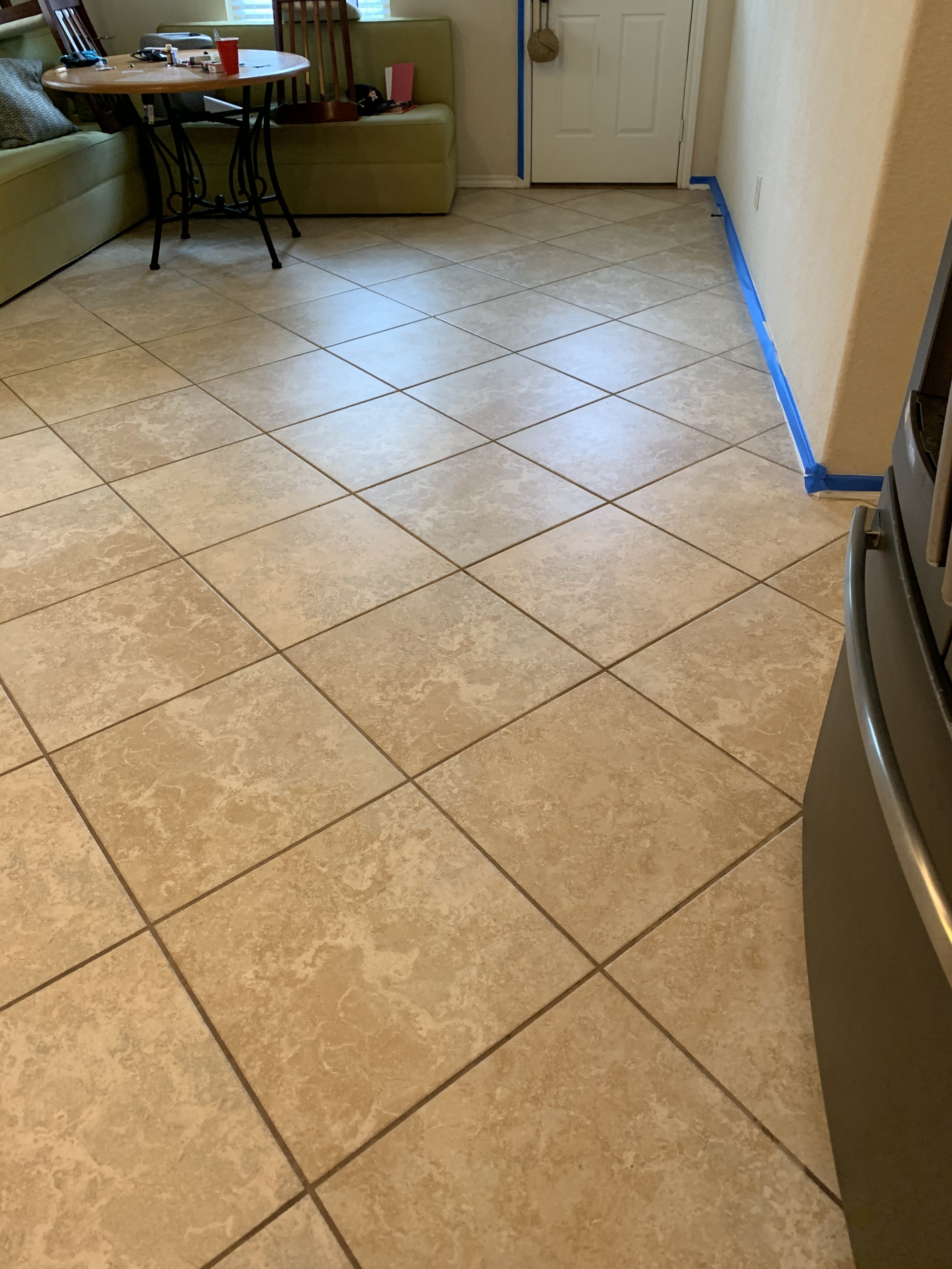

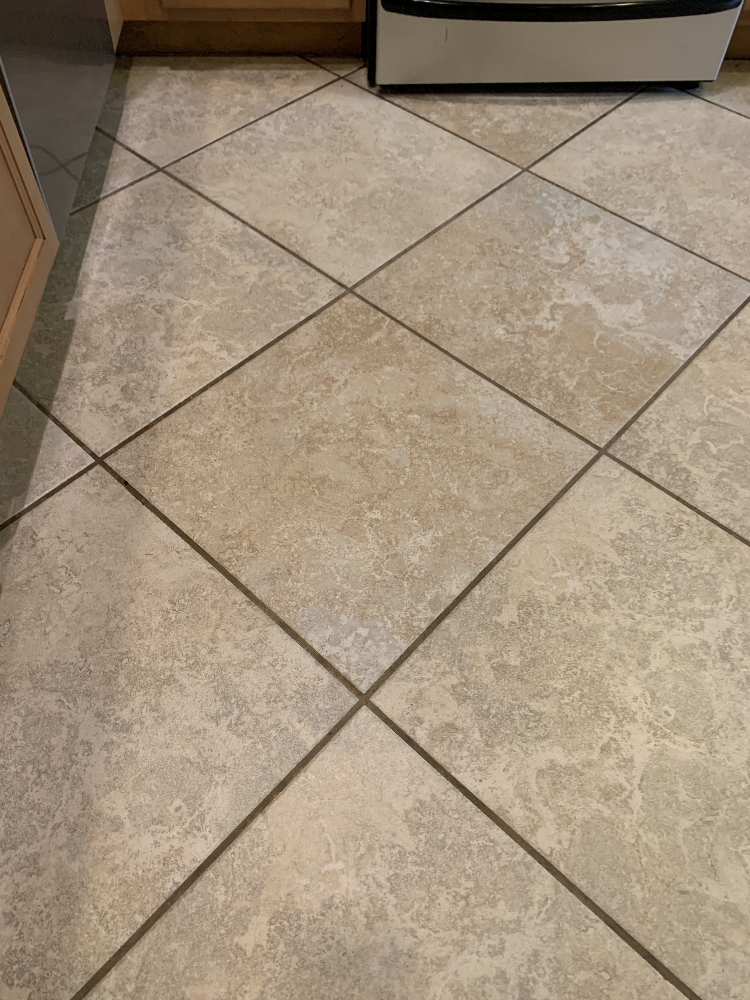

Did a tg job a week ago went back to clean her carpets and noticed the grout lines still looked dark. Grout lines were heavily soiled when I first cleaned them in her kitchen/breakfast room. I used Tsumani, crb and rinsed at 900psi. When cleaning was done it looked great, but after a week grout looked I didn’t even touch it? What might of happened??

60002B02-D068-4728-ABBC-02B58A332268.jpeg 3875E3E4-07B1-4CD2-85BA-6E1ECD6F5410.jpeg 95F68EA7-5B09-4D64-A604-43B860365B02.jpeg

First pic on top was the before pic middle and bottom pic were the after.

Pic was taken after ps was applied.

grout lines were reddish in color after cleaning...once grout lines dried after a week, noticed black spots in the grout. Blotchy dark areas on some of grout after drying.
117,112
What sealer did you use?
And what prespray?
117,112
Is it possible you removed some dye from the grout?
How about trying and Acid rinse....
Sealing with an Enhancer may fix it if acid doesn't
