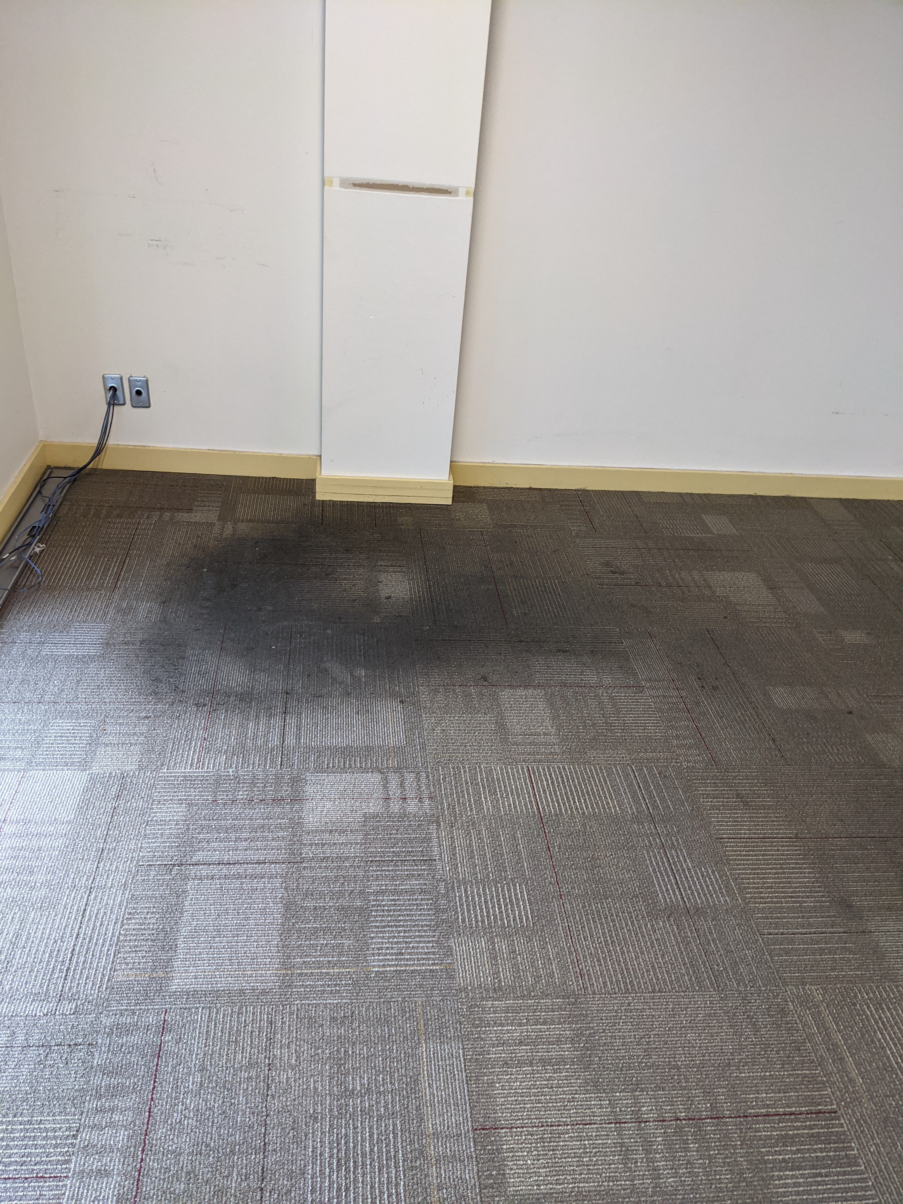

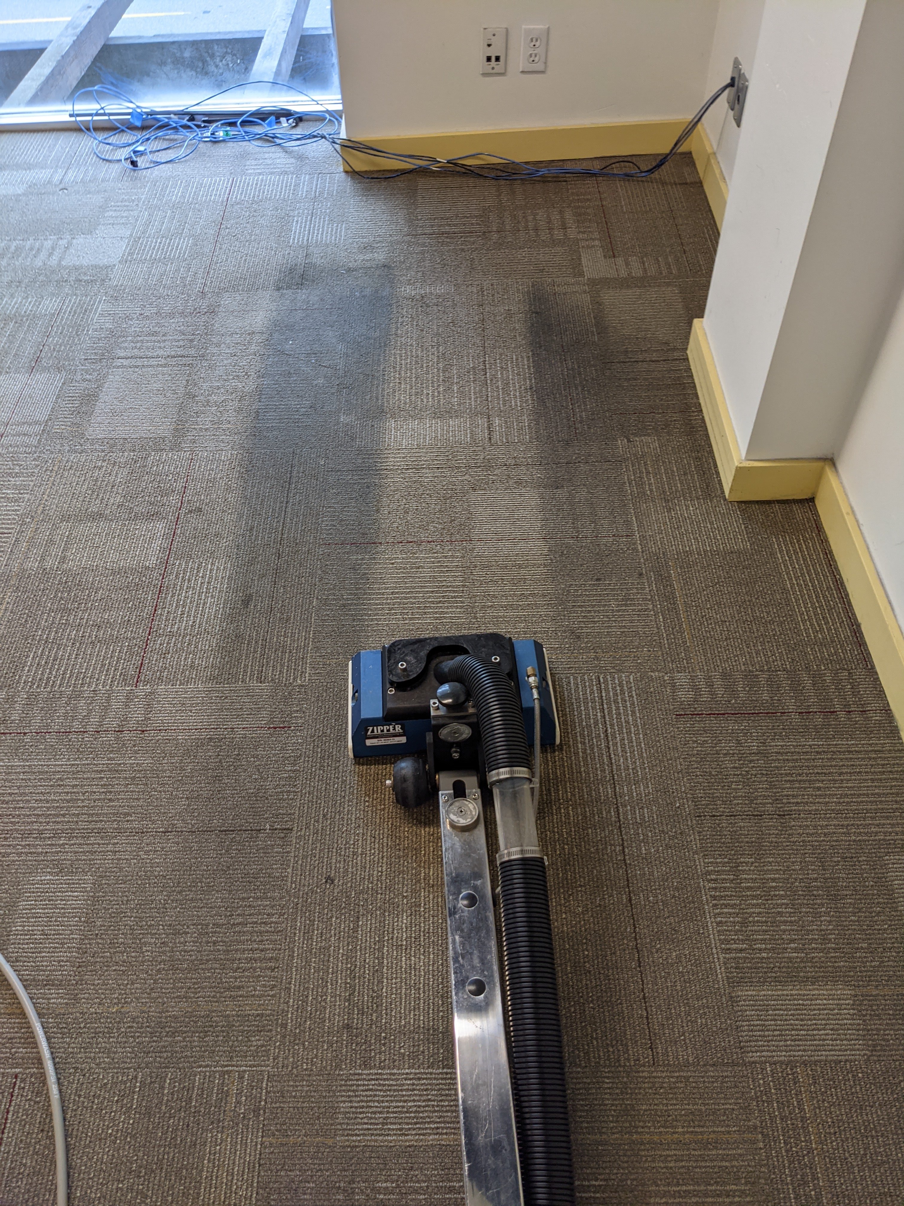

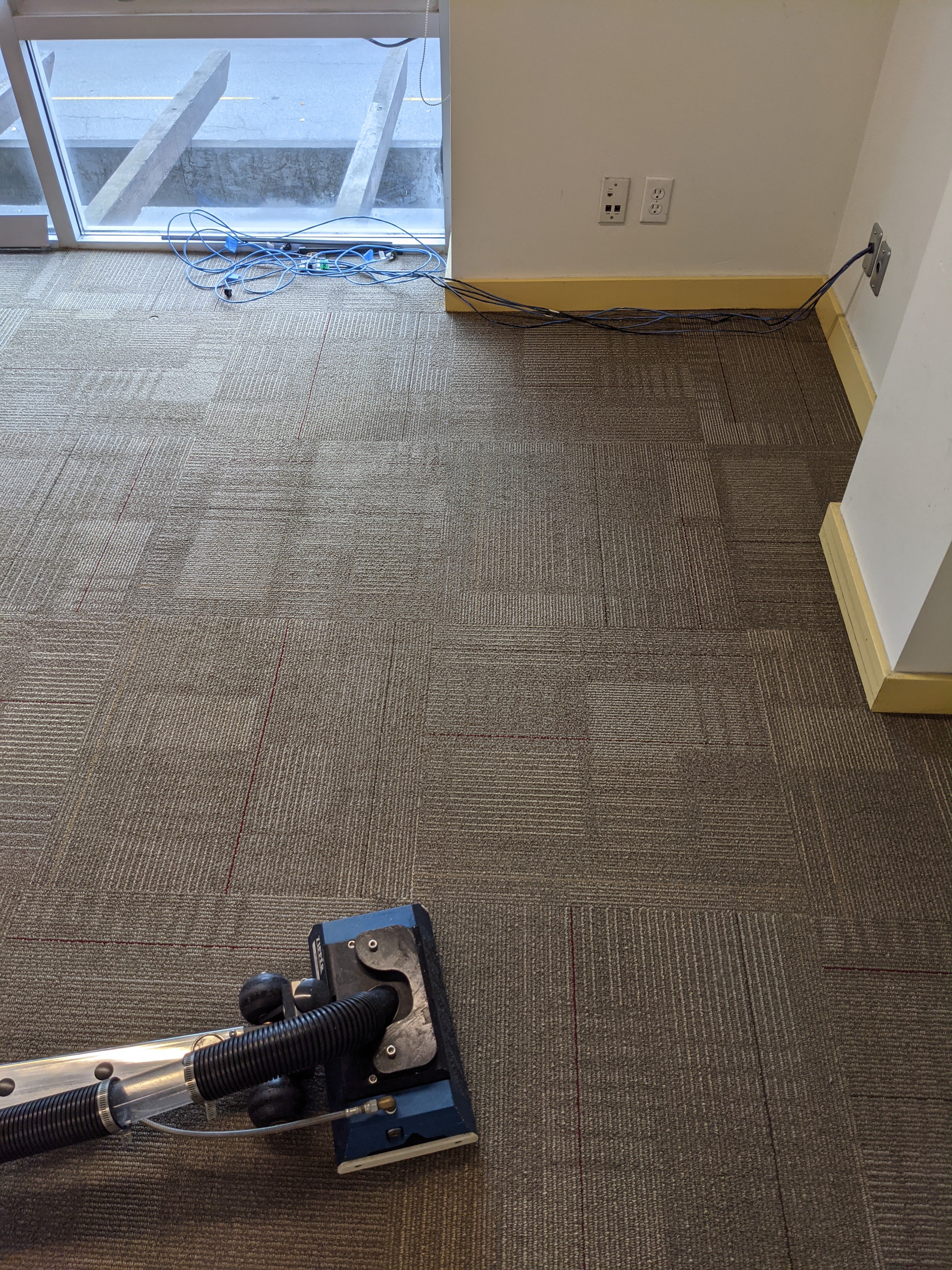

Just Zipping through this 1000 sqft office. Prevacuum, prespray with Saigers Code Red and nothing stands in our way.

I don’t find it any easier on my back
But it sure cleans better
Once you get the hang of working away from your hose, you can keep both hands on and push/pull evenly. Has to be at the right height to move without locking down yet extract efficiently. Usually adjust it so that you can just slip a business card under the rear glide
