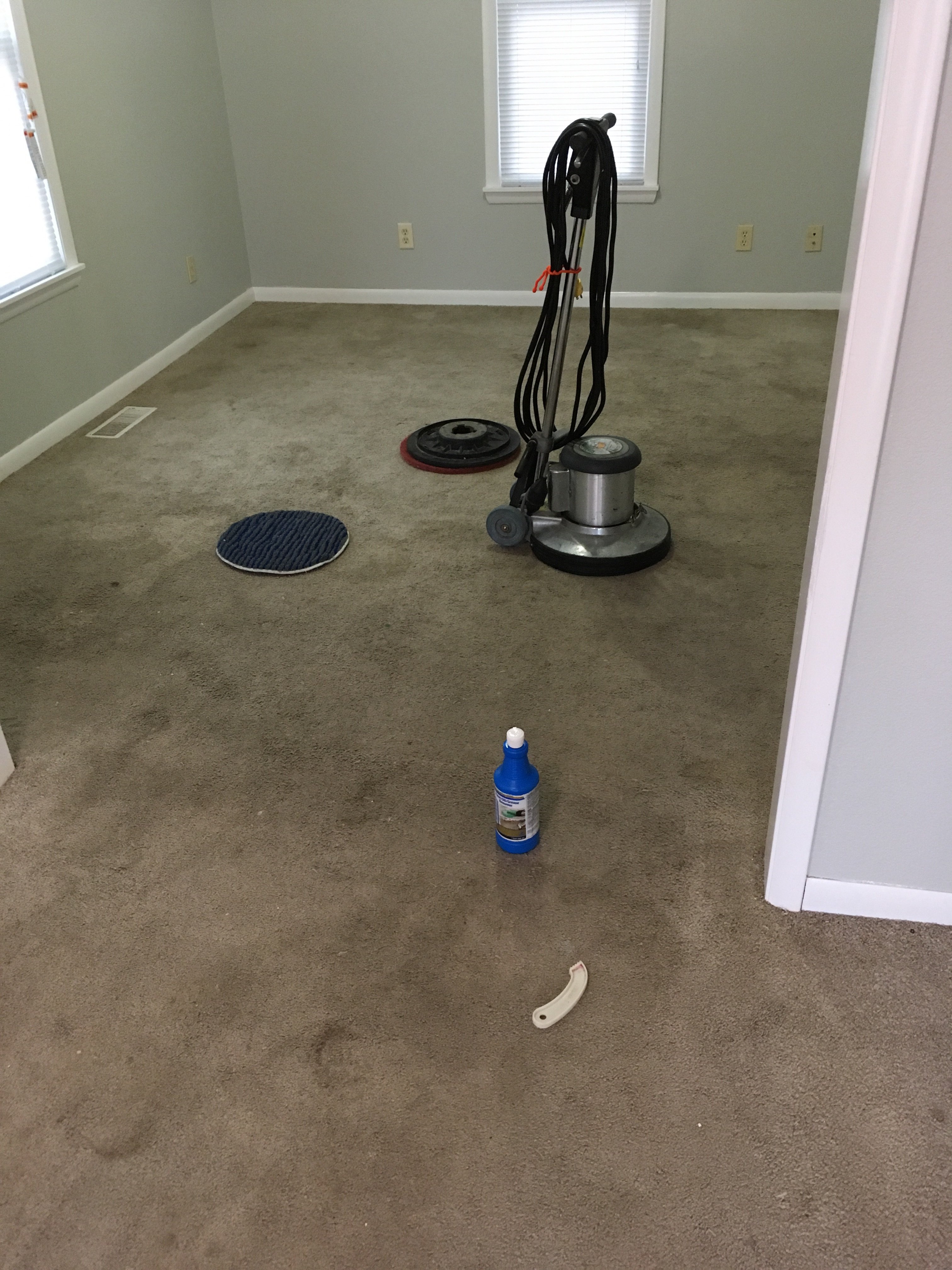

10 inch and 15 great combo. 175 janitor comment please...ONLY time I have ever had a comment about the 175 is if they have used it in the military. Someday I’ll go strictly to a CRB machine because they are light. But it’s a FACT a 175 machine or OP machine is the King of Resi Pre SCRU

I agree with Waldo
First thing I noticed when I bought my GLS was it was too light (even with a full tank) to scrub as well as a 175
Only difference is I don’t use a bonnet like Waldope

Marty look closely I also have a Red vct pad and that is not a bonnet It has very aggressive strips

The Golden Boy is right about 1 thing: The 10inch crb...you might as well have an Orek buffer. As for the 175: Go get a black and white brush on that thing. The blue and grey diaper is make for commercial carpet, not residential. And the red pad, eh.
Give me my 15" crb, and leave the tray off. The customer needs to see it. It's actually more of a pain in the ass to bring my crb in the house than it is to roll my 175 in. There's not much of a weight difference to make it matter
