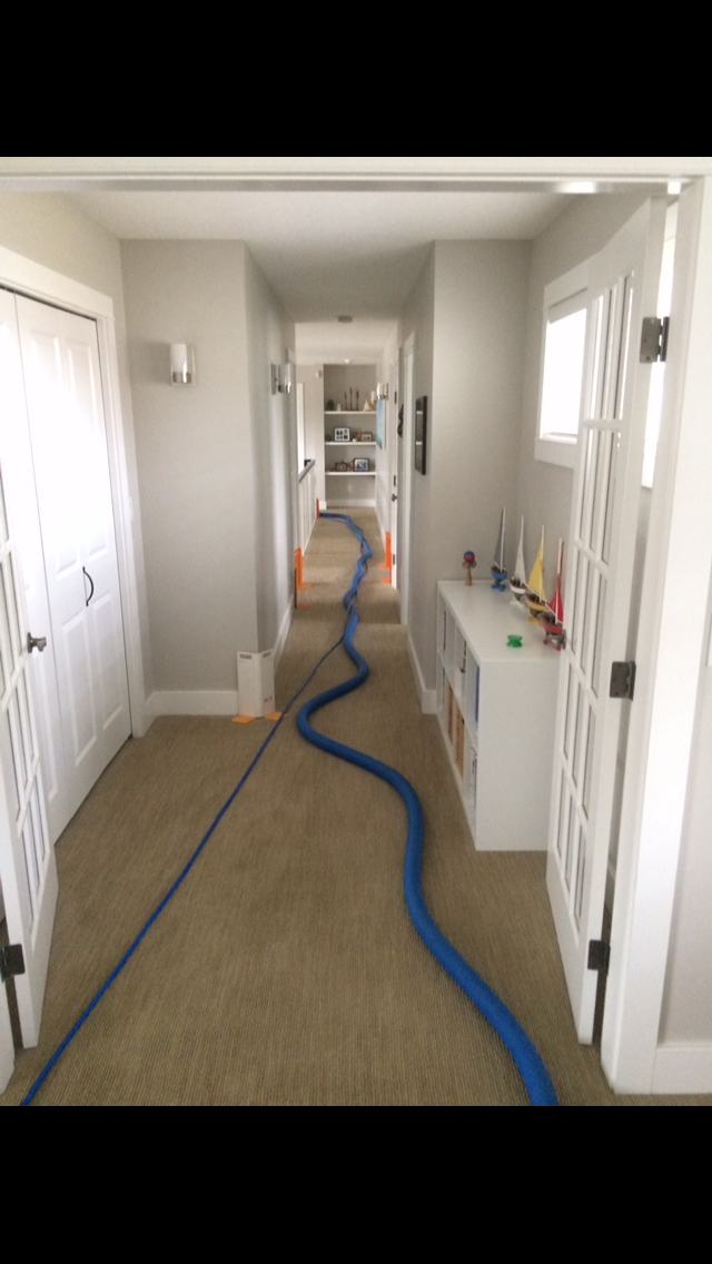

I will buy it again. I plan on hand rolling after I do a post cool down after each job... it has a different ‘feel’ to it, yes, it’s cooler to the touch, yes, you get higher temps ATW....
I don’t know about longevity yet, only time will tell...
A job today, I cleaned a bunch of uph, mid way through, I presprayed the hall and bedrooms.... NO TATTOOS....
This carpet welted the last time I cleaned it, and I didn’t do the uph first... 1FDD5C39-E2E0-40A1-A093-89B33B6EA786.png
This carpet welted the last time I cleaned it, and I didn’t do the uph first...View attachment 90010

The types of carpets that commonly welt are polyester and olefin.
