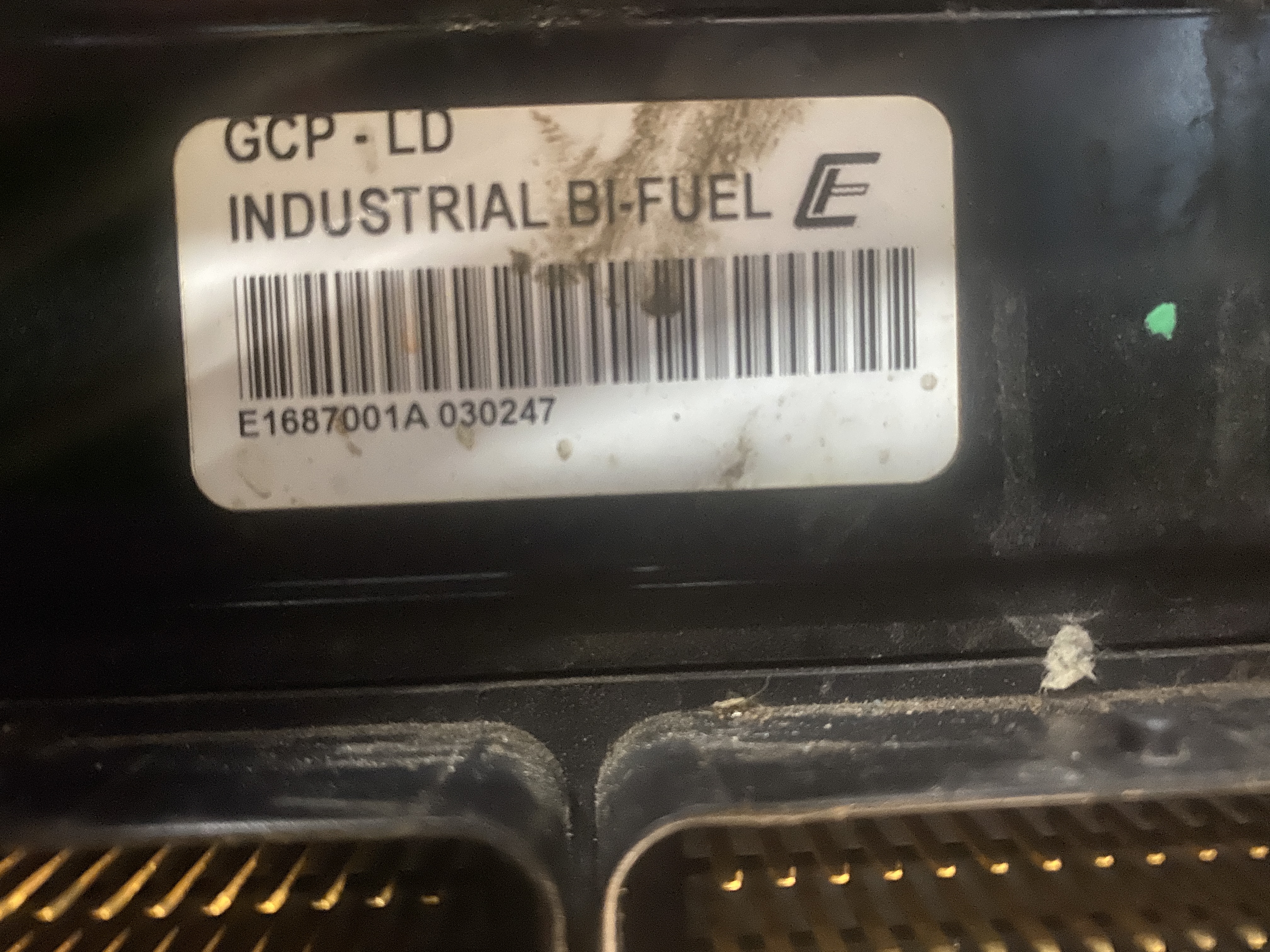

Need a replacement ecm. Here is the pictures f the one I have .
