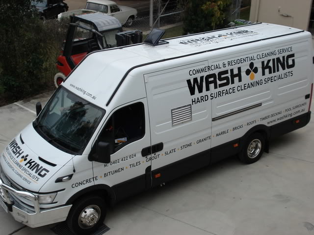

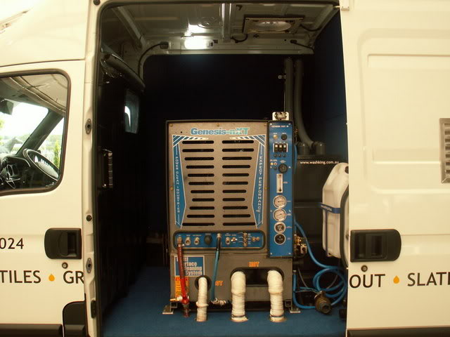

Your right Shawn, it is difficult, but not impossible. We have done it a few times with great success. In this rig below, we have done it. Since some of our competitors also read this board, I will not show the completed setup. But bear in mind that it is quite hot over here, and this is a big PowerClean Genesis which not only needs a lot of air to feed an engine of that size, but also generates a lot of radiant heat that also must be dealt with.
Again, there is a lot more to it than the photo's show, but a lot of people over here have seen this unit. Evan seen it at a trade show a few years ago when he was over, along with a lot of people in our industry over here. It is as quiet as a CDS or PTO setup. Shawn and Greenie are both correct though, it is NOT just the motor that needs attention.
But it can be done..... 8)

What's your problem?? That I choose to keep somethings intellectual info? Sorry you feel that way. I just showing Ron that it can be done. I am sure that most people that watch their mouth understand that you don't want to give your opposition all of your ideas that make your company unique. But then again, it is MY prerogative as to what to show, and what not to show.
Please feel free to scroll on past my future posts Brian if you don't like them. 8) Oh, and have a good weekend mate.

It looks like a nice cooling setup with the side & roof vent.
Have you taken any temperatures for warranty approval ?
Our engine manufacturers want oil temperatures & air temps running full RPM @ 100° F air temps for application approval.

Along with other things, yeah. We had to do an extensive amount of R & D to keep the engine and other component manufacturers happy here in Oz. It has been running fine for over 2 years now. There isn't a huge demand for this type of vehicle over here, but we like being asked to do unique fitouts and installs. And to keep a Genesis running cool over here in Australia whilst locked up in a van is a bit unique!
