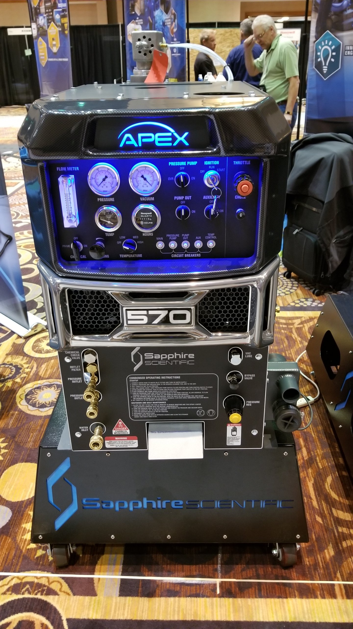

Do they still make that PC Apex with a kubota?
the Prochem Apex is on its way out. I heard that the Apex will be under the SS name now (see Sunbelt catalog) in a month or so. Not sure what motor or changes they made, but to me its a new machine and since Im looking to get a new one, Im not going to be a Guinea pig on a new model
116,285
Apex in a 570's new clothes..
