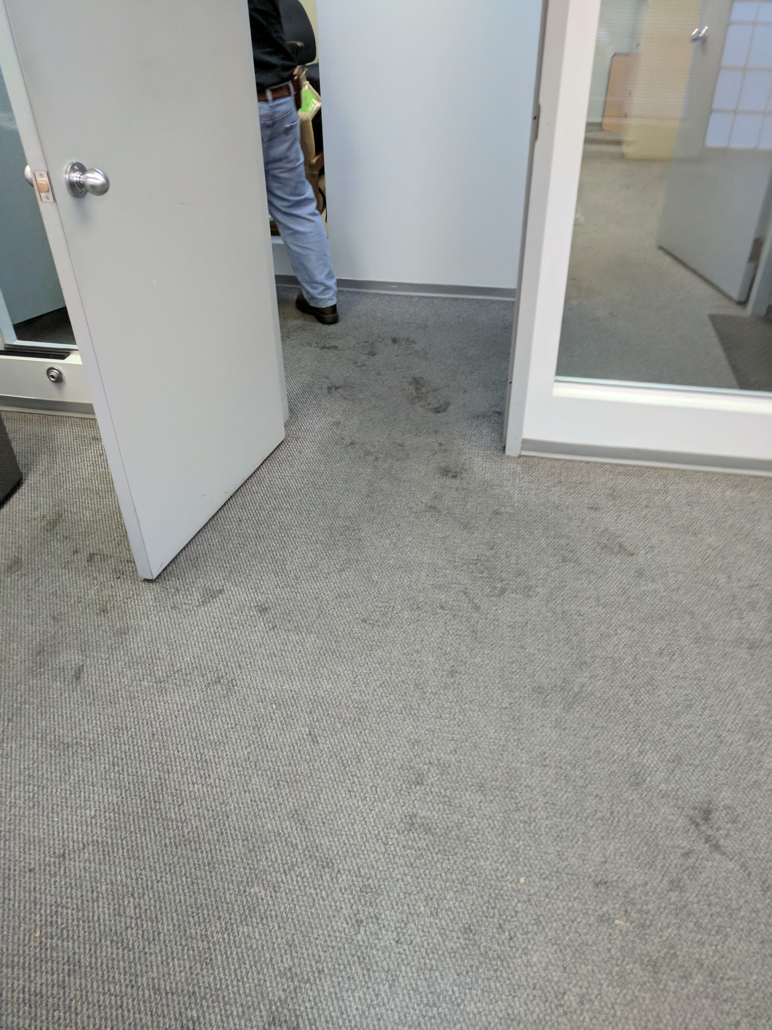

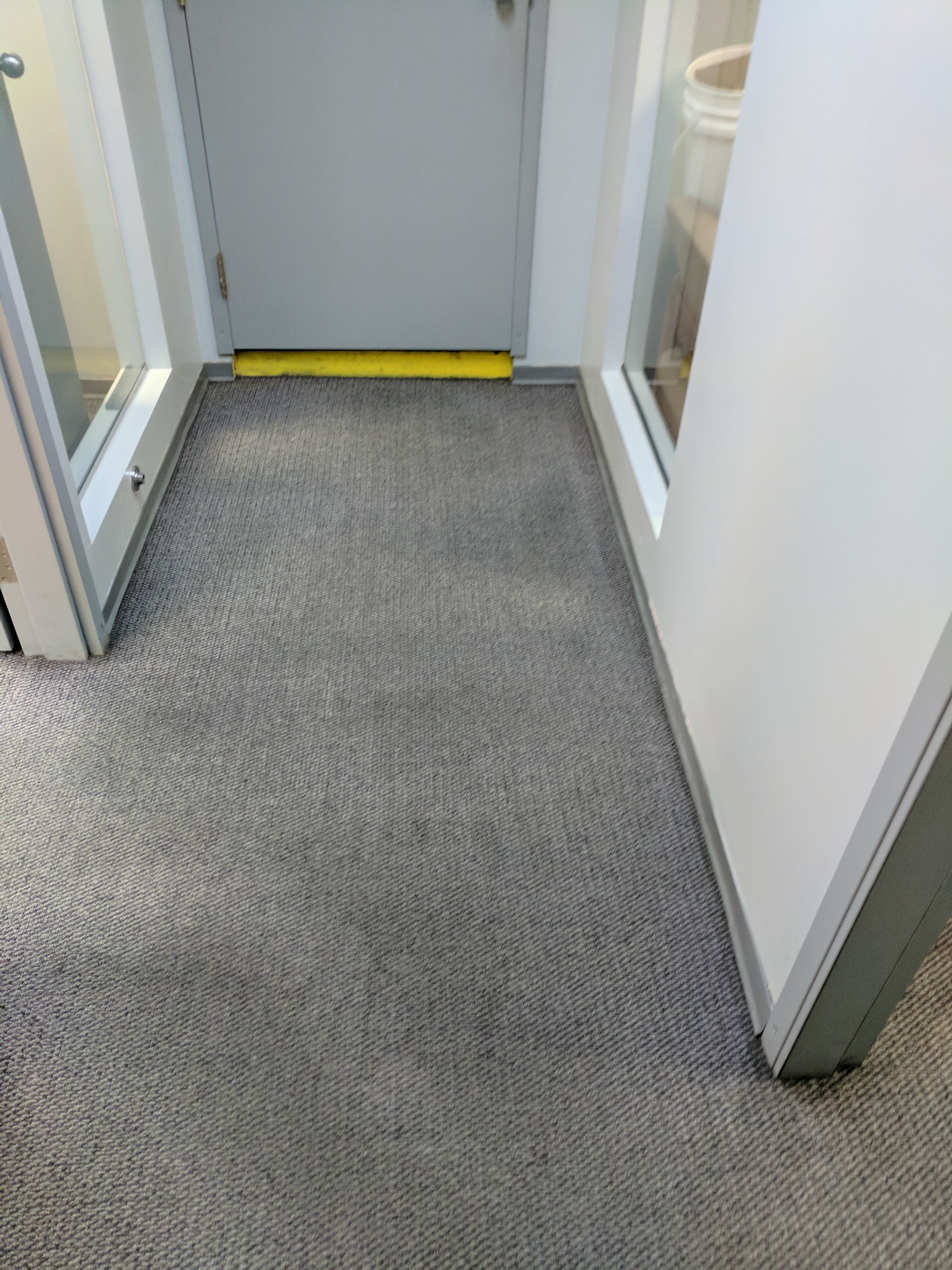

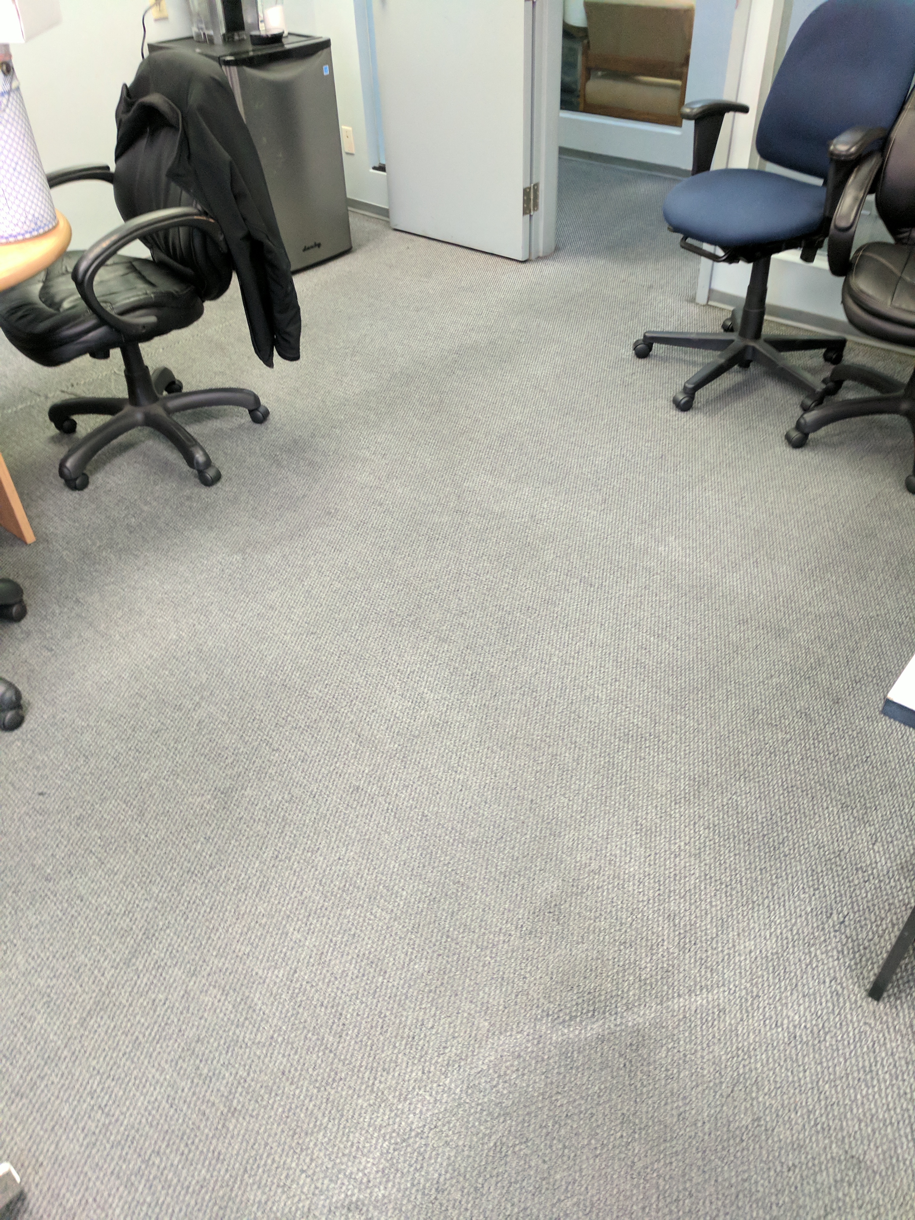

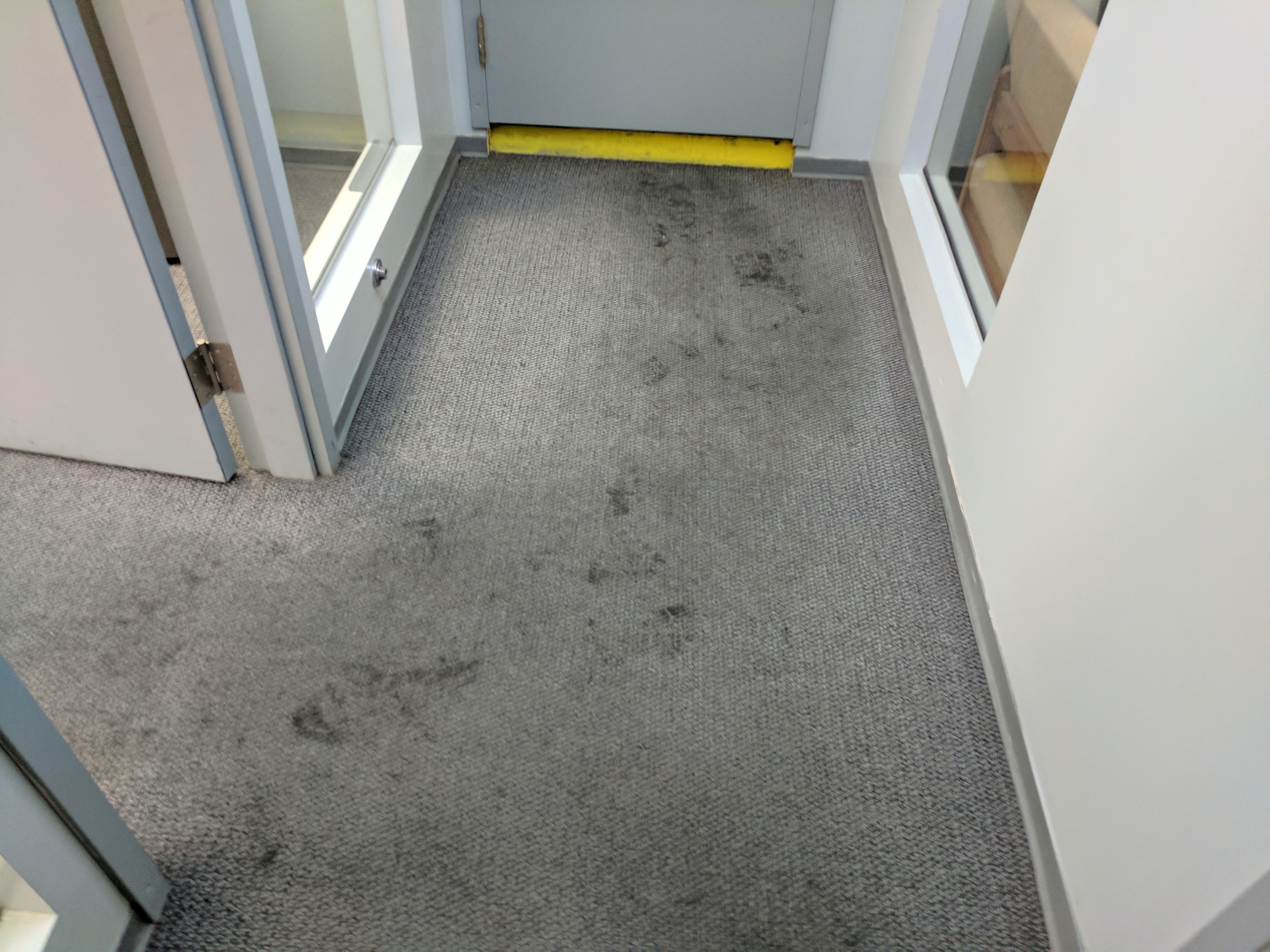

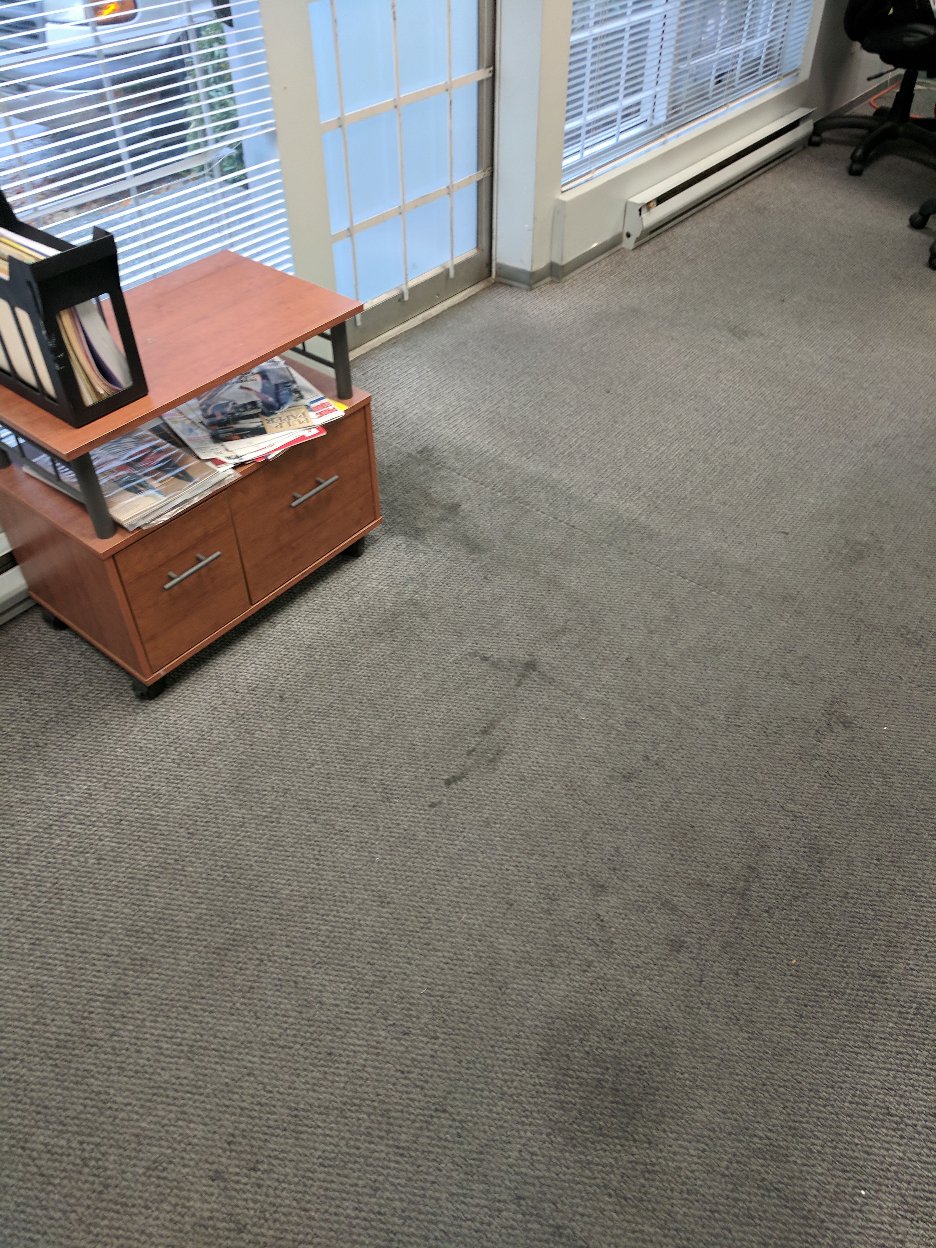

I'll be using a red pad on Wed. Nasty cgd with oily footprints all over. Using volatile solvent as a spotter, code Red prespray boosted with Prochem citrus pro, scrubbed with 175 and red pad, flushed with Procyon plus powder through the TM. I'll see if I can some pics this time.
Here are some pics of that job.

9,745
My dude, please take the pictures from the same angles... This is my OCD on pictures... Same fooking angle.......!

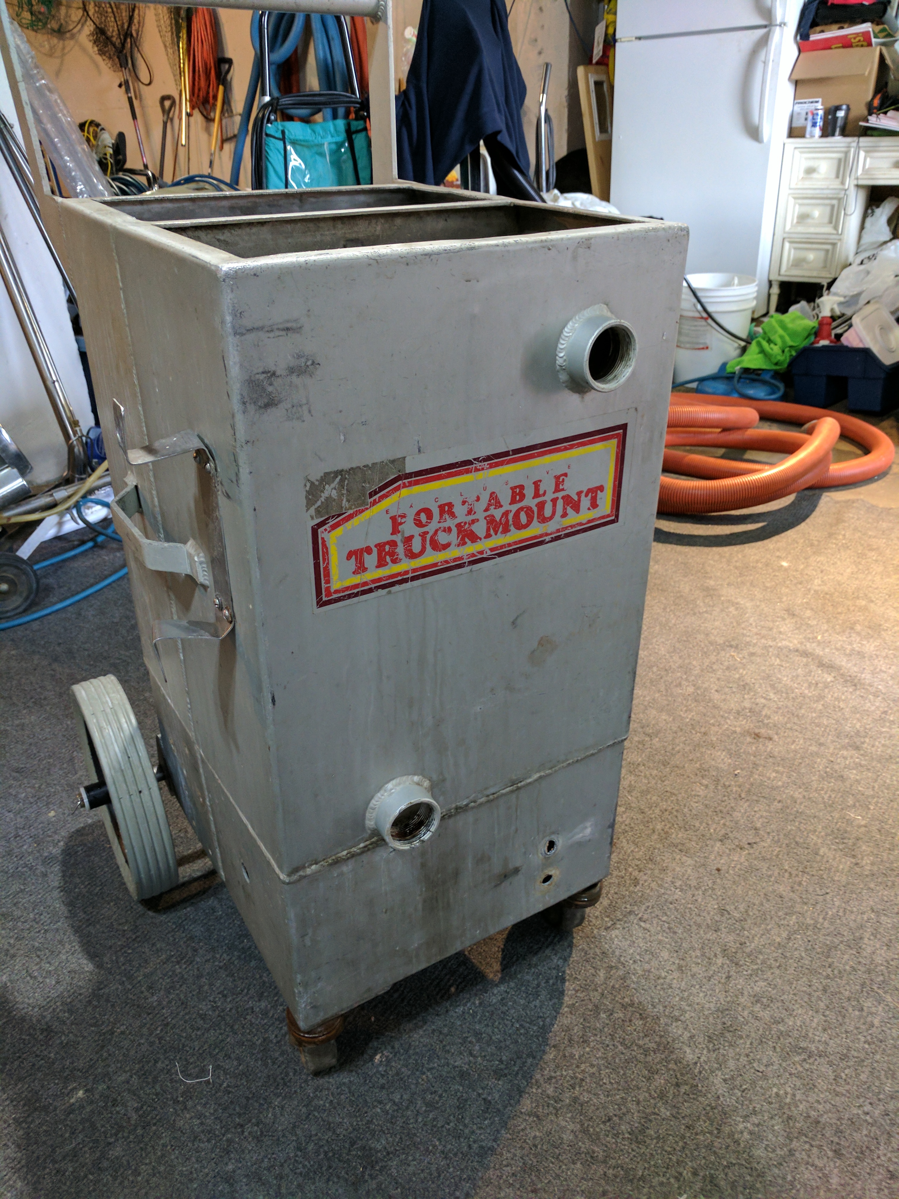

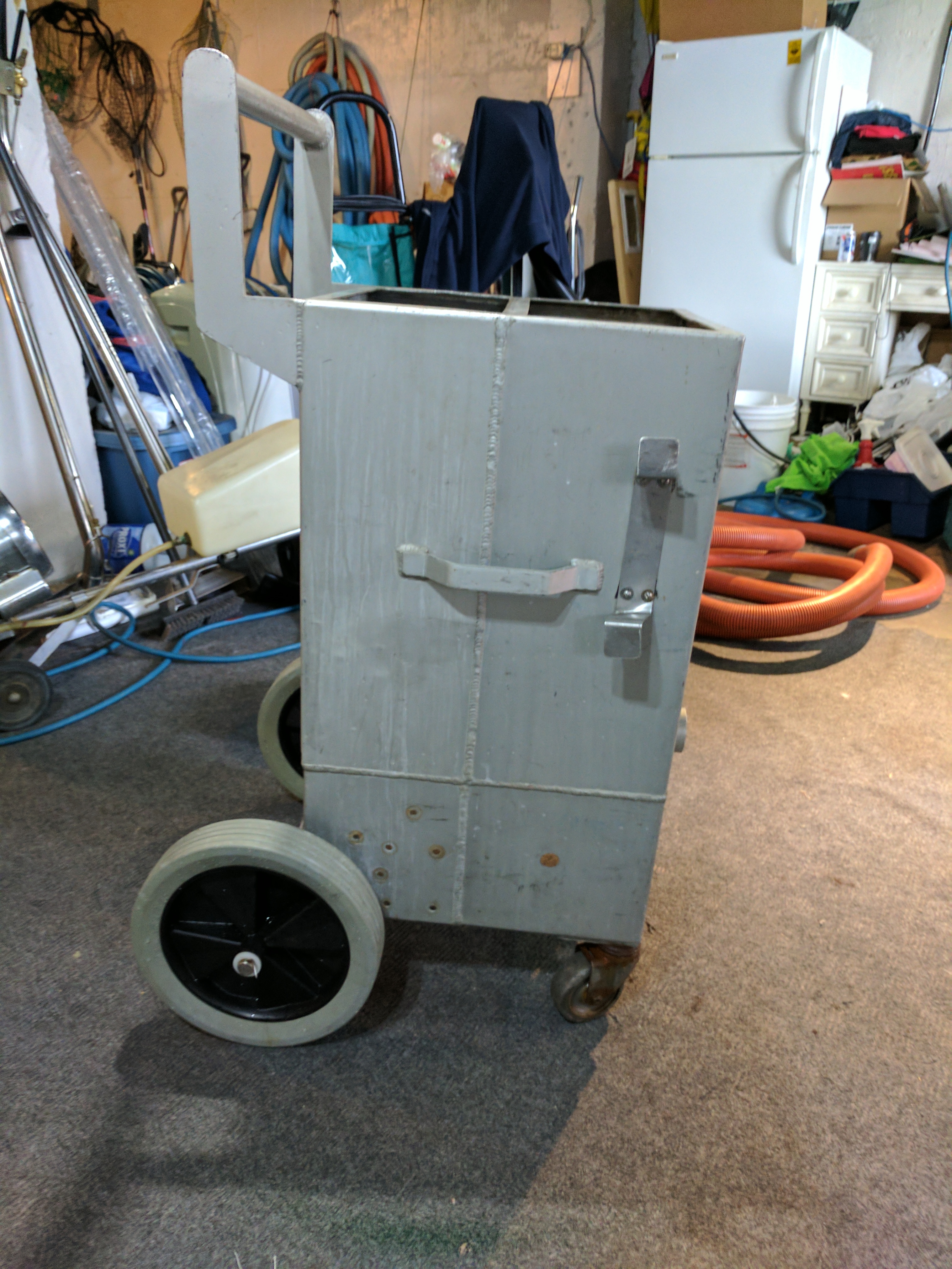

I am taking this one and having a cad design done. Hoping to build it this winter. I may try a pair of 8.4's in parallel through my manifold. Have to redesign the waste tank baffles to handle the air flow, otherwise we'll have a foaming problem. The one in the pic was made of 1/8 inch aluminum. Mine will be 3/8 marine aluminum.
9,745
I'm not down with that sissy machine... Go Chavez or go home... Give me the big Bertha... I want to capacity with wheelchair wheels like the Dirt Invader...
Reactions: BIG WOOD and Able 1
28,210
I can probably do that. Have to make the tanks a little slimmer and taller. As it is now the width is 24 inches. I need to devise a folding handle to give more leverage to go up stairs.
